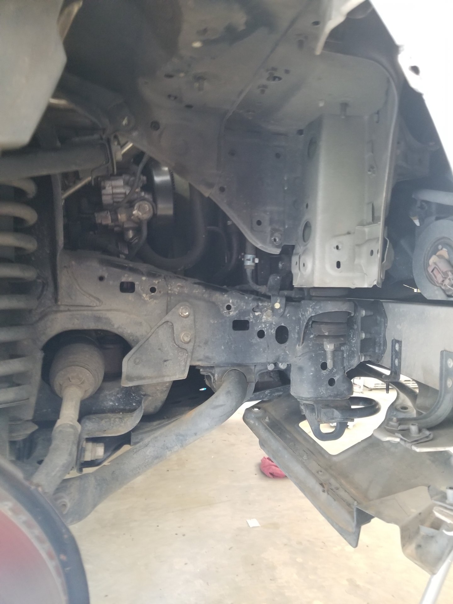

I didn’t remove or replace the pumps, but I don’t think it is hard - if you remove the passenger tire and the splash shield they are right there.

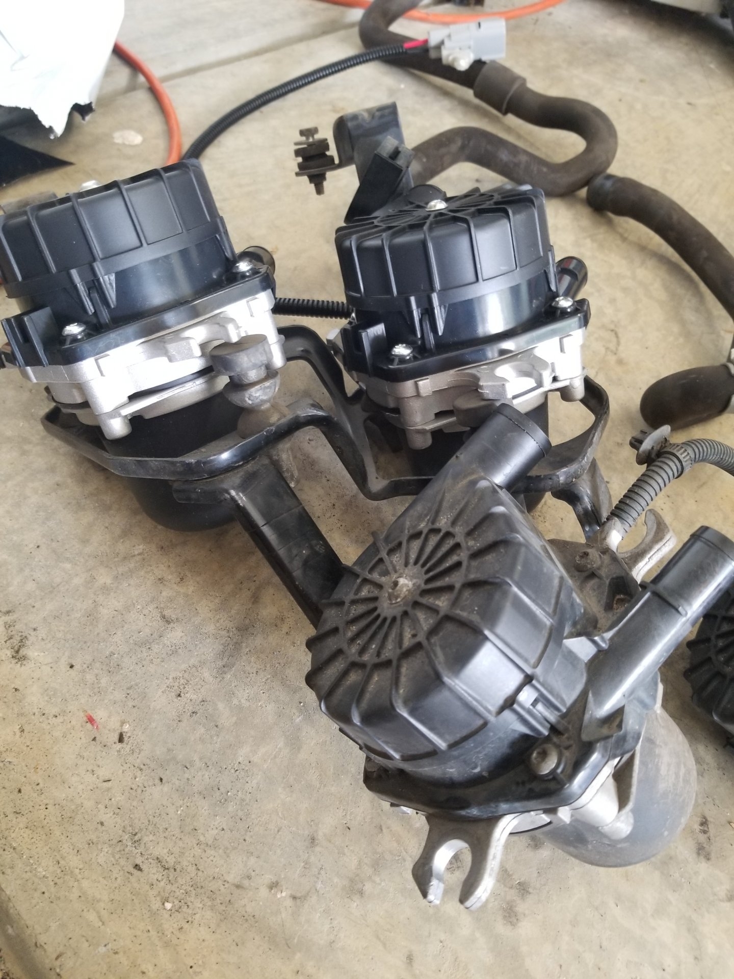

I just ordered 2 Tata (I think, based on the stamp in the picture) obviously Chinese aftermarket pumps off Ebay and will attempt this fix. I'm hopeful this may do the trick. Hate going non-OEM but for something like this which is, let's face it, superfluous emissions crap, I'm fine with cheap non-OEM replacements. 1/4 or less the price of the Hewitt kit and, in theory if my consistent P2447 (and only!) code is legit - it's the outside 'bank 2' pump that died. Maybe even same reason as Tundra - water ingestion. I'm even tempted to order the updated snorkel, but, need to see if it was truly water ingestion first.
Thinking I may also do a video and break it open to ascertain damage, and if I get crazy (and pump on bank 1 bench tests good) I *might* do a tear down of the new aftermarket pump for a side-by-side comparison! Why not? Well, feels like better plan to replace both while I'm in there. Not the hardest job in the world but not trivial like an oil change either.

I hear ya on Chinese made parts - I'm OEM or bust - except on this EPA mandated SAIS system. OEM pumps - last I checked - $369/each best price I could find.

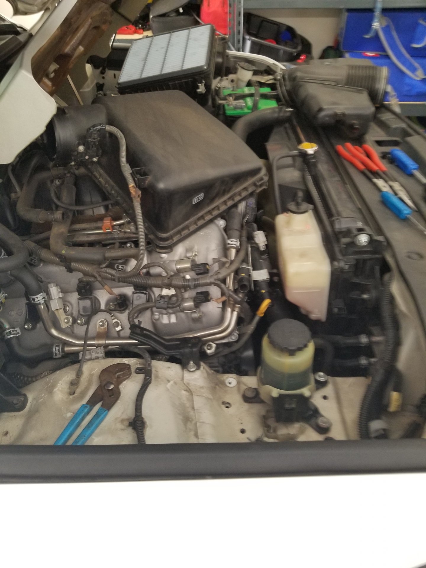

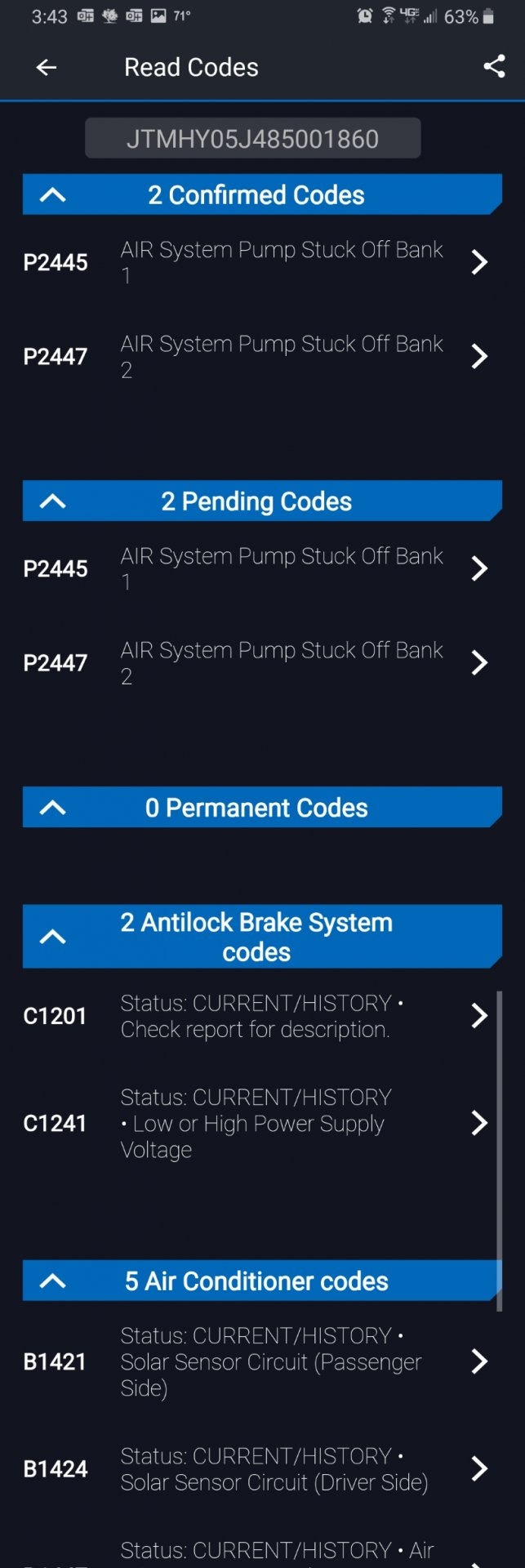

Ok pumps are in, codes gone, interestingly this morning I was in true limp mode, wouldn't go over 40 mph and took forever to get there.
Pulled codes and both pumps now dead, good thing I bought 2. I've not had a limp mode issue previously. Anyway. The codes include some ABS ones, cleared will see if they come back.
SAIS codes all gone, no more limp mode. I rate this job pretty easy :banana::banana: the biggest PIA is getting the dual wire and hose clamps off.

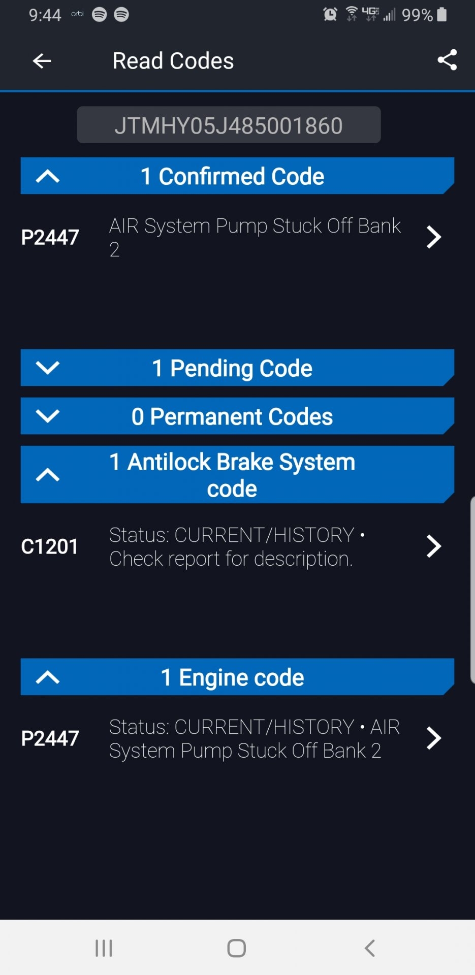

Well . . . sh1t. Pumps went in Saturday, fired her up, no codes, drove happily Sunday and Monday - this morning? P2447 back. Limp mode back (@Markuson this is a real mystery why these codes are now putting her in Limp Mode as of Saturday). Cleared codes so we could drive safely, back to the drawing board? Looks like it could be something upstream (or down?) of the pumps - maybe the Bank 2 valve? The TSB posted earlier in this thread is . . . complicated :grumpy:
I'm going to see if we repeat on cold start tomorrow morning and if so, looks like a bypass kit is in my future. Thought we had it licked w/ the new pumps, it was worth it I guess, $100 and 2.5 hrs experiment.

Did you check the fuse for the pumps? The Hewitt documentation says that the most common cause for P2445/7 is a failed pump. They seem to think that a failed pump regularly causes a blown fuse. They say if the fuse isn't blown, you should get a corresponding P0418 code along with the P2445/7, and that you will get that code once you reinstall the fuse if your pump is failed.
P2445 - Pump Stuck OFF Bank 1
This code is normally caused by the secondary air injection pump not being able to create proper air pressure because the pump impeller is damaged or the air pump motor has been damaged and/or blown the air pump fuse. If the air pump motor has been damaged, it is common to also see a P0418 code that indicates this. If the air pump fuse has blown, this code will display but you may not see a P0418 code until the fuse is replaced. If you only see the P2445 code during a cold start, the Hewitt-Tech bypass kit can clear it.
So maybe check the fuse and also, possibly double check that the pumps you installed both work. Sounds like you are back down to only one code.
Also, remember, if you clear codes, even if you repair nothing, it will take 2 full cold starts (7+ hours without running) before you truck will fail back into limp mode. So it's not strange that it took 2 days for it to fail.
This is great intel, thank you, duh I didn't even think to check fuses . . . <insert amateur hour shadetree mechanic jokes here> I've NEVER seen a P0418 - only P2445/7.
Well, unless I am totally wrong about which fuses they are - they checked out fine - continuity tests good. Per TIS it should be these 2 50 amp fuses:
You are correct, replaced pumps, cleared codes - 2 days go by - P2447 returns, which has me thinking valves.
