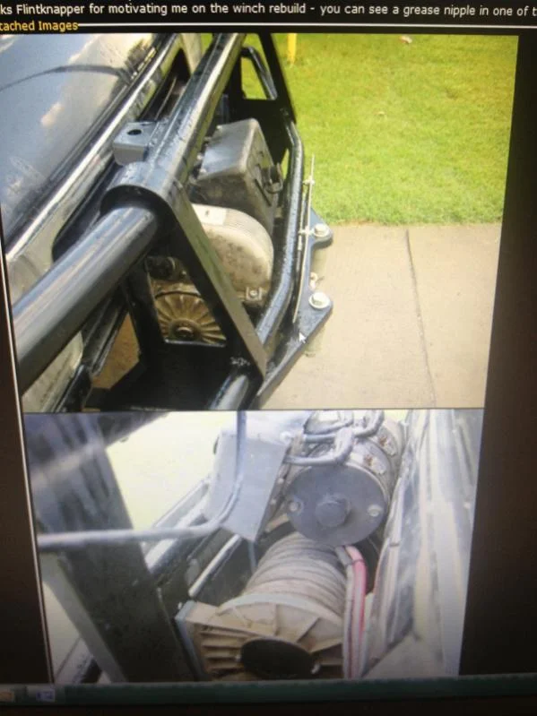

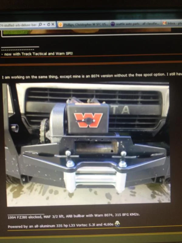

one issue might be fitting in your bumper. Does the 8274 fit the ARB front bumper?
Not without some "coaxing". It does fit the commercial version which I don't have. Others on here have trimmed to fit the 8274.
I didn't write down their screen names. Hope they don't mind the share.

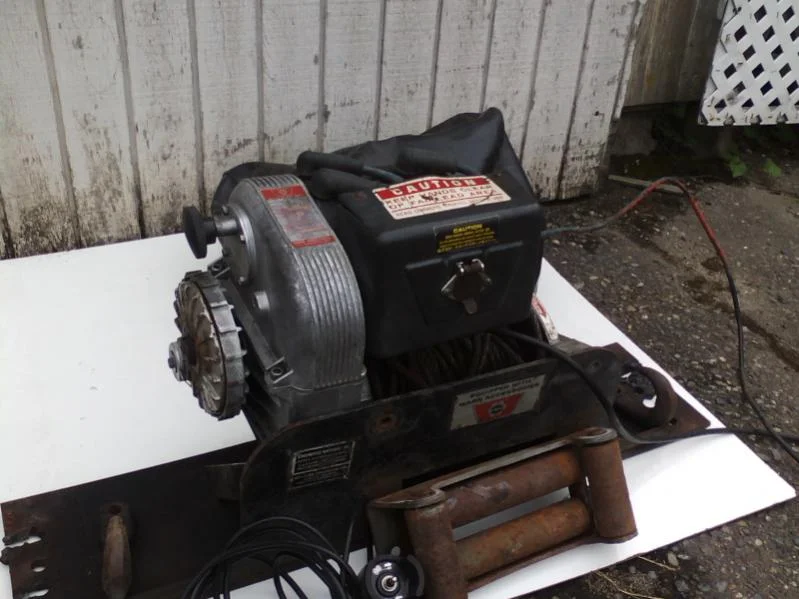

Well the Engo is on back order til September. So...I picked this up just now off of craigslist for $360.
Needs some TLC but it works. Had the seller hook it to a battery and it powers in and out.
Came with a nicer looking cable and hook separate.
Let the cleaning and cutting begin.
