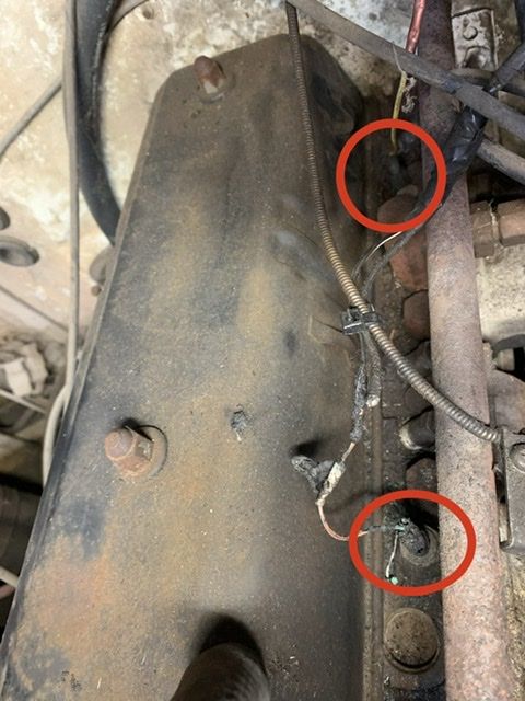

Engine wire help

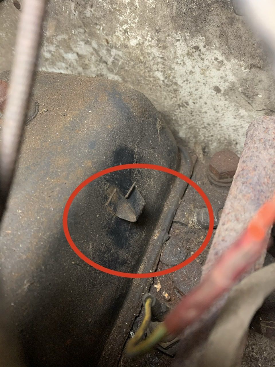

That zip tie to the choke cable looks silly tight. There is a clip on the 2F valve cover for wires.
I wouldn't mess with the Weber without confirming the performance with an exhaust O2 sensor and readout gauge. I'd go with the 38/38, not its synchronous 32/36 sibling. I wouldn't even full rebuild, just fix the plunger and its burnt boot, and solenoid.
Does it look like this?

I am almost certain that folding clip clamp is where the :
- choke Solonoid
- and both temp sensors wires are routed with a flame proof wire loom to protect them from manifold heat temps etc ...
Choke wire may also ride along with the choke and or hand throttle cables too I have seen
so not 💯 % sure in solenoid wire ?

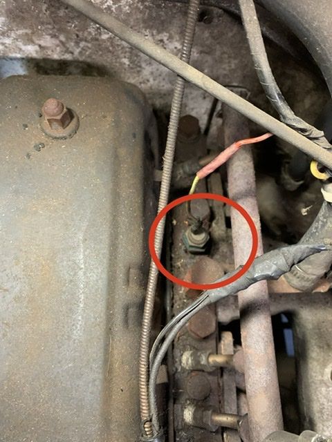

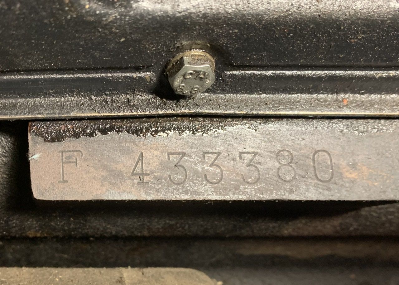

the “need assistance” bump. Can anyone help identify if my engine was upated to a 2F conversion? And can anyone help
Identify these two sensors in the back of the head?
There is a block serial number on the passenger side, kinda by the starter. Clean off the soil and it will say F or 2F. There is a "2F" engraving on the front, top, driver corner of my heads, almost buried under the valve cover gasket. Also, there are numbers on the top of the head, near the air rail holes; I don't know their code.
Both the F.5 and '75 emissions had a sensor for the computer. My 2F has a sensor for the combination meter on the dash, and emissions.
Not for sure, but the forum informed me that the one closest to the firewall is for the dash, and that is the one hooked up on my cluster, and it reads mostly at the first marking for temp on a warm motor. February '75.
It’s still an F motor. Per SORs chart looks like april-ish 1973 (the F was not revised to the F.5 until September 1973).
