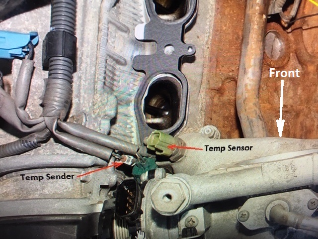

There is a a sender and sensor right together at the front left of the engine up near the intake. The green one is the sensor for the ECU and gray one is the sending unit to dash gauge. Check the wiring and connections on both. Particularly the gray one, it is a single wire and the connection is rather fragile.
