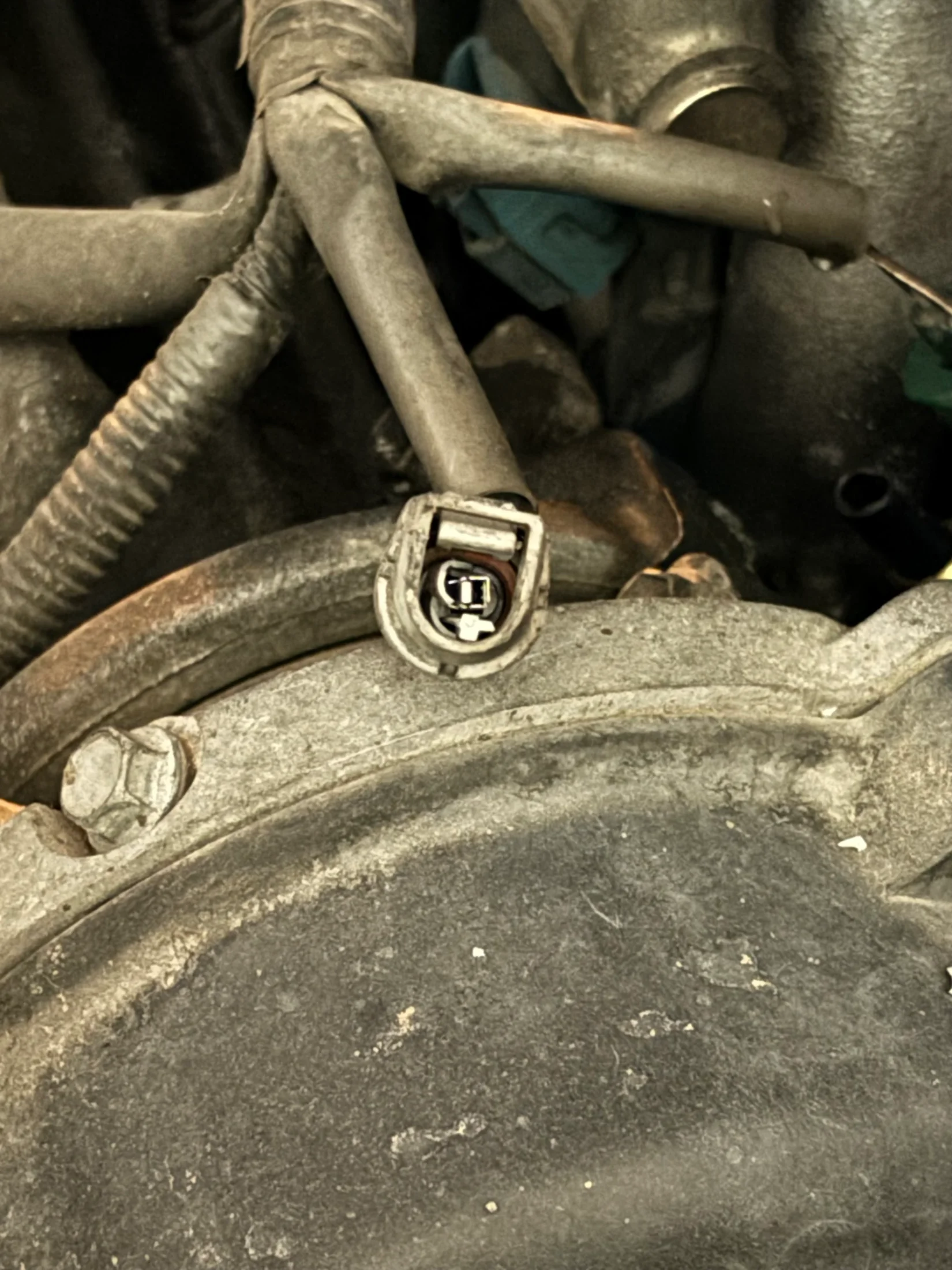

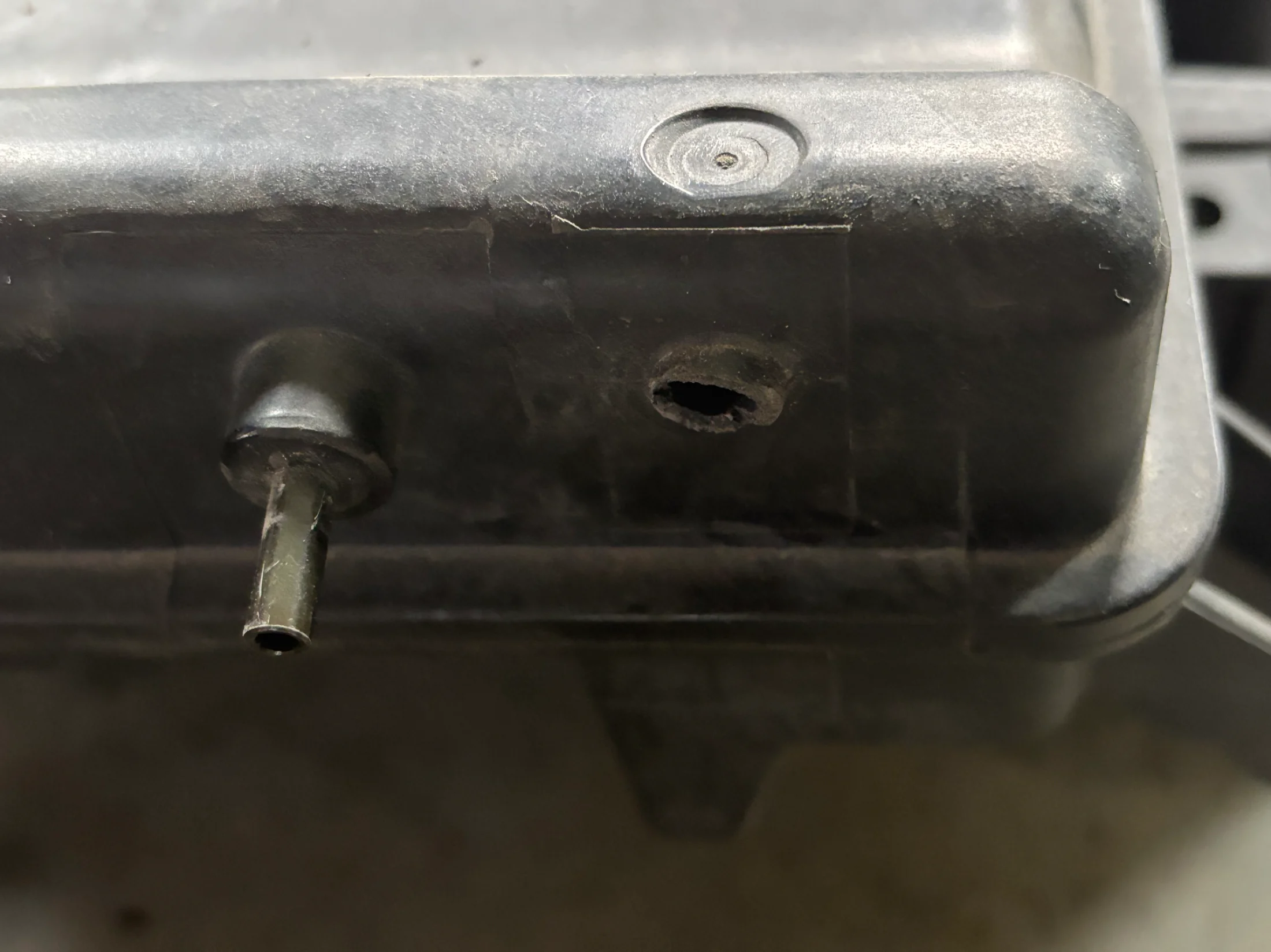

Update: I decided to go ahead and replace the gauge sending unit and in the process a vacuum fitting broke off the air muffler box and the connector to the sending unit also broke. Some days repairs go better than other days with these old cars.
I ordered the housing connector thanks to @FamilyCamper on mud. 9098011428. Crazy it came off fine but when I went to plug it in there was nothing there to grab the spline and line up. Wondering if it was already damaged and that was my problem. Sensor was even a different color.

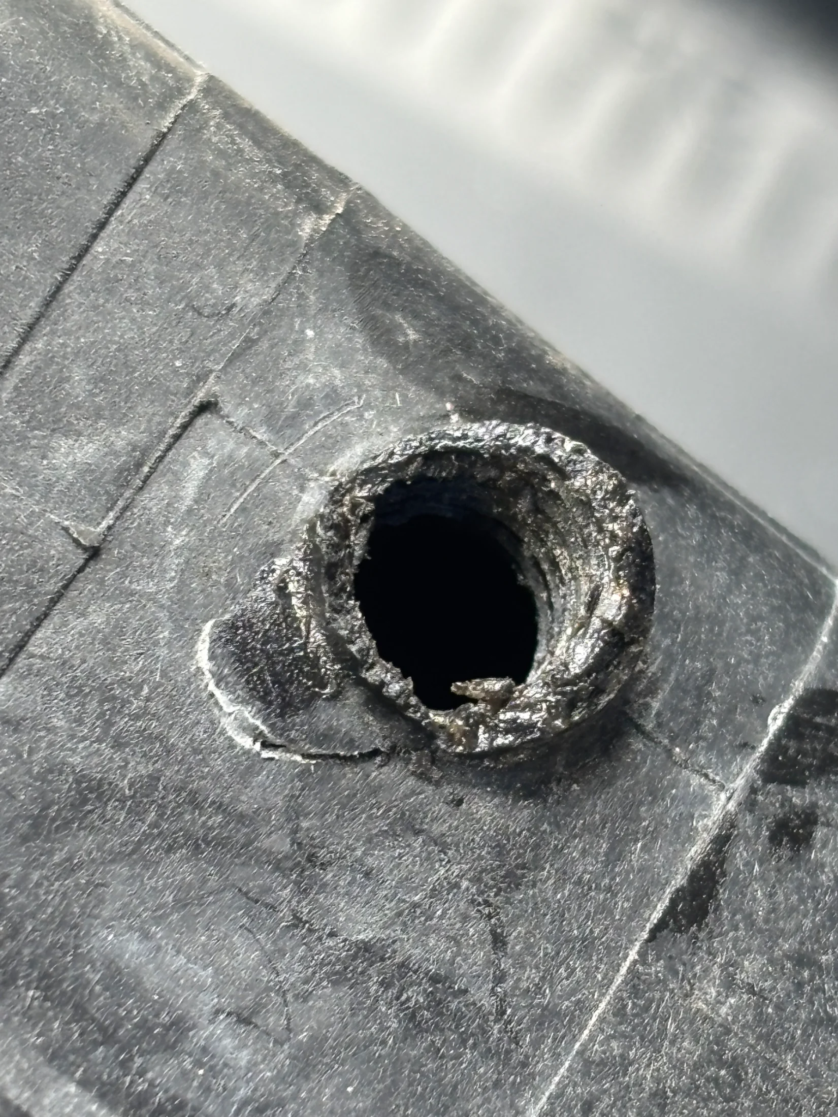

Trying to decide what to do with the broken vacuum port. I don't have any experience fixing something like this. Is there a type of epoxy to use or what would Mud recommend?
Would JB Weld be better?
I would attempt a JB weld fix and then depending on how that goes see about sourcing another unit altogether if you can find a good price on one.

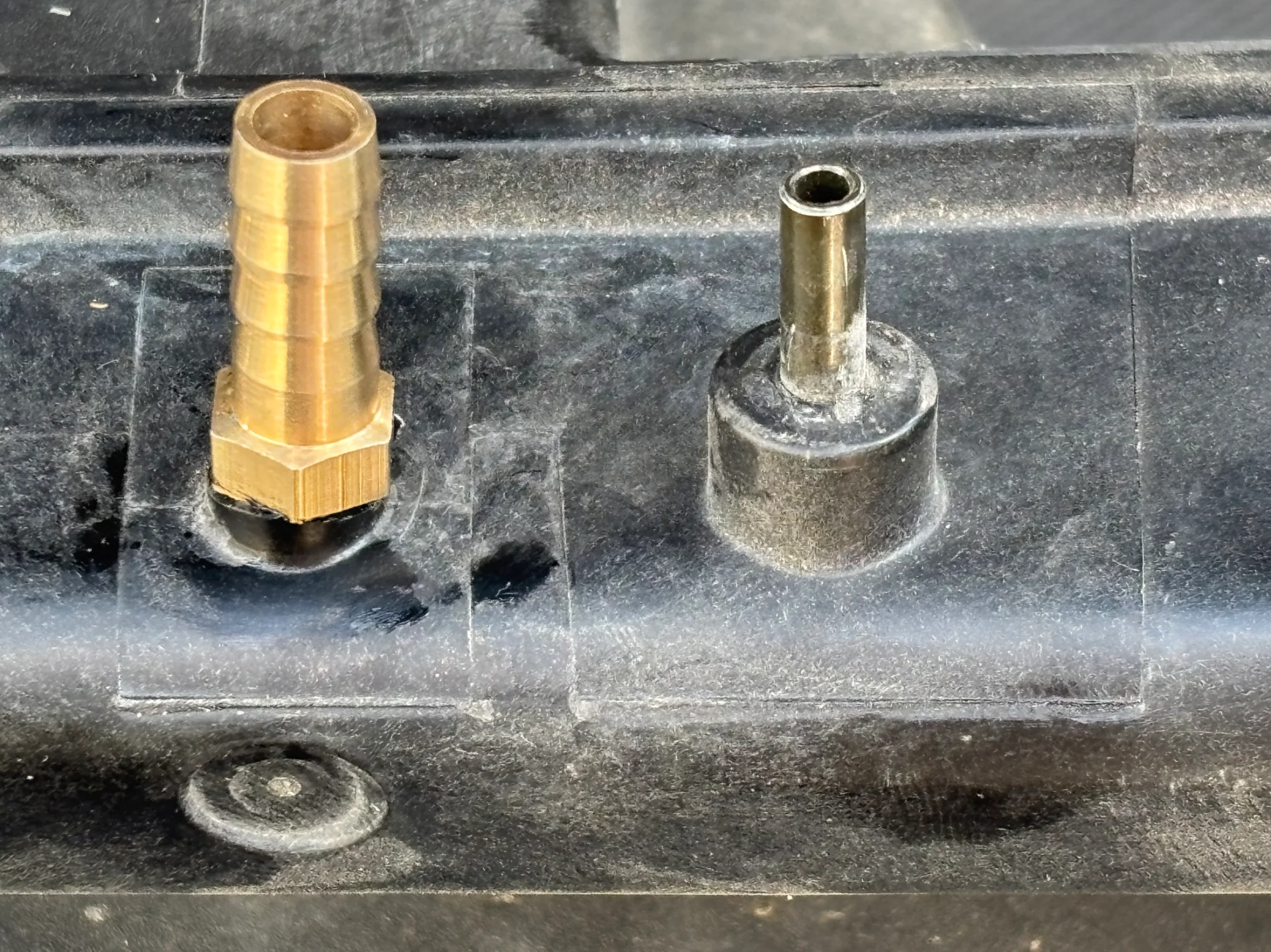

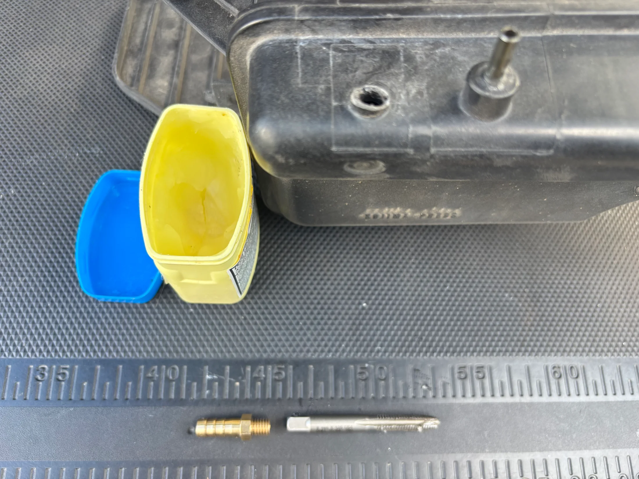

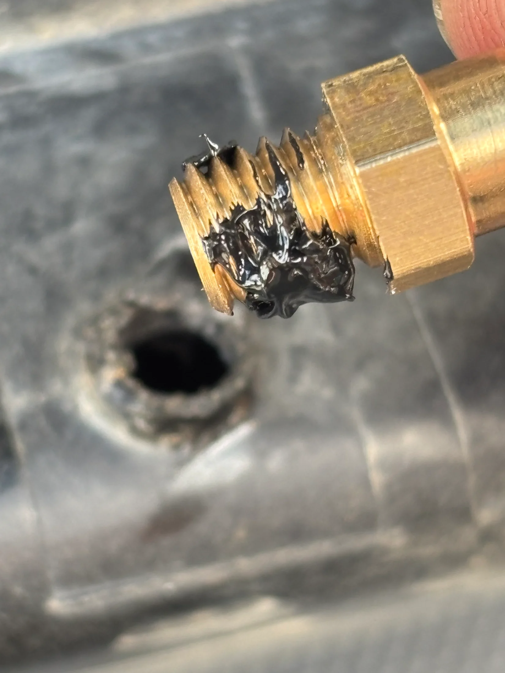

Found a 8mm barb fitting with 8x1.25 threads. Tapped the box and used some petroleum jelly on the tap to catch the shavings. I wish there was more plastic to work with here, but it is what it is. Used some black FIPG to seal it and barely tightened it past hand tight as I think the plastic is probably brittle all over at this age.
I drove it a couple of times tonight andI tell you what it feels like the truck is more peppy. I really can’t believe it. Maybe that thing’s been cracked causing a vacuum leak and leaking for some time and it finally let go.
