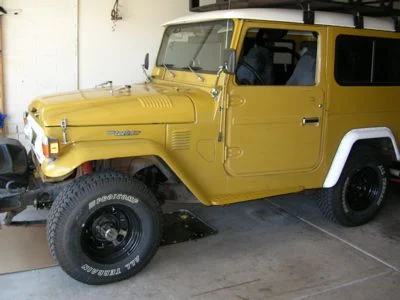

:crybaby: Hey, dude, that is one really sweet rig you've got there.;p Keep it bone stock and tidy forever:rolleyes: . It's almost like a shrine.:popcorn:
