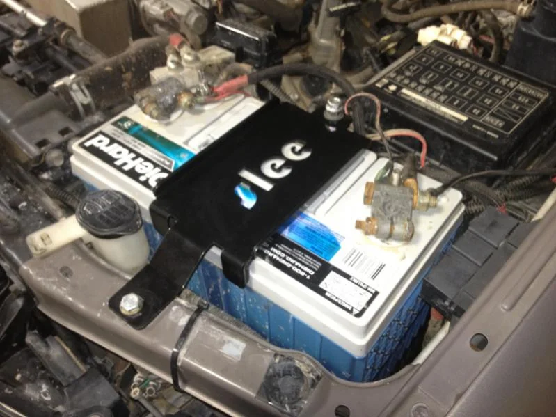

According to the installation instructions he has on his site, it reuses the original "J" bolt. We will see how it goes.
Are you still using the Slee dual battery tray with the Odyssey 1230 & new 1500?
Yes...at least the tray portion is Slee's original (not sure how he builds them now...but there isn't a vertical lip on my tray)...so the 1500 fits...just barely. I have about 1/4" or slightly less between the battery and the windshield wiper motor...and about 3/16" between the battery and the mounting bolt the battery tray shares with the power steering reservoir.
I thought about moving the power steering reservoir farther forward and looking for a larger output battery than even the 1500...but with the Mobi-Arc and ARB compressor I've got no mo room! But the 1500 should be a good improvement for my needs.
Slees primary 31M battery tray kit doesnt come with a J-Bolt, it still fits with the double nut setup. The tray itself is very slimline and only adds the thickness of the material to the bottom of the fender.

Well, I have the new Odyssey, Slee battery tray, and correct terminal studs. Now I need to make a new and longer ground cable before I change everything out. My OEM one feels REALLY short. Any recommendations? Should I make it or just go to the auto parts place and just buy one?
Dan, what battery terminals are you using in that picture above? Those look nice and I have not seen those before...not that I am going to change out mine or anything.....
They are car audio type battery terminals I bought quite a few years ago from eBay. I see similar still offered on eBay.
I assume you refer to the fender to battery terminal ground wire yes? If so maybe the typical car parts retailer has a ~12-18" pre-made 4ga that would work.
OTOH if you give me the exact length, assuming off the shelf won't work, I will make you one for parts cost. Should ship ~$5 ala USPS Priority.
Big ratchet type that will work up to 1gauge. And then for bigger the kind you whack with a hammer.
