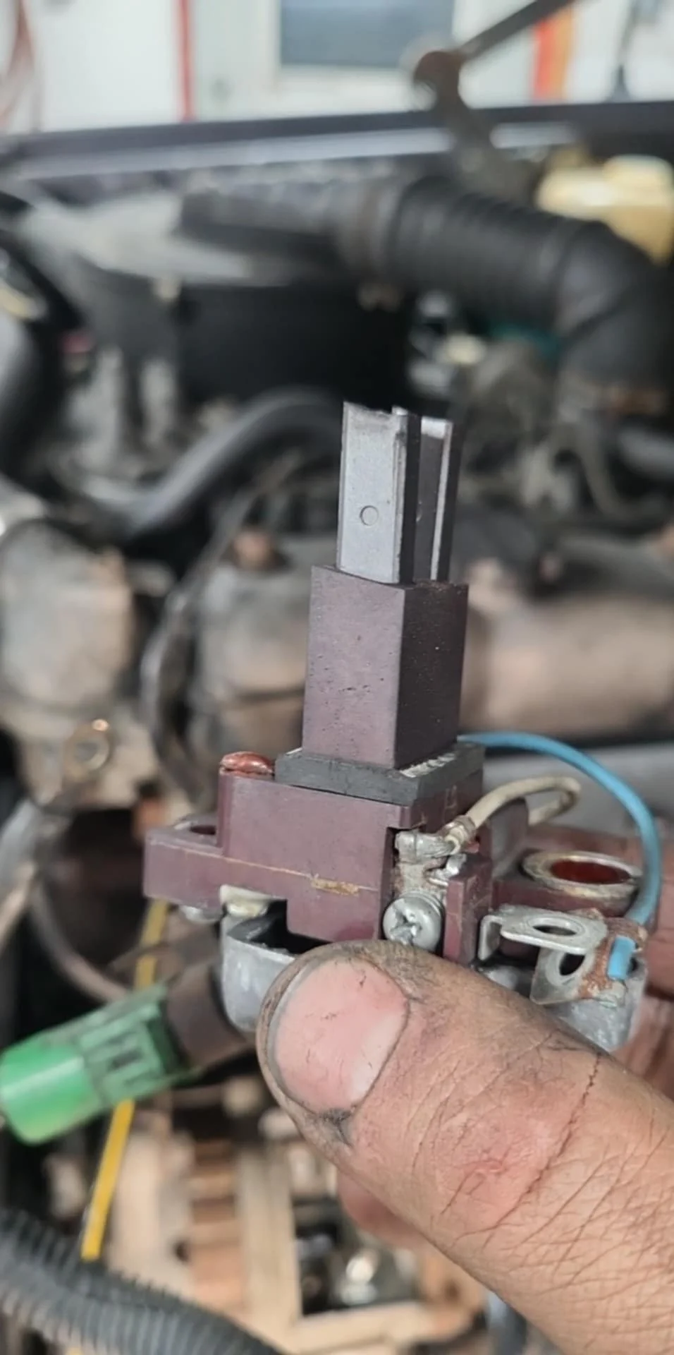

Didn't had time to test it but im pretty sure the brushes are now too short as I completly lost it ,the lights are now on all the time . Will change the alternator tonignt and look this one up for answers
Well ...
Brushes are like new ... inspected connectors and wiring everything is nice cleaned battery posts and reinstalled everything. Seem ok for now .....

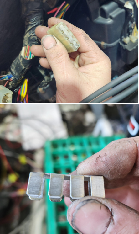

Changed the belt... did not fix the problem so I inspected the wiring ... witch lead me to a relay on the driver side , Charging light relay and it turns out it was the culprit.
Seem like a rare / discontinued / expensive / pain in the ... part to find ... so I will try to fix it this week.
Thx for all your guidance :)
Well ... in the end , replacement relay are discontinued ... and used ones are much too expensive for what they are ...
So .. I got myself a 24v 5pins relay and wired it up in a way to make it work.
Fixed it for 20$ of all new components ... IMO , better than any used OEM relay.
Easy to do too .. will post the pinout I did on it tomorrow .

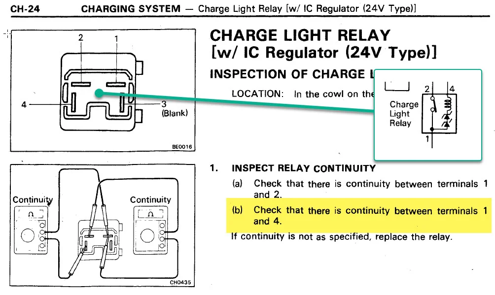

So there you go : according to this page in the manual the pinout is as followed
You just wire it like you would install a 4 pin relay but you jump 30 and 86 together
