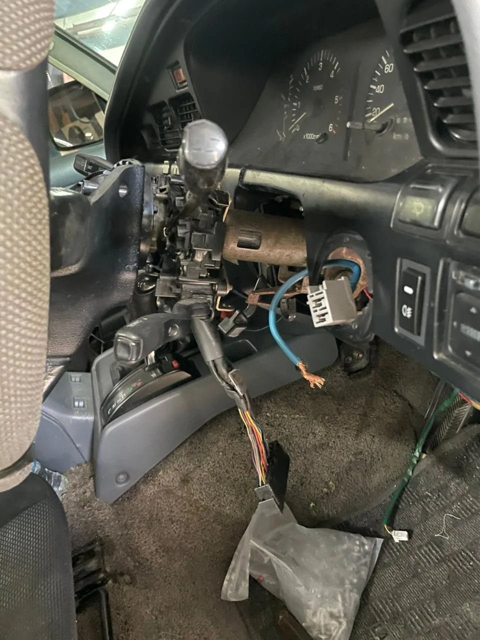

1: remove your existing wheel and column

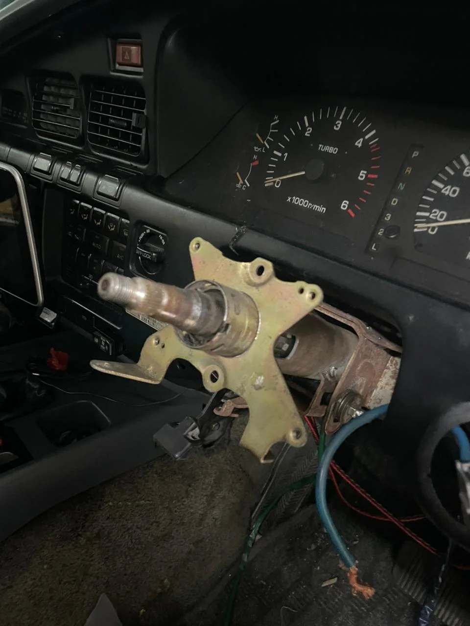

2: remove/grind off the existing bracket that mounts the OEM column to dash. Alternatively, you can make a bracket, but I wanted a stock look.

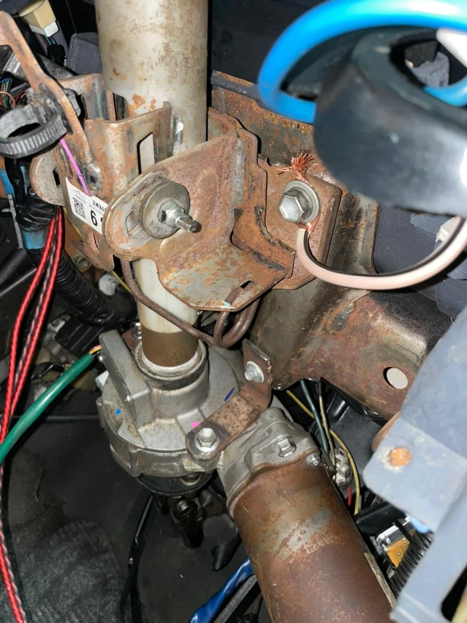

3: line up new column and mark bracket spot to weld. this pic is with the yaris column installed using the factory mounting bracket and a L bracket to make it more secure from the tq of the motor

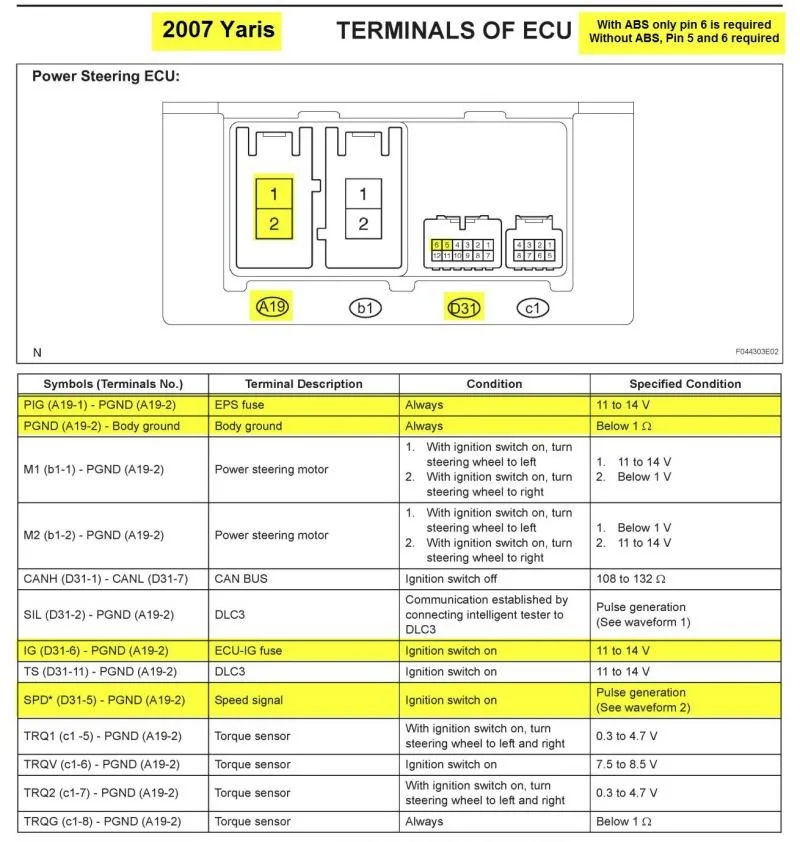

5: ecu wise, you need a 60amp fused constant positive connection, a ground and on the yaris ecu, pin 5 and pin 6 (abs and ignition) needs to both see 12volt ignition to energise the motor. this allows with engine off to have 100% motor assist as a benefit also. Jacks A19 and D31 are the only places you need to wire up. the other jacks are all used by the motor.
