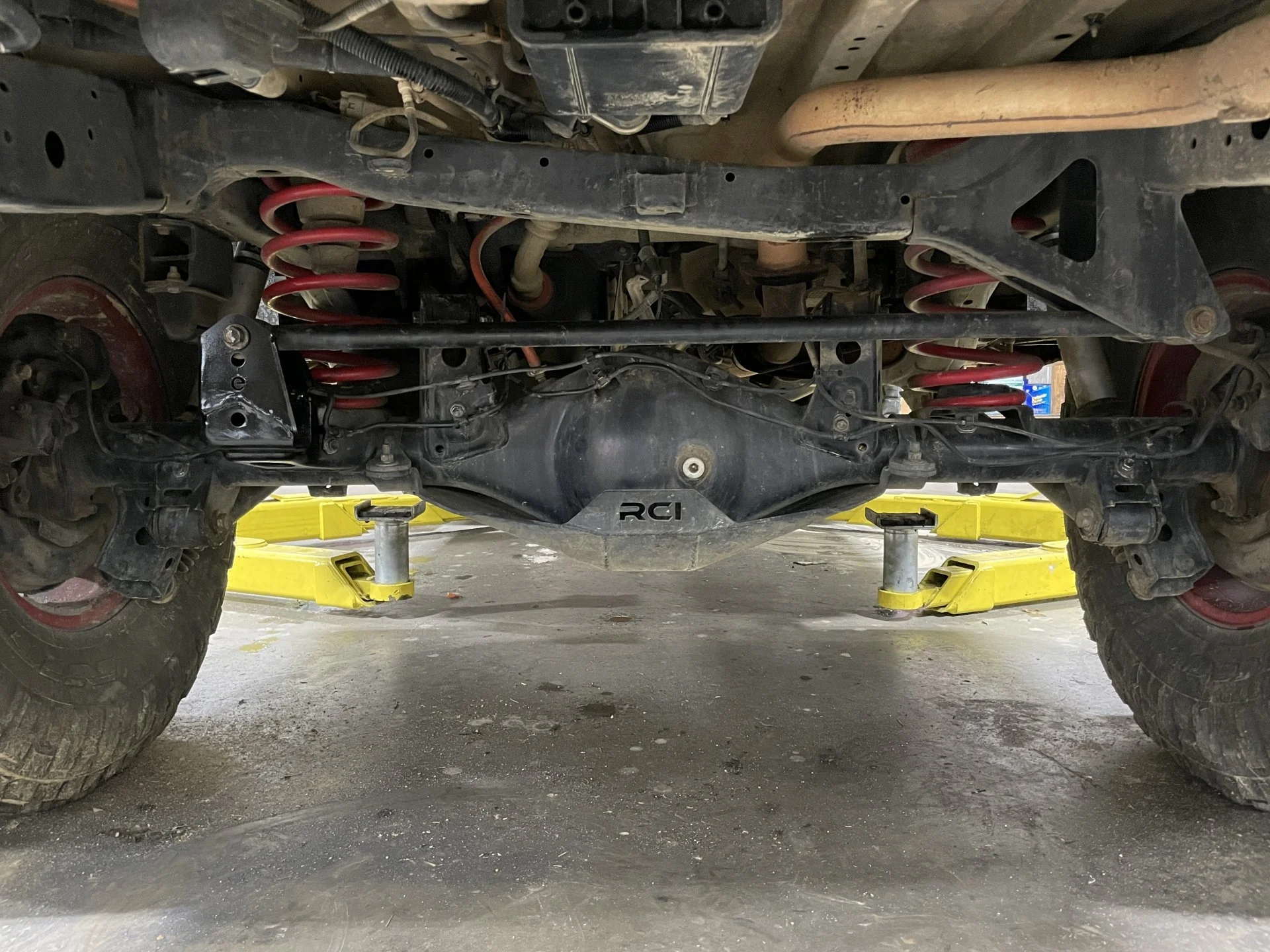

Just installed this to correct the geometry of the panhard after you lift the suspension. About $90 for the laser cut bracket. Pretty easy install.
Is it an incredible improvement?

I’ve been looking at these a lot lately. Wondering what your experience was with welding it in? Is the forward side of the mount easily accessible for welding?
Yeah, if you take the wheel off, you should be able to get in there. After tacking it up in a few spots, I think I started on the inside though.

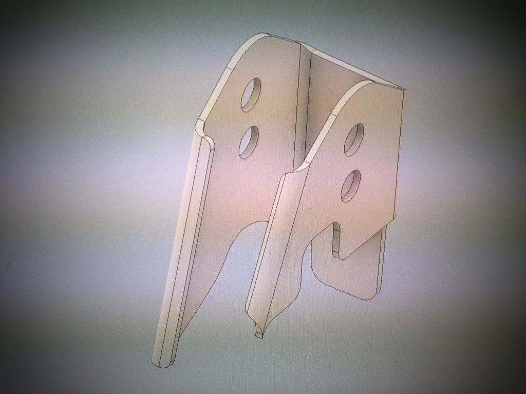

Here's an image of the front profile.
@eimkeith just installed mine tonight after ordering from you about 6 months ago 😂. Noticeable improvement on my short drive after install. Do you recommend middle hole or top hole for BP51 lift?
Whatever gets it more parallel to the axle/ground.
