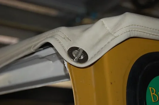

Here's a pic of the front of the top secured with twist locks using the factory holes or those who haven't done it yet. Took come stretching and massaging, but it worked out really good. I think if I would have attached the twist locks before running the top thru the upper door frame channels, it would have been much easier:grinpimp:
mine look pretty much the same. How did you get around the screw and nut that attaches the bow to the windshield? That was the biggest bitch for me...
I used that hole to bolt the twist lock on, I didn't make a new one. I thought about making a new hole like you did, but I pulled at the top for a while and figured out I could get enough pulled down to reach the twist lock. The vinyl top stretches pretty good, I don't know how much your canvas top does:meh:
Only issue I had was the twist locks got the paint scraped off initially when I fitted the twist locks, once the top gets all stretched out and loosens up a little, I'll put new twist locks on.
I tryed the same thing with the twist locks but my hard doors hit the nut :confused:
I had a bolt there before with my hard top on and my doors were Ok IIRC, but if I have any issues when they go back on, I'll try to get a thinner nut and cut the post down a little or maybe adjust the door hinges a wee bit
