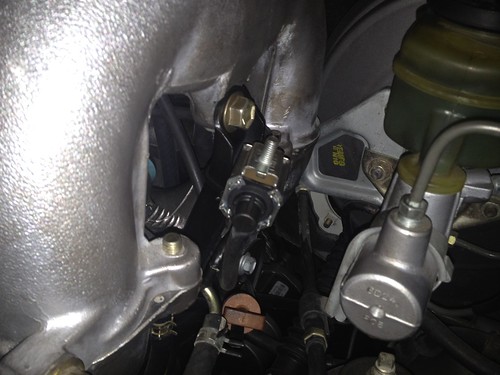

Once you get to 10 posts you can add photos to show how you rigged it up. Which code reader did you use?

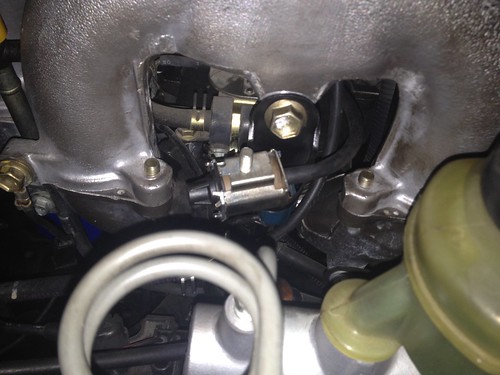

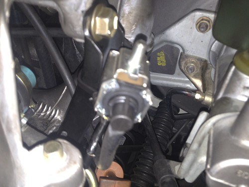

Here are a few pics of the new part in place. Sorry, they're from my phone and not the best, but at least show how it's positioned in there. It's just zip tied to the intake bracket, but it looks like it's gonna be a good spot.

If it weren't 108 degrees in TX today, I'd do a pictorial how to. Doing a how to with pics would be pretty hard though since you can't really visually see much of the vsv under the manifold. A lot of the work has to be done by feel. I think I saw another thread though on relocating the vsv that may be helpful. There was a pic of the underside of the intake manifold that was helpful in knowing what was under there. Just search for "vsv relocation". It's really simple once you locate the electrical and vacuum connections of the vsv. Just unplug it all and plug it into the new part. If you have questions feel free to ask. I'll do my best to help out.

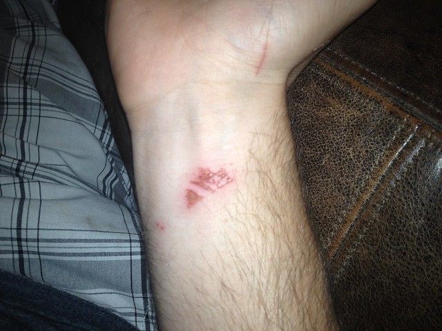

If you decide to tackle this project, I will give one word of advice. Either let your engine cool down before starting, or make sure you have really good gloves and a thick long sleeve shirt. I had a piece of skin exposed in between my glove and shirt and this was the result of my contact with the intake manifold:
Did I mention that I'm really impatient. Got the burn marks to prove it. But I got rid of that damn CEL though. Makes it worth it! I wouldn't recommend burning the hell out of your arm though!
