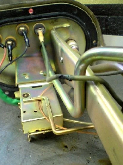

landtank said:
Doug, why do you need a bracket for a wiring issue? Is there some sort of insulation missing or worn through?
Yes, the wiring on the bracket was worn through. It's suspected that it was due to contact with the pipe next to it.
attachment.php
In this pic, the wire was twisted a bit to expose the chaffed area.
The wire was replaced and rerouted to as to not come in contact with the bracket.
Since they were in there, they replaced the pump and associated bits.
attachment.php
I just noticed in thie picture you can see where the wire was most probabaly rubbing. The bracket that the pipe curves around seems to have a nice sharp lip. I'm willing to bet this is what the wire chaffed on.
NorCalDoug said:
EDIT:
Here's a pic of the offending wire -- the green one.
Ok, so here is the stock setup when I pulled mine. Looks like yours may have had the wire wedged between the tube and the bracket???
No, looks to me that they're in the same place. Just could be that mine was resting against the tube while yours was farther away. The vibration of 130k miles would be enough to rub through some insulation I'd think.

Ok. I thought somewhere it was mentioned the wire had been moved in that pic of yours and it looks like that wire could have been routed on top of the tube and that would have chaffed the insulation over time like you surmised. The other thought is the little rubber insulator that sits on the bottom of the fuel pump. That pic of mine is at around 150K miles FWIW...
The wiring is part of the bracket.
The wiring is part of the bracket. They were able to fix the wire on the bracket. Ordering a new bracket with new wires attached would've resulted in wating 2 more days for the repair to be completed.
