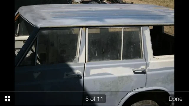

Ebay '72 partially resto'd. $8k but check out the roof

Here is the seller's description of how the roof came to be - sounds like a lot of thought went into this!
Hi Ron:
I am glad to answer any of your questions, so keep them coming if you want.
The original roof was totally fatigued and oil-canned because it was just one big expanse of metal. I wanted to keep the Pig stock, but was afraid that if I found a good stock roof skin and put it back on, that it would just fatigue again over time.
So, the first task was to find a similiar type roof, but that had pressed ridges, for strength, like the hood on the Pig, which has two pressed ridges. Then I had to find a roof that had exactly the same curvature at the front where it would receive the windshield, and then would mate up with the front pillars.
After A LOT of searching, I found that the 1980s Ford Econoline van met all these specs, but it was much too big. But, I figured, if I cut it carefully in parallel strips along the length, and the at right angles to the length, I could shrink it, while still keeping the pressed rigdes parallel to the run of the vehicle and to each other.
So, I cut off the original roof skin at the spot welds and at the front pillars, and did the same to the Ford roof, which I found in a junk yard.
I shrink the roof down by cutting it into panels as I described, and then I bedded everything with a adhesive/mastic from Eastwood, and used a massive spot welder with a very, very long reach to weld the roof together and to the vehicle without distorting it.
I was pretty nervous, to tell you the truth, while I was doing it, but very proud when it came out the way i wanted it to.

Pablo,
I would really like to see this first hand. It does sound like he thought it out. If that roof is good, then I think the whole package is a good deal. The 55 roof should of been ribbed from the factory. I say, Good Job!
