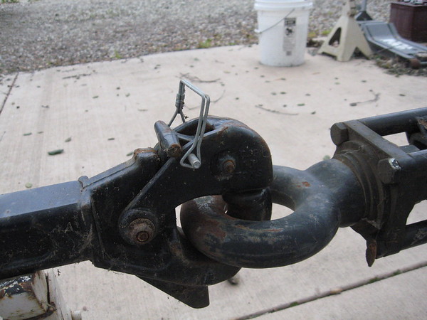

After years of poo-pooing them I recommend a pintle with a properly sized lunette ring. Properly sized means that the cross-sectional diameter of the ring is a minimal clearance fit in the closed pintle. Can't bang if it doesn't have enough room to really get moving inside the pintle's opening.
This one is way too small and likely makes noise:
This one doesn't make much noise:

Banging has always been my concern with pintle hitches. Having any room/play at all is almost like a psychological barrier for me; I just really like the idea of no movement at all. Will do some thinking!
Max coupler was highly recommended to me by an experienced trail leader over the Lock N Roll. It's sometimes referred to as the "silent hitch". I like it. Here's a link to the source. Pick which version you need for your tongue. I already had the 2" bar stock, so I went with the CUOR 210 and bolted it to the bar. But, I can weld it on any time I choose. For now it's fine with no sacrifice in strength, plus I can move it if I need to with no hassle.
I suspect that no matter how tight the fit of a lunette in a pintle that it will never be as quiet as something like the Max Coupler, but after trying out the combo in the lower pic I have yet to hear them.
