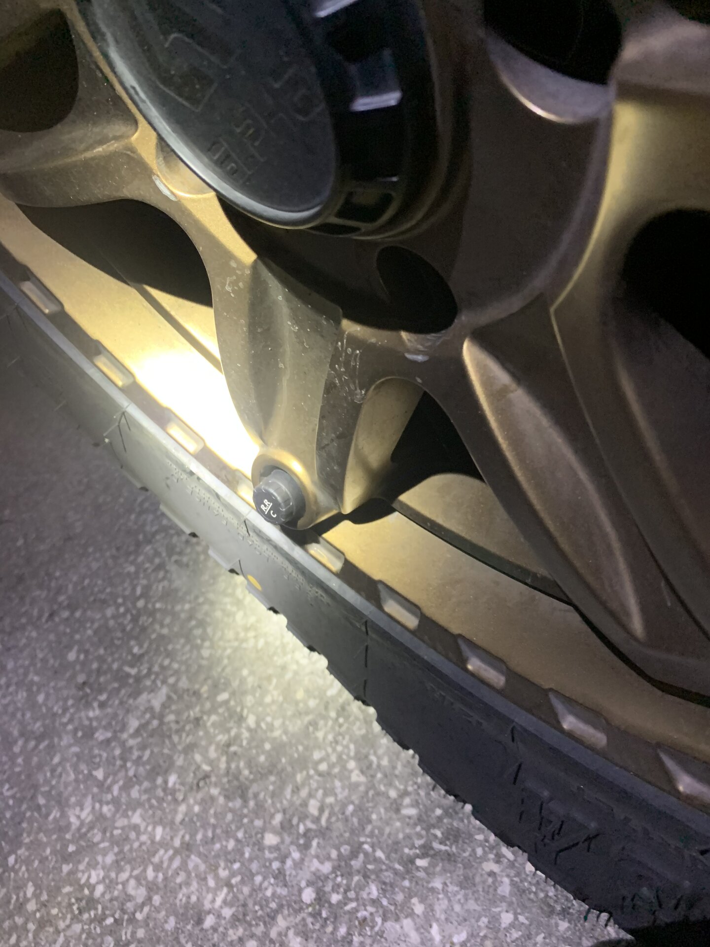

I got some new 35’s and wheels and, due to the age of my tpms sensors in my old tires and wheels (light was always on), I figured id skip having new tpms installed initially.
When I went back to look into installing them, the local sams club (who installs them for $48 each w 5 year warranty) said there would be issues with their universal tpms on older Toyotas (I’ve got a 2011 lx570)…he said there would also likely be issues with 35’s since their corporation has strict parameters regarding working on vehicles larger than oem tires.
Thus he recommended oem tpms sensors and an install with another shop.
It seemed like a hassle
I installed a $42 external tpms system onto my alpha equipt wheels…seems pretty good so far. The screen readout tells me psi and temperature…and is oriented to each tire.
The sensor sticks out just slightly from the protective sheath on the alpha equipt wheels…batteries are user replaceable.
If you’re looking for an easy tpms addition to an extra set of wheels, trailer, or temp, these aren’t too bad for $40.

I used those on other older cars made way before TPMS was a thing. They are Ok. The only issue is that they need to seal well as they are the only thing that prevents the air from escaping from the tire. There is the hassle of taking them off when inflating the tire but if you do not deflate for off road it is acceptable.
For our trucks I see that as a temporary solution until tire replacement time.

Yeah good point, if they don’t hold the air in, they’ll have to come off.
Nice thing about the alpha equipt wheels is that there are two tire stems…so I leave this on one of the tire stems and use the other one for airing up and down.
