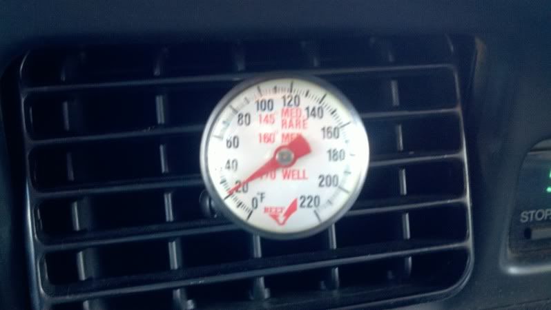

I'm not sold on the notion a properly converted system won't cool down as well. This picture below is from the :princess:'s '93 that I converted to 134 last week. Only items replaced in the whole system were o rings and new piggy back fittings. Has a newer blue hub fan clutch, no aux fan. Picture was taken at idle with the hood up.

Outside ambient temperature has a lot to do with output. Temperature split is a much better way of how well your AC is working.
Lets see your 134 temps when its 105° out.
I regularly see a 40°+ differential in my FJ40

Beside the outside ambient fan speed has someting to do with Temperature splits. Slower the speed the longer it takes the air to cross the coil giving it longer time for heat transfer equals cooler air. Plus a digital thermometer would be alot more accurate than a meat thermometer.
