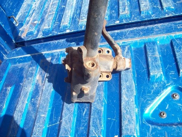

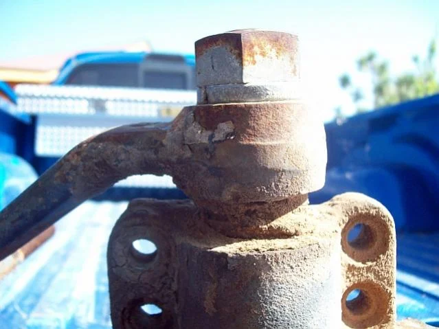

Other than the black goo inside, it doesn't look too bad (yet). Does look like a pain in the arse to get these pitman's off..(I've heard of people breaking pullers doing it).

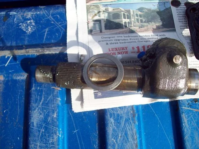

I started pulling things apart yesterday and think I'm screwed on this box. After pulling the pitman, I cleaned up everything and the red flag went up when I looked at the sector shaft adjustment bolt (look at how far it was screwed in). Also inside, I only found one washer and no shims for the sector shaft. I think this box has been pilfered for it's shims.:frown:
What do you think?
Here's a pic of the sector adjustment bolt on the box that is in the truck for comparison.

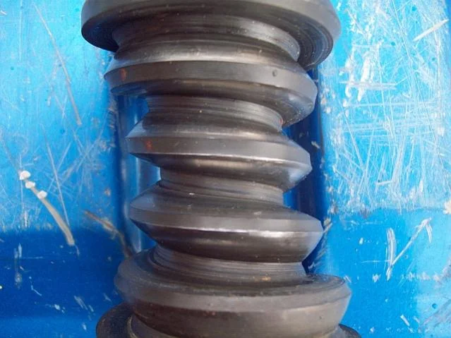

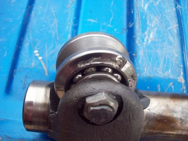

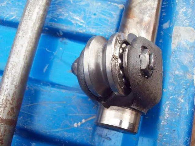

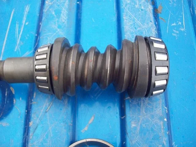

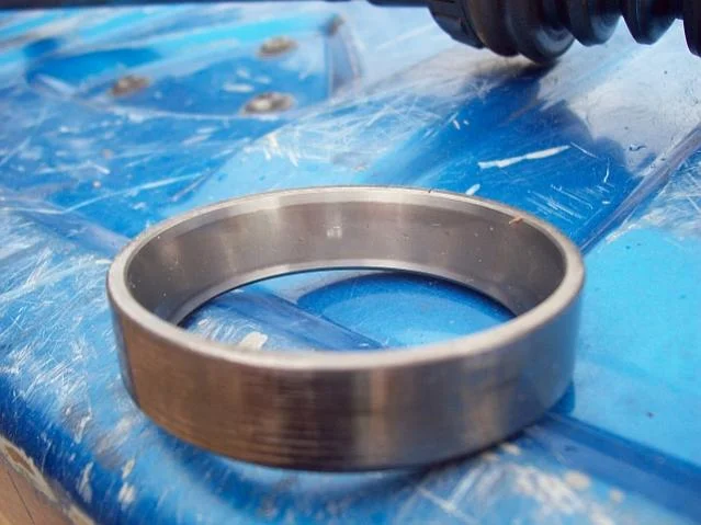

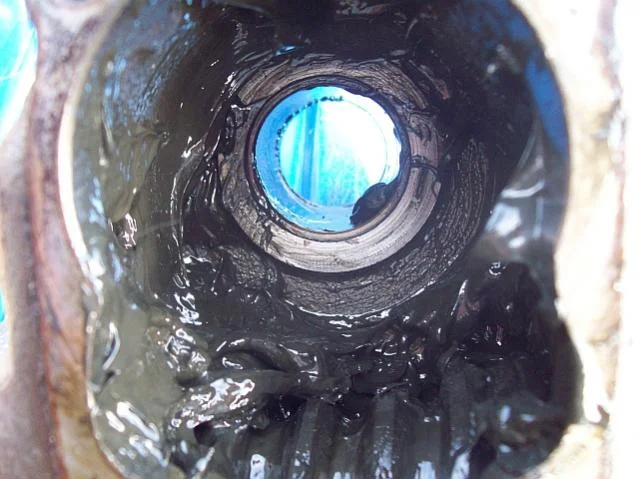

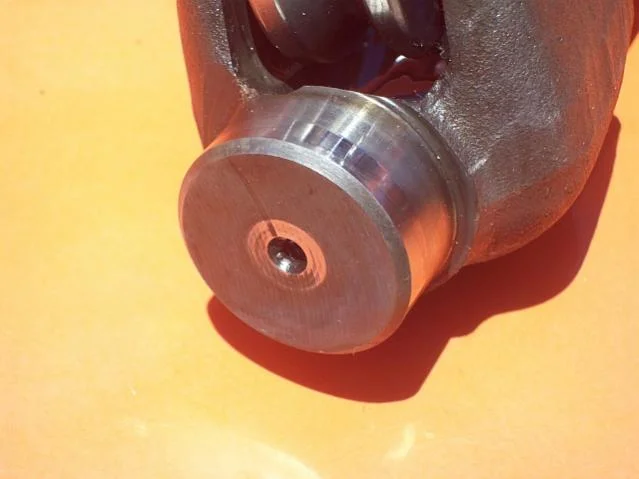

Here's some more polisher pics. Check out the casting flaws on the roller gear. The upper and lower bearings are in suprisingly good shape, there is some very minor pitting on the lower bearing race, but don't think it's enough to be concerned with.
The roller bearing is another story, I have somewhere between a 32nd to a 16th of an inch of up/down slop and a fair amount of side to side wobble.
Am I correct in asuming that if I replace the roller, quite possibly I may need some shims to compensate for this lack of slop to prevent bind up?
Also, if you see anything I'm overlooking, please pipe in, your .02 is greatly appreciated:cheers:
X2, that's what we did, worked well.

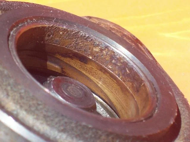

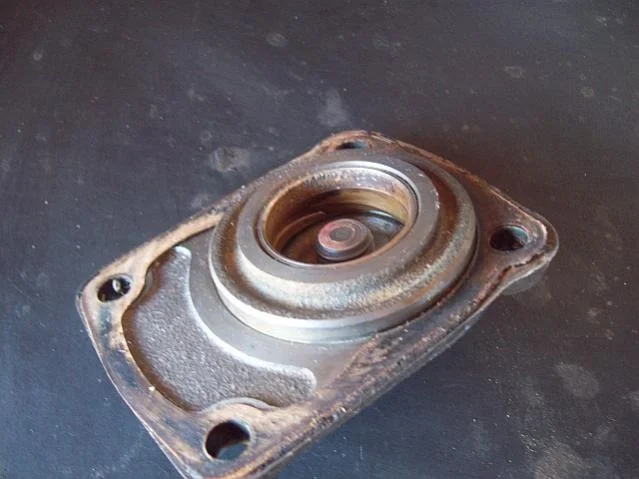

Your bearings look better than Claudia's. How much end play does the worm shaft have? We sanded the end plate gasket on the belt sander to add preload. If those bearings have any play, it will allow the worm to move and that along with the roller play will account for some/all of the excessive adjustment in the adjuster bolt.
Shoot pix of the inside of the cap with the adjuster bolt and the shaft end where it touches.

I tightened up the roller (the nut was loose:eek:), I think I need a small spotweld to keep that from backing off, correct?
There is a fair amount of slop in the bronze sector bushings and lots of pitting on the smaller one.
Here's some pics.

You want some preload on those bearings, we slightly sanded the gasket on the end plate to tighten it.
I just staked it with a center punch.
The bushing has to have some play, even when new, unless it a huge amount of play I wouldn't worry about it. I would remove the gasket from the adjuster cover to move it in slightly and give slightly more adjustment, for final assembly seal with RTV. Then back off the adjuster, put a couple of drops of oil on the bearings, assemble, adjust it and see what you have.
