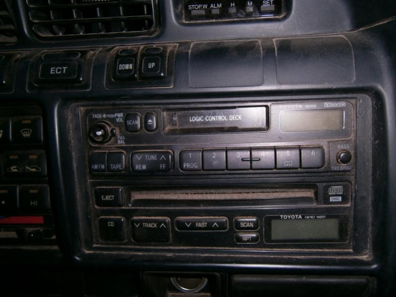

Are those plastic indentations in my 1994 HDJ81V usable for switches?
it can be done, but requires support of the switches behind the dash -- will not simply snap in place.
Of course, that would make sense.
Probably smarter to go with something completely non-factory looking, then.
Anyone know how much room there is behind them?

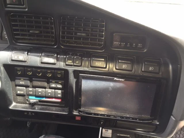

I have two OEM curved fog switches (84160-60030) that control my front aux lights in that spot. This thread gives some info to wire it up correctly. Early OEM fog light switch Part No.? As well as what other switches might be available.
Thanks, that's very useful.
Doesn't really help with mounting switches in the spots that are not cut out, but I'll have to figure that out.
I did not do the install of the switches myself, but my understanding is that the blank spaces were cut out of the dash and a bracket made of ABS was attached to the switches to support them. I am not sure exactly what the bracket was also attached to for additional support. see below for picture of installed switches -- the two on the far right --

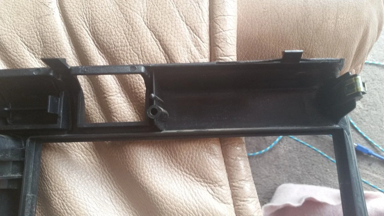

Where there are blanks this is true. But where there are indentations, but no blanks, not so much. look below:
Are those not blanks that can be pushed out from the inside? I have some new-in-packaging blanks like this at home, and there are markets that used these extra slots for things like subtank switches, etc.
Not for my US spec 94. Part of the dash panel.
The two furtherest away arnt cut ou with inserts pressed in like the rest.
Theres tons of room behind.
Ive got my dash out repurposing switches and replacing bulbs ect at the moment so ill take some oics soon and post them
