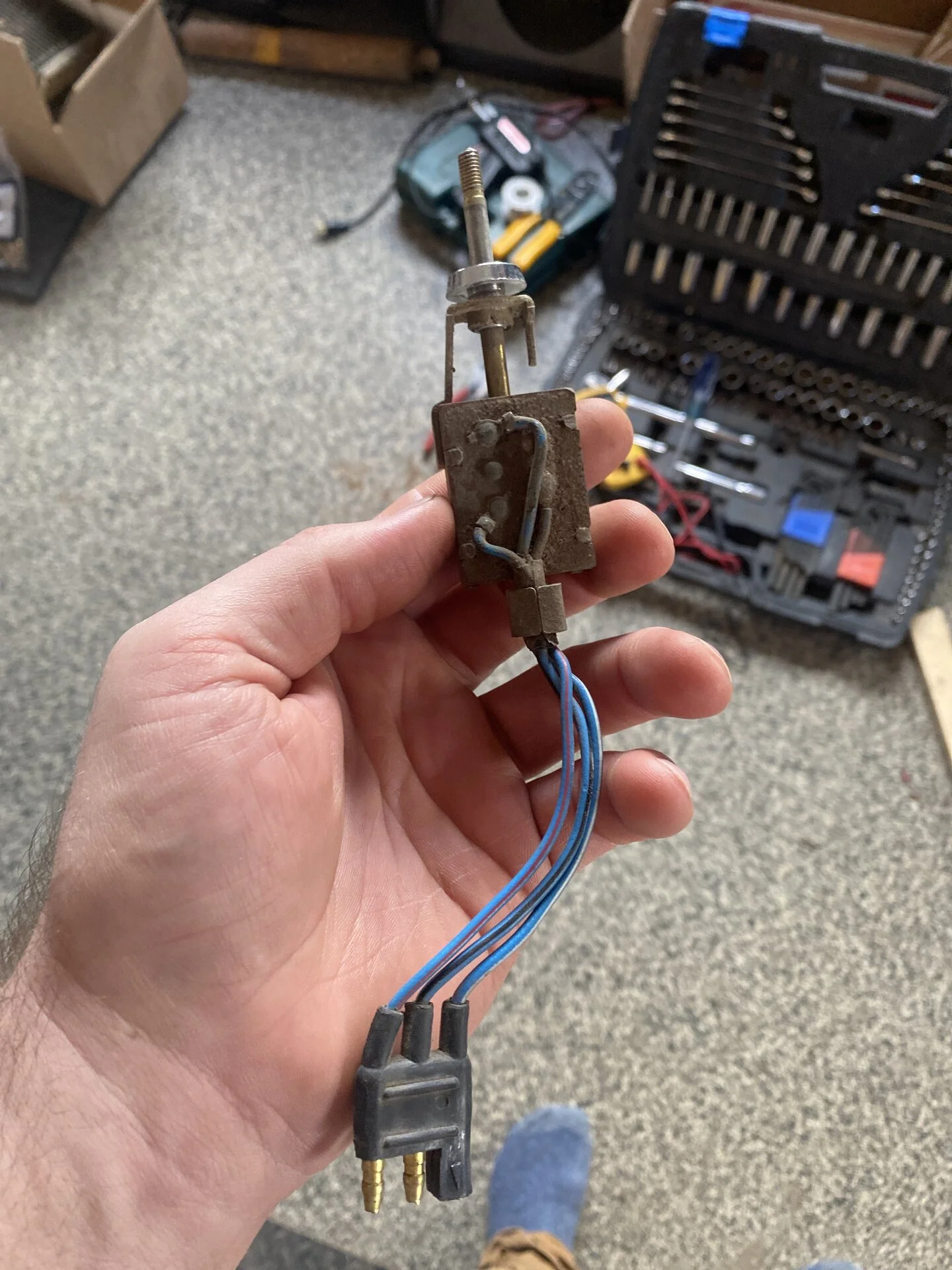

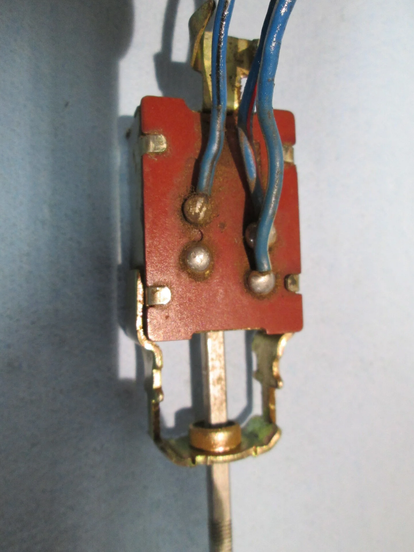

i see that @ToyotaMatt has refurbished some of these switches and wonder if anyone knows a thread that would guide me through the process? or is this only something electrical gurus should attempt?
i have pulled the switch and can confirm my heater resistor is not the problem. the switch provides power when on high but not on low (the middle setting). i can connect the wire from the high and low setting on my heater (it’s an aftermarket flexalite heater) to the hight post on the switch and they both work. when connected to the middle/low setting there is no connection. i assume it’s something with the contacts in the switch.
i’ve searched and cannot find a threat that goes into switch details. just ones that lead to heater resistors

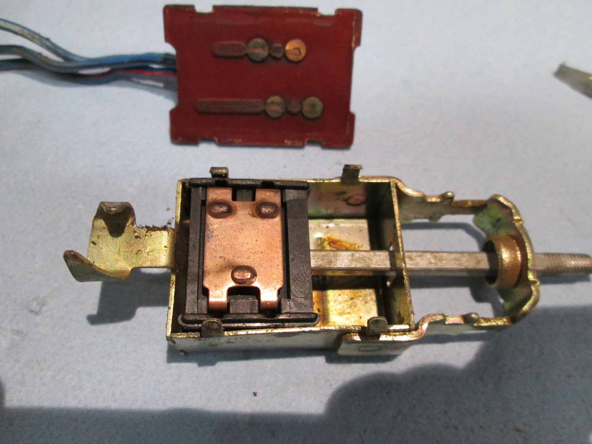

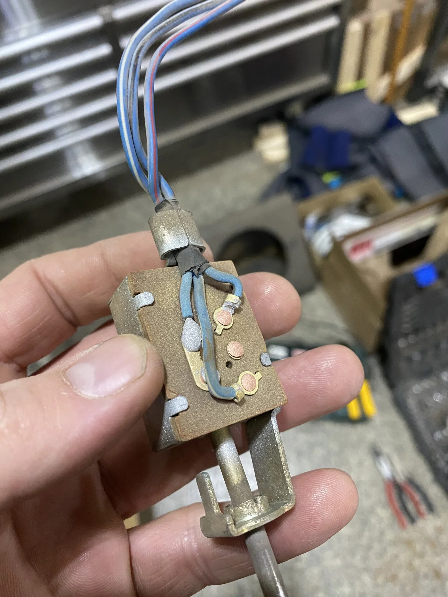

@franklin40 no electrical guru here, just an average tinkerer. I did the exact same thing couple of weeks back since it was working on one speed most of the time. If you fiddled with the knob, you could sometimes get the slow speed to work. Dont have a write up but the pictures attached should help.
Nothing to be afraid of the tabs or the detent ball bearing. No parts were lost. Just be gentle when opening the tabs.

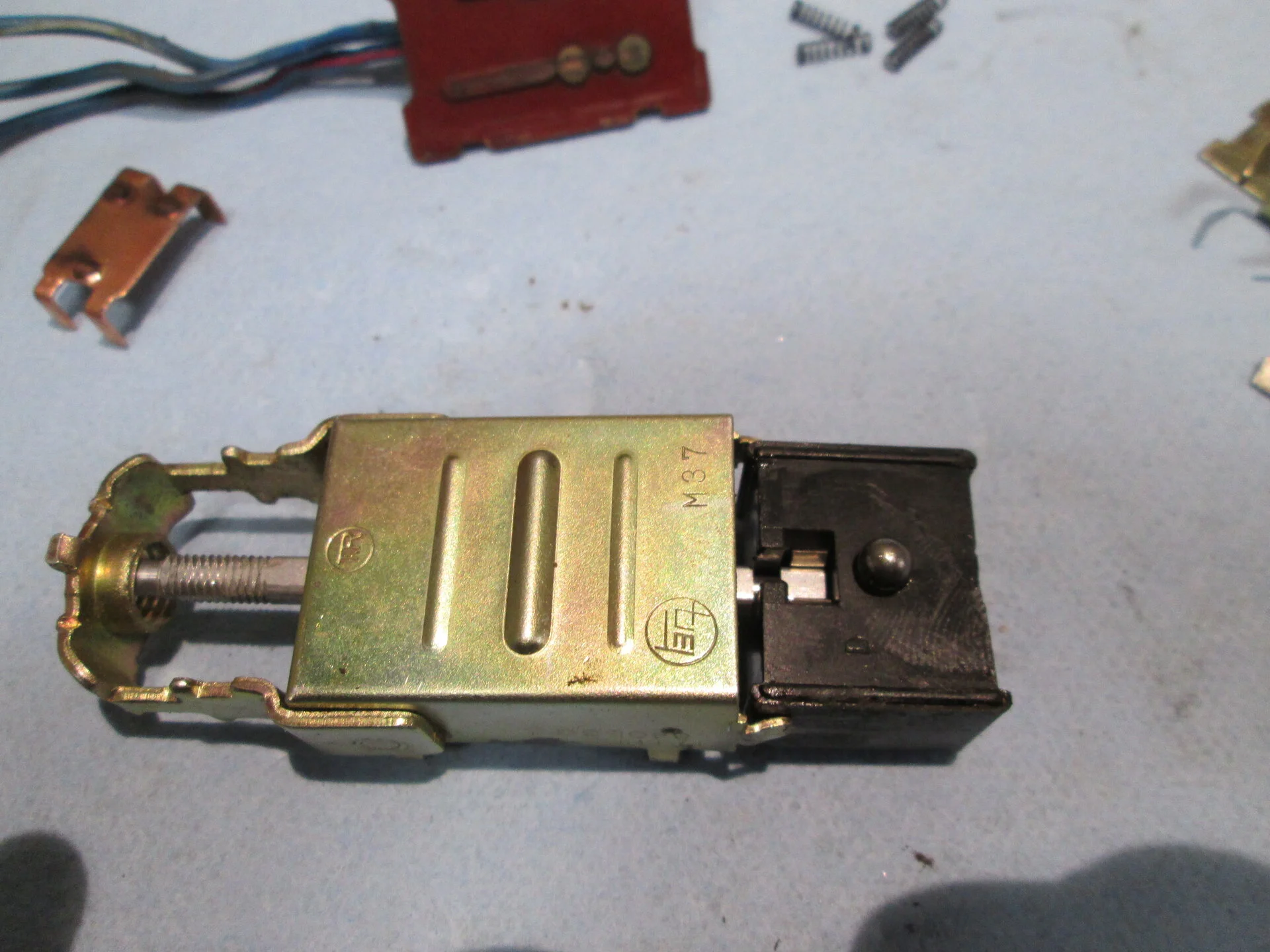

There are 4 tiny springs that keep up that copper "H" shaped plate. dont lose them. See the dirt on the contacts below:

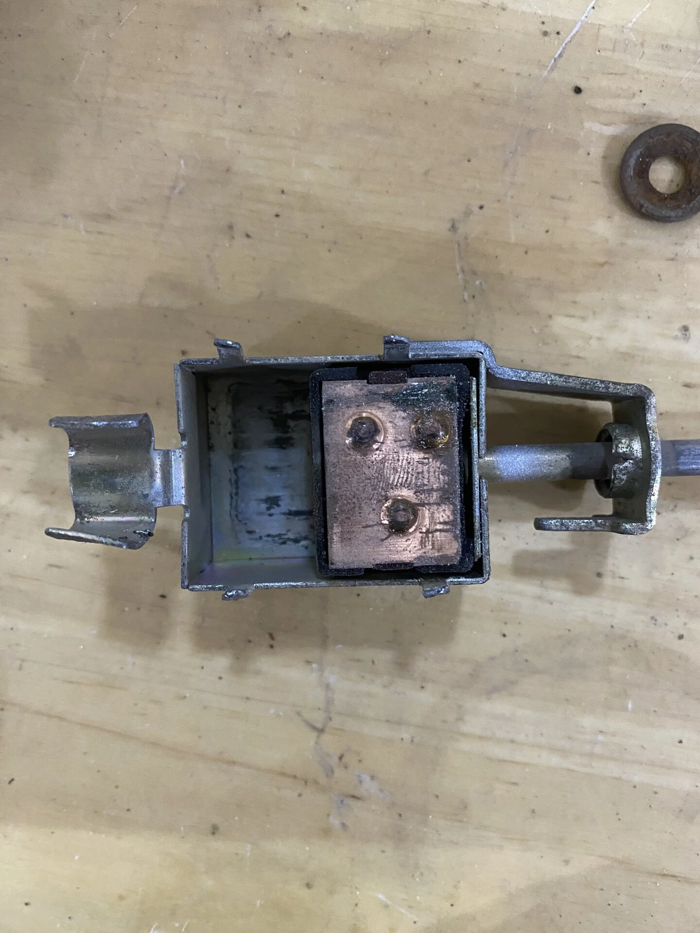

The detent ball bearing is under that black plastic piece and it has a place for it (you will see when you open it up. I cleaned all the contact surfaces (3 nubs on the copper plate and the contact where the wires are soldered) with some emory board lying around, wiped it and put back together. Here are the 4 springs and the ball bearing has snuck out from its spot in the pic below:
Flipped over with the location of the ball bearing. Put it all back together being gentle to return the locking tabs to original position. Heater is working now at both speeds with no issues.

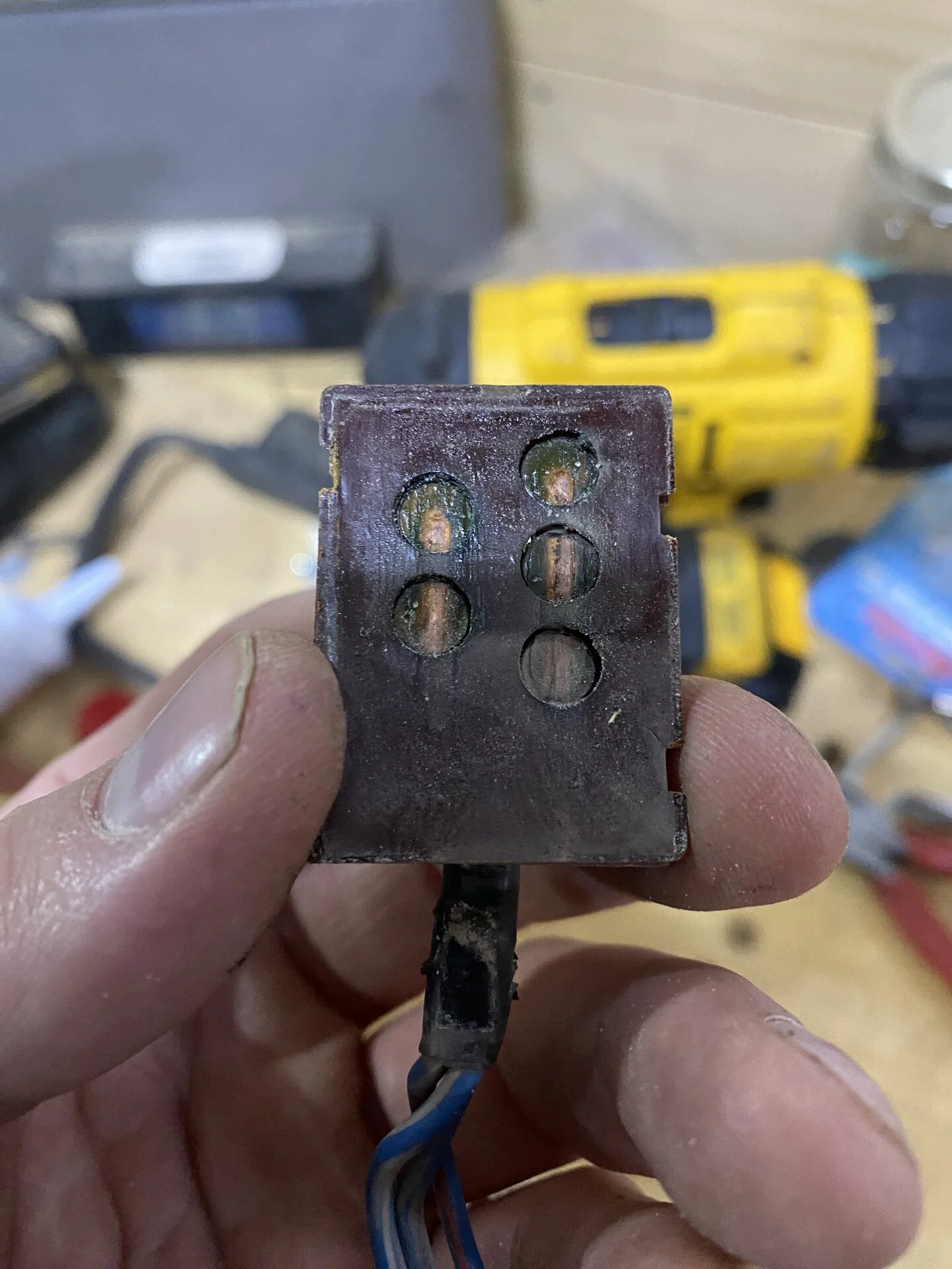

k so here we go!! i got it working.
gave the board a quick gently blast with the media blaster

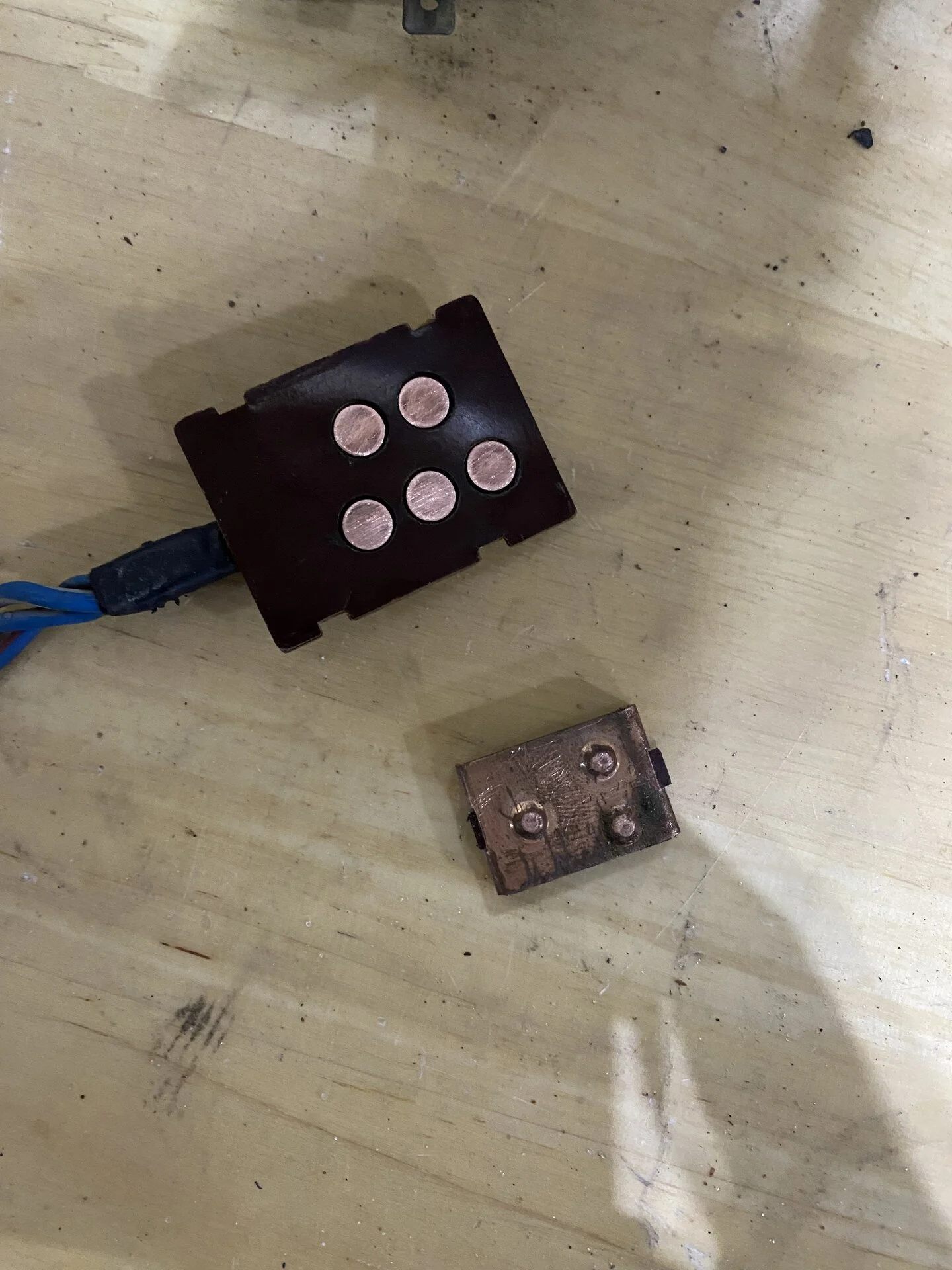

then gently pry open the wire clamp followed by the 4 tabs. i tried to not just bend it by kinking the tab at its base but once it was lifted off the board i used a good set of needle nose pliers to actually straighten the tab. this will spread the bending stress over a longer area. this is the mucky mess inside
the brown plastic comes off the 5 pins so they can be cleaned up and sanded to remove corrosion. the copper plate can be removed to clean up the contacts. i forgot to get a picture but under the plate with the three contacts are three springs. the two black outer springs have the ball bearings under meath them. the centre shorter spring doesn’t. that’s all there is in there!! a good plant of electrical cleaner and time to reassemble.

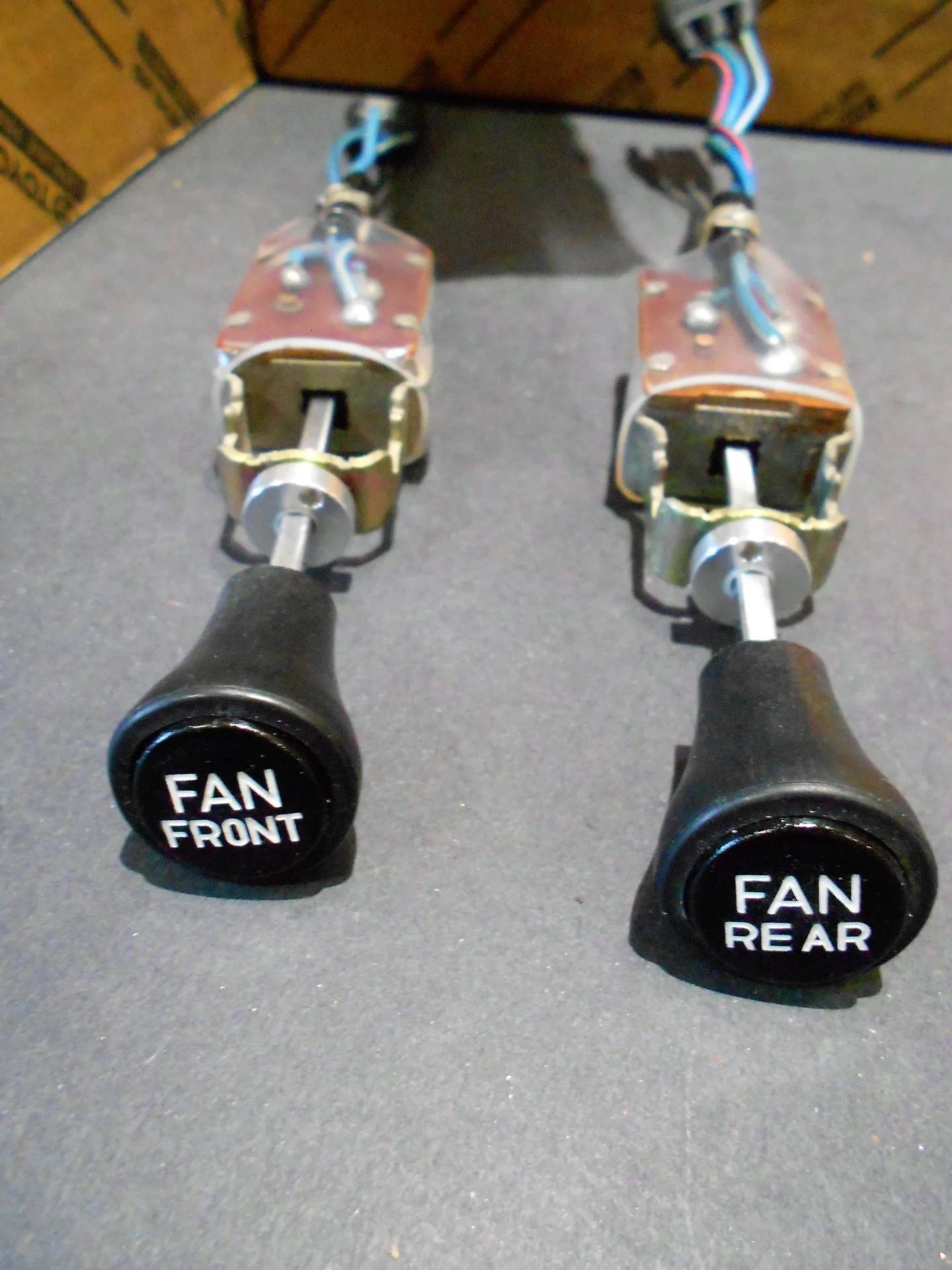

now for the wiring.
the pull slides the 5 contacts over the 3 contact plate. the blue/red wire supplies power to the switch. the single sided post on the 3 contact plate will slide between posts to allow power in low or high.
the white blue will close the circuit when pulled fully out. the blue black with close the circuit in the middle position. with it pushed all the way in the power tabs don’t contact anything keeping the circuit open.
i’ll hook my power to blue/red, my low fan to the blue/black and my high to the blue/white.
do some reason my front heater has the high in the middle position and the low pulled
out fully. i wonder if wires got switched at the motor because they really can be screwed up at the switch due to the connectors

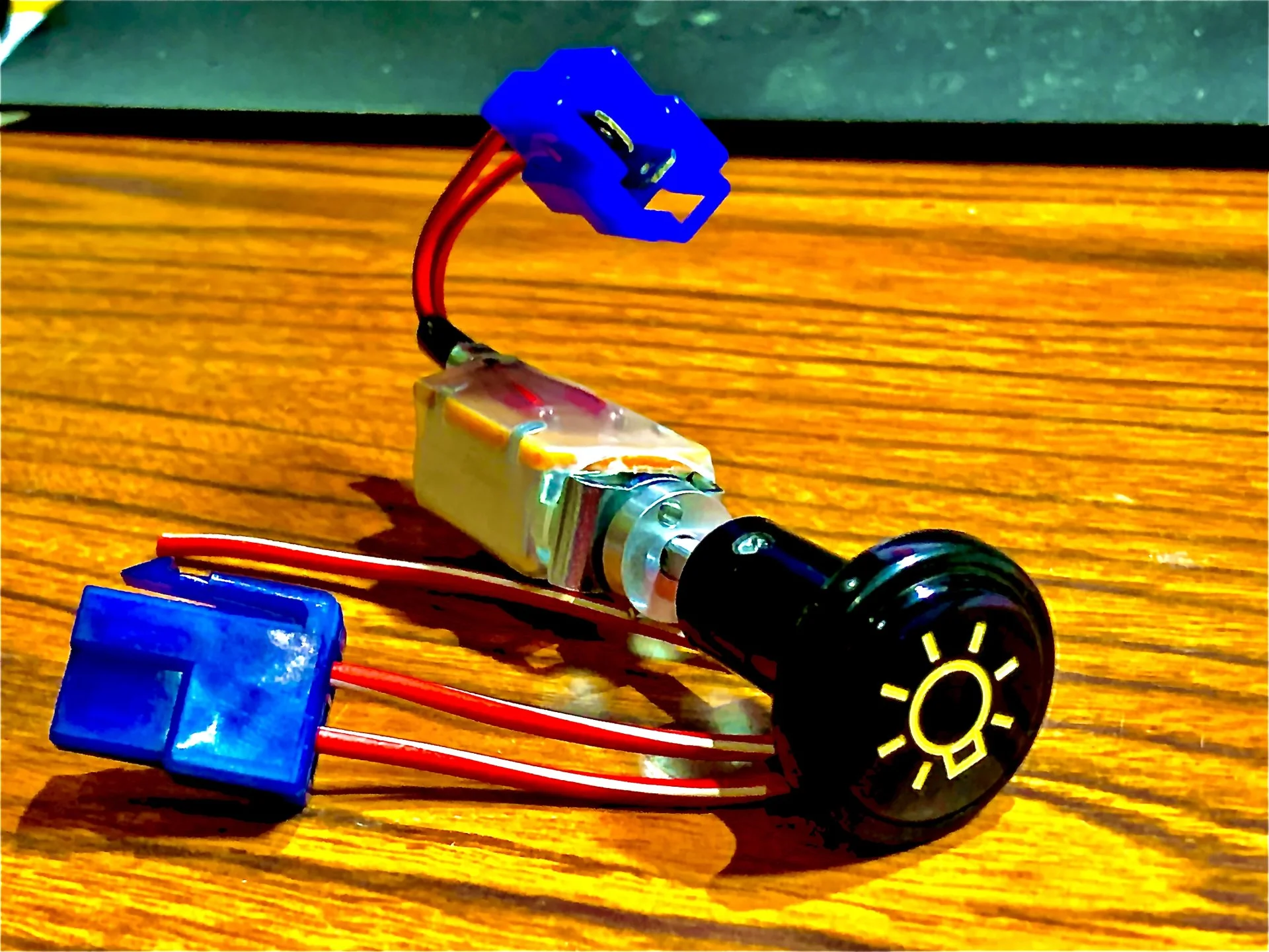

i now add the clear non-adhesive OEM YAZAKI made in japan switch wrap to ALL my switches , seems like a good safety minded idea , and i like safe ideas .....
ONLY HAZARD had the Toyota factory installed stuff ,,,,,from the factory ....PLANT A11
this kustom gal , was for @Curtice :cool:
i wonder if this was the first time , the OEM YAZAKI switch wrap was documented on motion media ? :idea:
