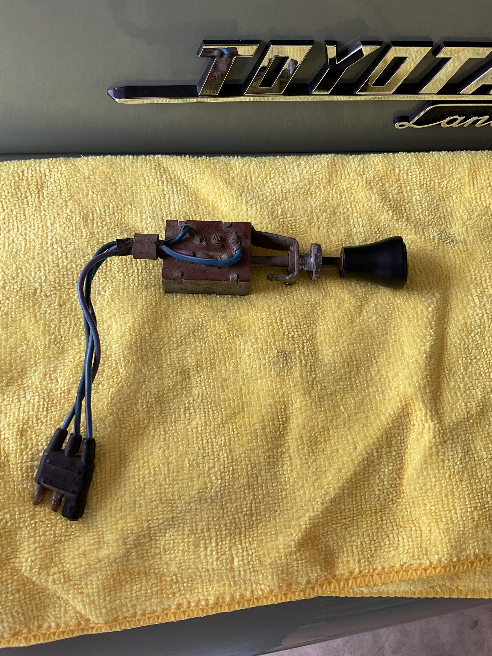

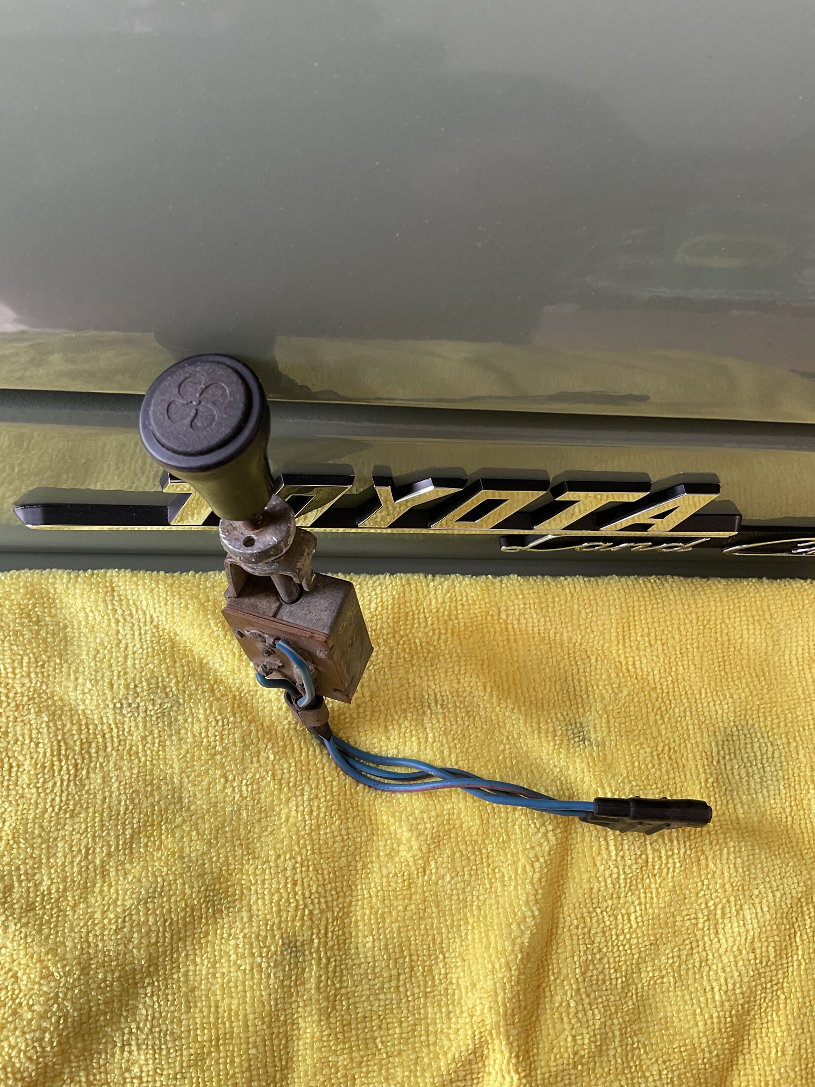

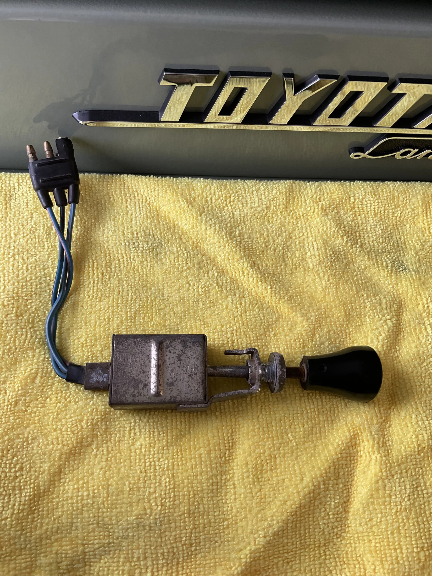

Can someone ID the year/s for the FJ40 fan switch ?
Thanks for the help.

Maybe a 1980 to 84??

The connector places this as an early 70s (pre 74?) switch with a later knob on it? Just guessing. The latest I have seen these style connectors is on the 73 "fan front" and "fan rear" switches. @ToyotaMatt

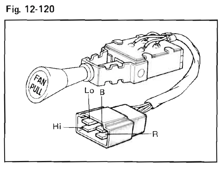

mid 70s chassis-body manual shows the 4 pin connector
