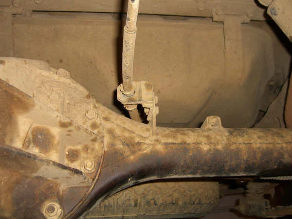

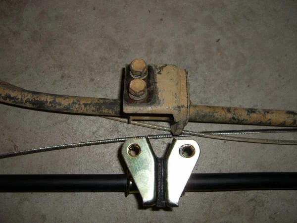

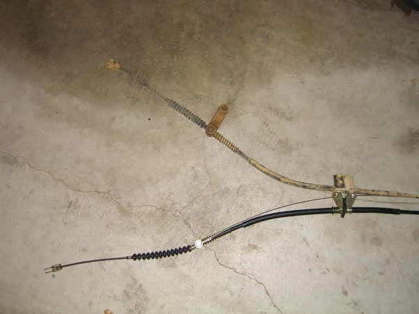

I'm replacing the dead E-brake cable on my 85 FJ60 and noticed that the new cable from the dealer has a different bracket design and hole pattern than my old cable. The first pic shows the old cable installed and the other two show a side by side comparison of the old and new cable. The bracket is the only difference between the two (other than the fact the old one doesn't work) and the Toyota dealer assures me that I have the right part based on my VIN. I'm sure I can make some kind adapter plate if I have to, but I'd like to know if I have the right part first. Let me know if you're run across this issue before or if I have the wrong part for an 85 FJ60

You might have the right part for the VIN but maybe the rear axle was swapped at some point along with the matching e-brake cable. I'd take both cables to the dealer and see if he can match it up to an earlier or later cable. Making adapters for new parts from the dealer should be a last resort IMHO.

i have a similar problem, swapped a full float in and the fj62 bracket looks like your new one, the full float like your old one. i'm planning to separate the brackets (grind off the rivet heads) and bolt them back together as appropriate. you just have to be carefull on the one you want to keep to preserve the rubber tab between the metal pieces.
if you find another part at the dealer that has the right bracket i'd like to know it, that would be easier and a new cable wouldn't hurt. i assumed it was a US vs rest of the world diference as the full float came from AUS

Could any 60 or 62 owners look under their trucks to see what type of cable brackets they have. I'll make an adapter plate if I need too, but I'm still trying to figure out if I have the right parking brake cable for my 85 FJ60. Since I'm spending the money on a new cable (that can still be returned), I'd like to buy the right part.

But, in pic 1, just to the right of the ebrake bracket on the axle, there's another bracket.
Just for fun, see if the butterfly mounting holes on the new cable jive with the mounting holes in that bracket.

I have replaced many a ebrake cable on a 60 series, and do not remember one having that style of locating bracket on it.....
