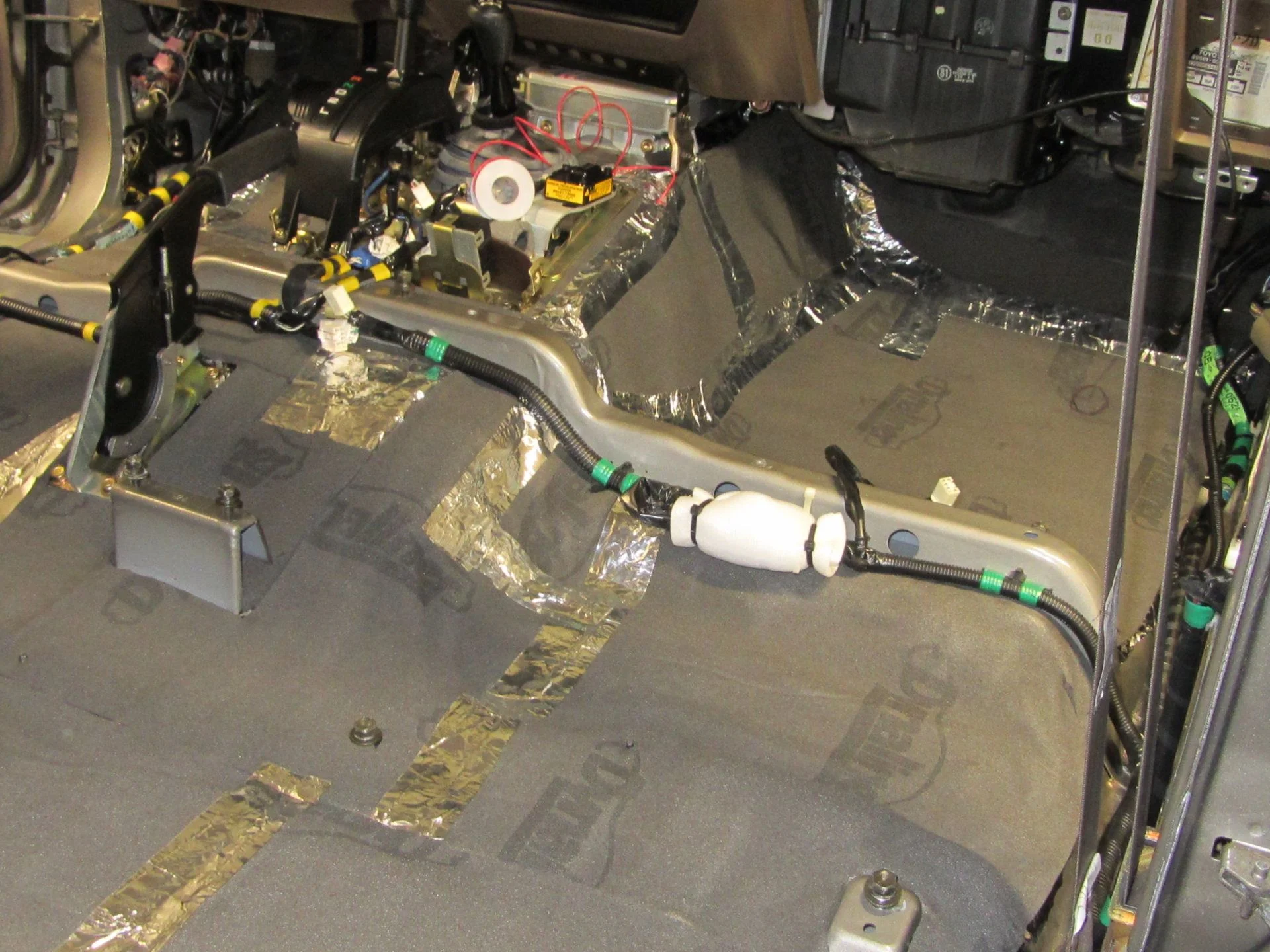

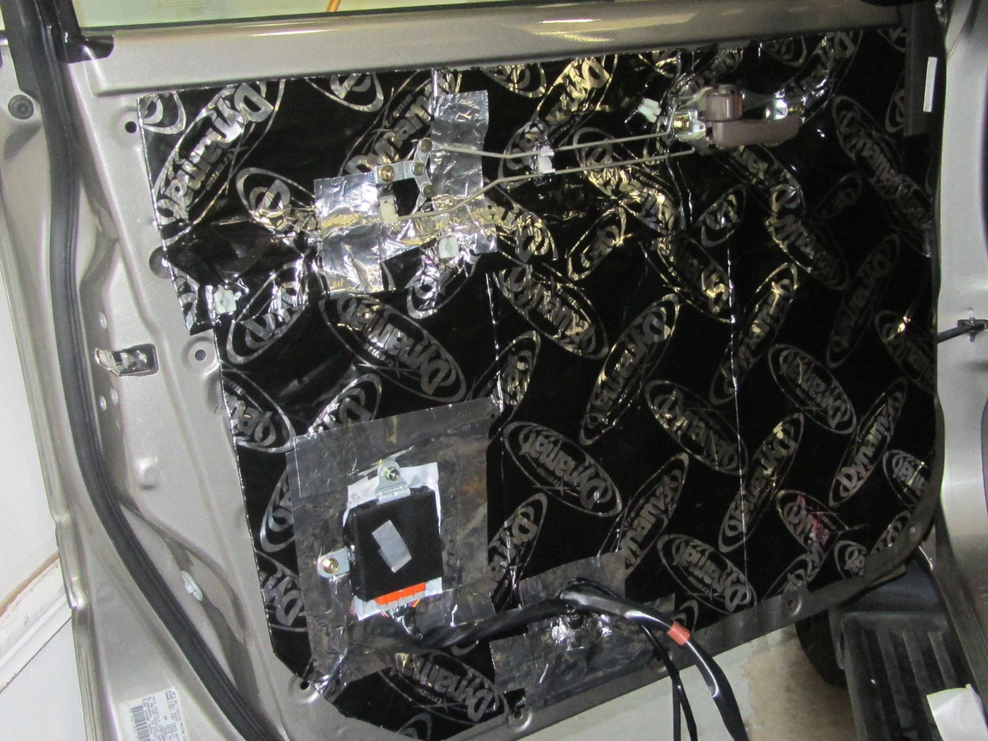

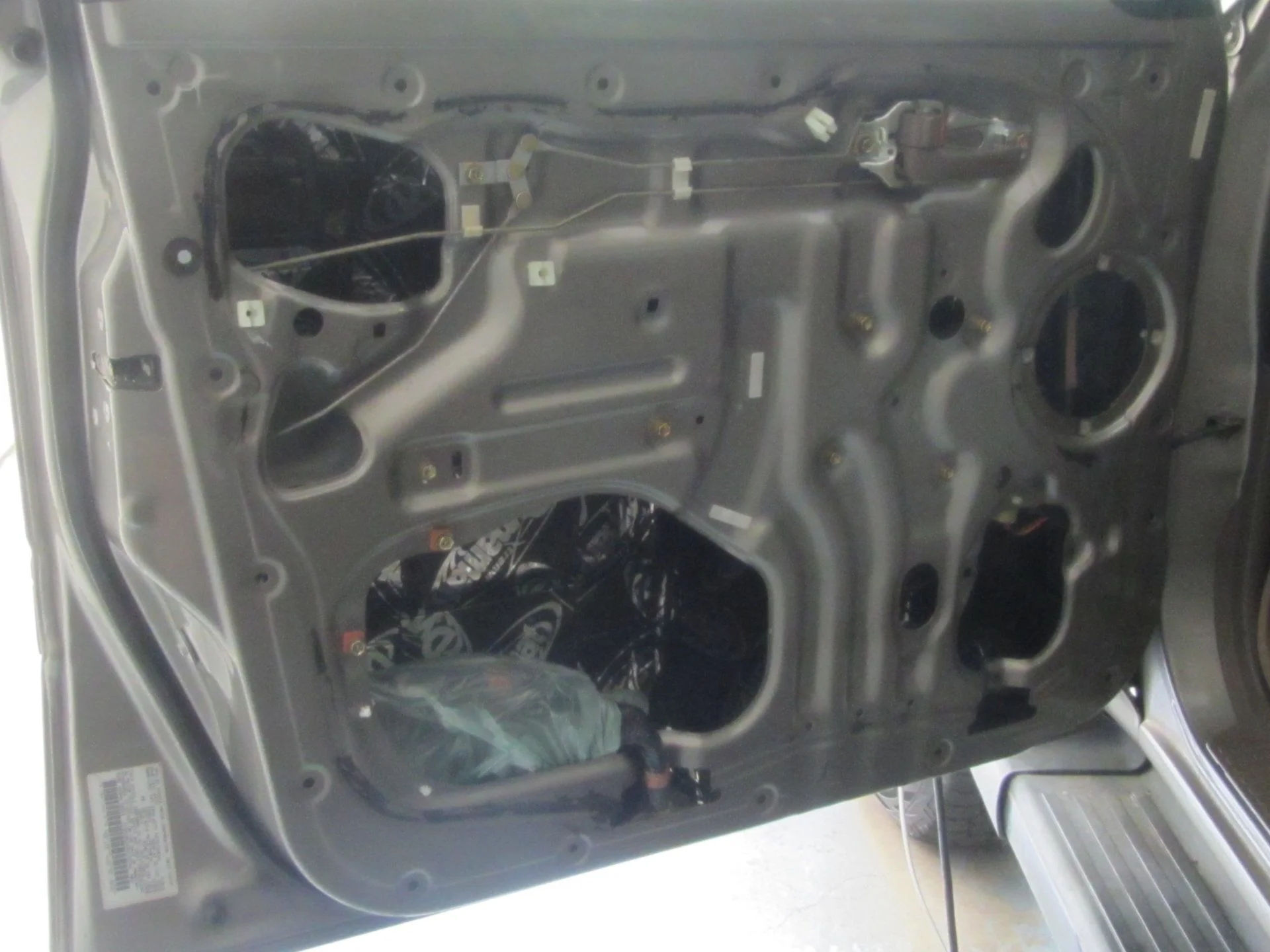

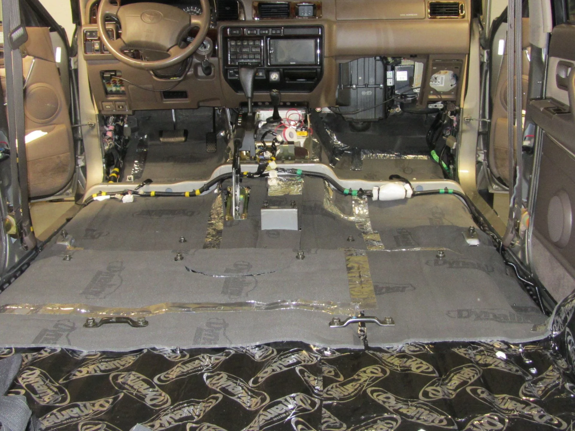

Last year I did the complete interior to the last inch. Both Dynamat and Dynaliner. The difference in both noise and temp is significant. A much pleasurable Cruiser to drive indeed. For the carpet, first I hosed down and then used a steam vaccum cleaner-took one day to dry under the sun but looked like new.
Since I also did some other stuff with an empty interior, but my best guesstimate would be 3 to 4 days...at leasure speed. Here's few pics

I did use Dynaliner in top of Dynamt. Different thickness depending the spot. For instance, 1/2” near and around hot sources such as cat (passenger feet), trans tunnel and so on. Then 1/4” for the rest. Ain't the cheapest but is good stuff.
