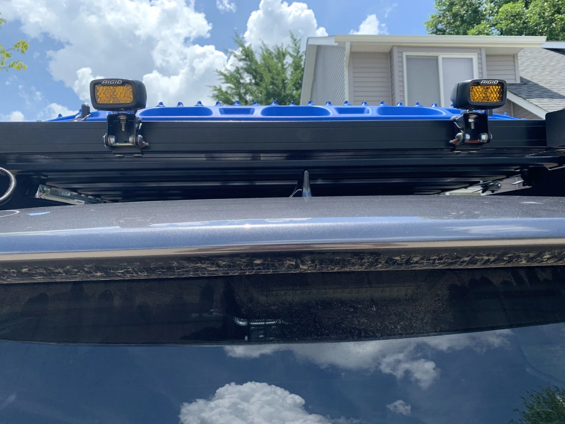

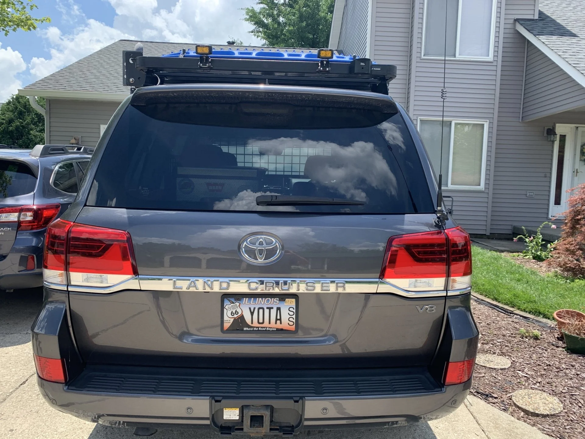

I installed these Rigid Lights on the back of my Frontrunner rack. Amazon product ASIN B07CG8F6M2. They have a High, Low setting. I have them connected to my Spod in the rear of the LC, running off my Aux battery. I have them setup so I can trigger them with my ARB LINX system. With the LINX system I can have the Low setting on and then the High is triggered when I put on my brakes.

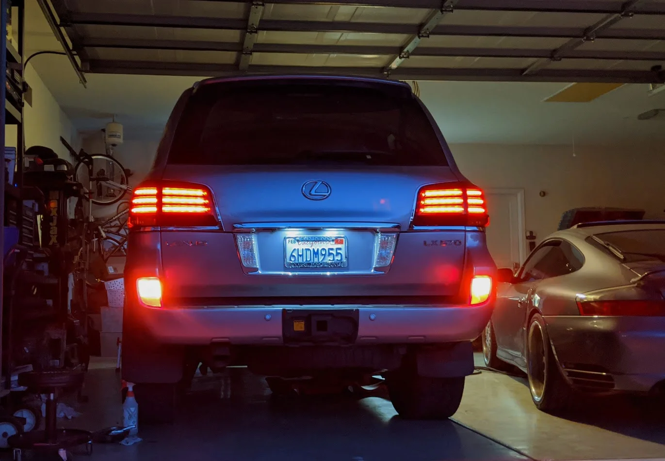

Here in the southwest, I think they're a pretty important thing that's not often discussed. Following behind my off-road buddies, some in 700hp Raptors, trailing dust clouds are not uncommon. It's thick enough to be blinding when following close. Rear mounted dust lights really do help visibility and glad my buddy has them. Which was my inspiration for adding rear fogs like @TheIcemanCometh commented on.
Likewise in the central CA valleys where Tule fog is not uncommon, I also wanted the added safety of rear fogs.
I added functional bulbs to the rear fog fixtures for the two reasons above. I find it also useful for rear illumination at night when setting up camp. Not as cool as aftermarket lights but it suits my low key build.

Amber on the yellow side. LED. On the roof rack. Baja Designs. Mount them as high as possible with a negative angle about 1-2 degrees. They are very important when driving in any sort of dust....
BD S2 Pros on the rear of the Eezi Awn K9 using Eezi Awn mounts. Controlled with the sPod. They're amazing and highly functional in dust (especially the Mojave/Death Valley variety). A single dust light would be more than fine which is what I had originally. I later added a second for symmetry, lol.
