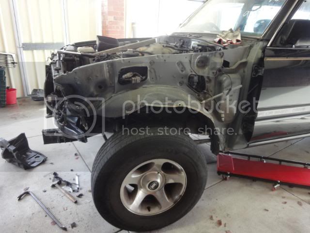

a member is looking to buy my right/passenter front inner-fender. after some confusion about it not looking removable... it seems it is removable if the veritcal member which is acting as the passenger side wall of the engine bay comes with it (see attached).
so my question is, can the truck still be slightly drivable with this removed? (i need to be able to get it out of a garage and onto a car carrier then off the car carrier to an LC shop for them to work on my project) or would you say he needs to bring his rusted out piece so we can 'swap' and he gets my rust free one and i have "something" to keep the engine bay intact for 200' of driving?
thanks,
hak

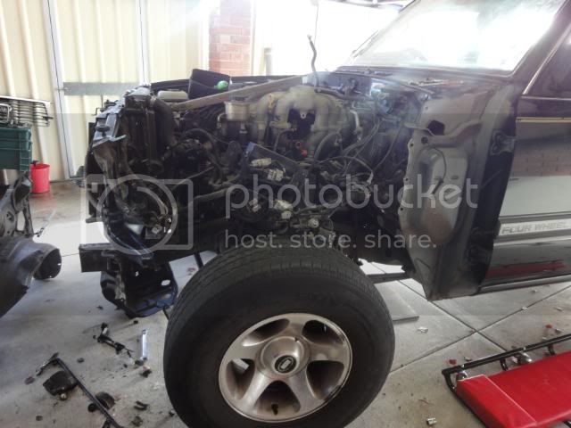

Borrowed a mock-up engine and trans, sump is missing but we are getting some new sumps cast up to suit.
Engine sitting roughly in position, 4” exhaust is going to fun to run! I will probably need to move the radiator back towards the engine to fit all the coolers in, I will have a custom radiator, aftermarket A/C condenser, trans cooler and A2A aftercooler.
