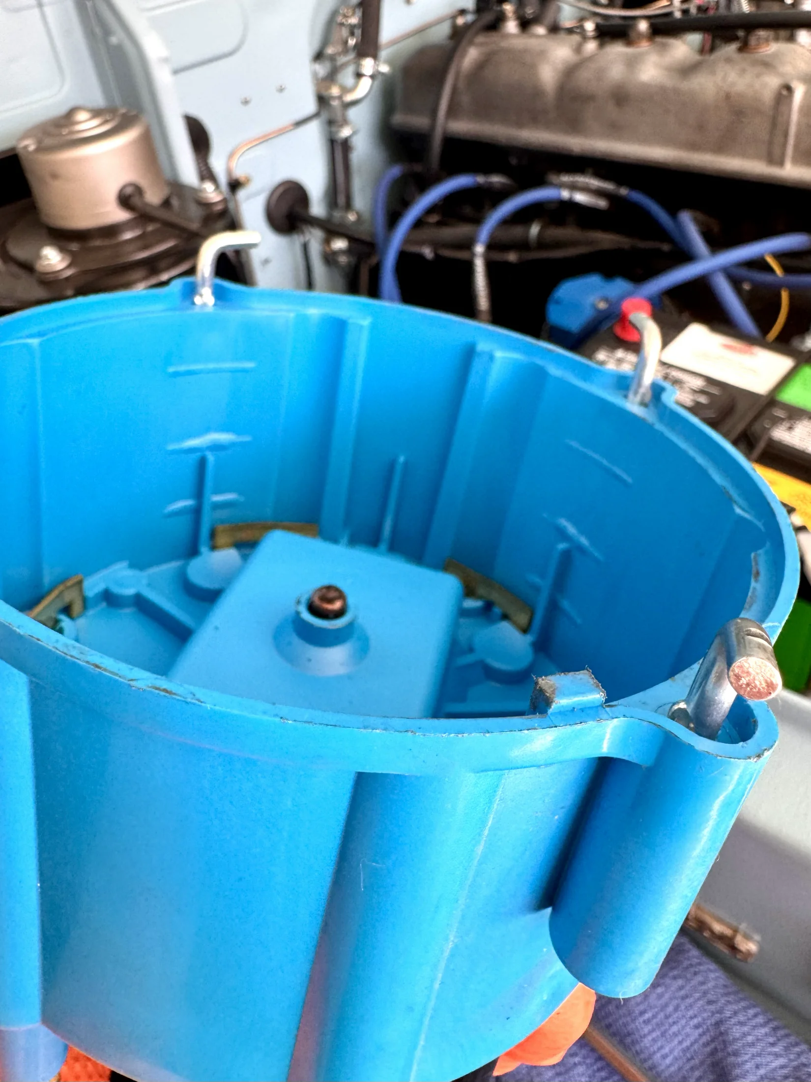

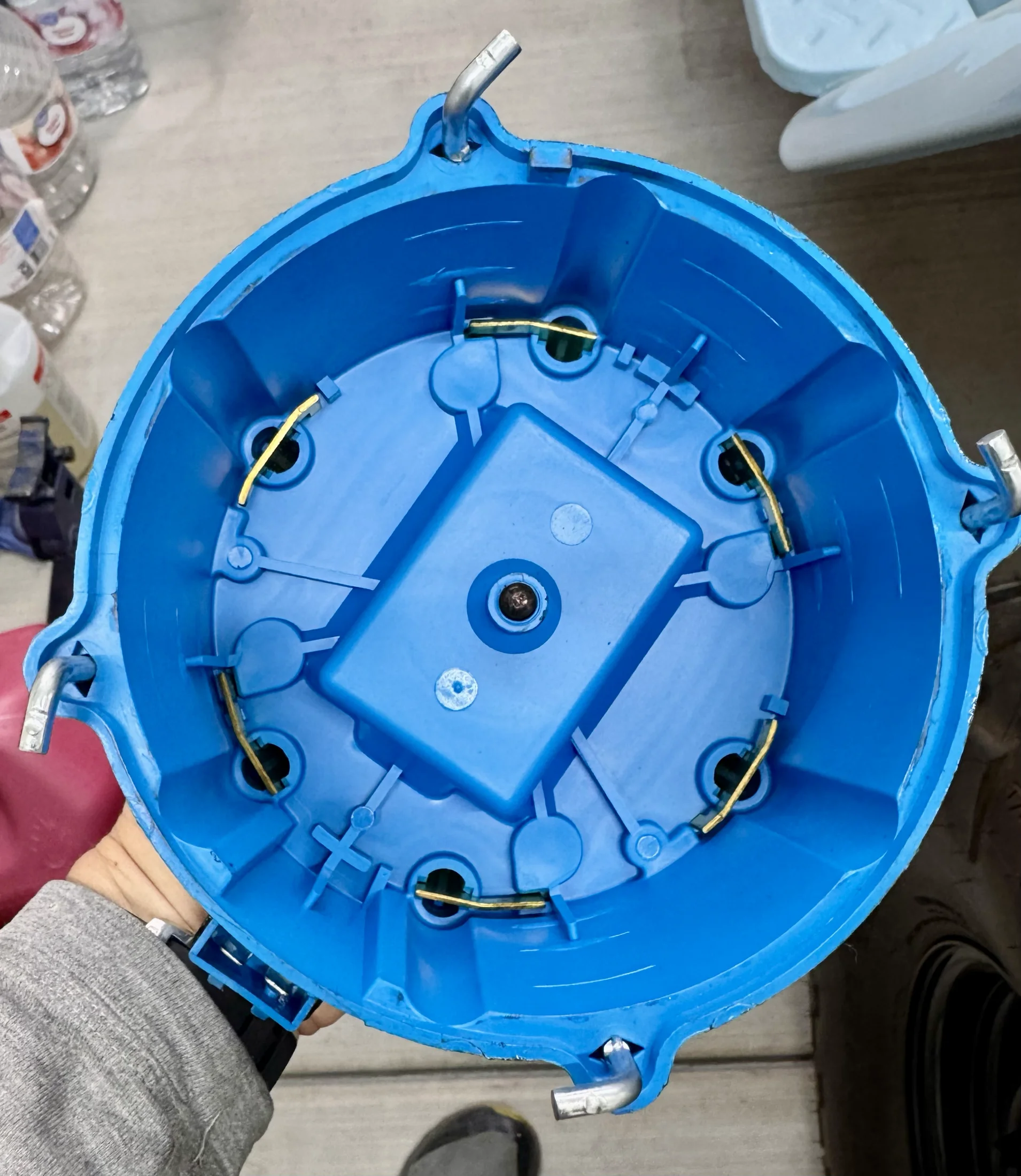

Pictures of the cap for reference with the tab to locate it in the housing
here are pictures of the distributor and the 2 notches: one at 11 o'clock and one at 1 o'clock - of course, I chose incorrectly :bang:
Simple enough to move the cap but that means pulling the spark plugs, resetting the timing etc etc
Hopefully this saves someone the headache
