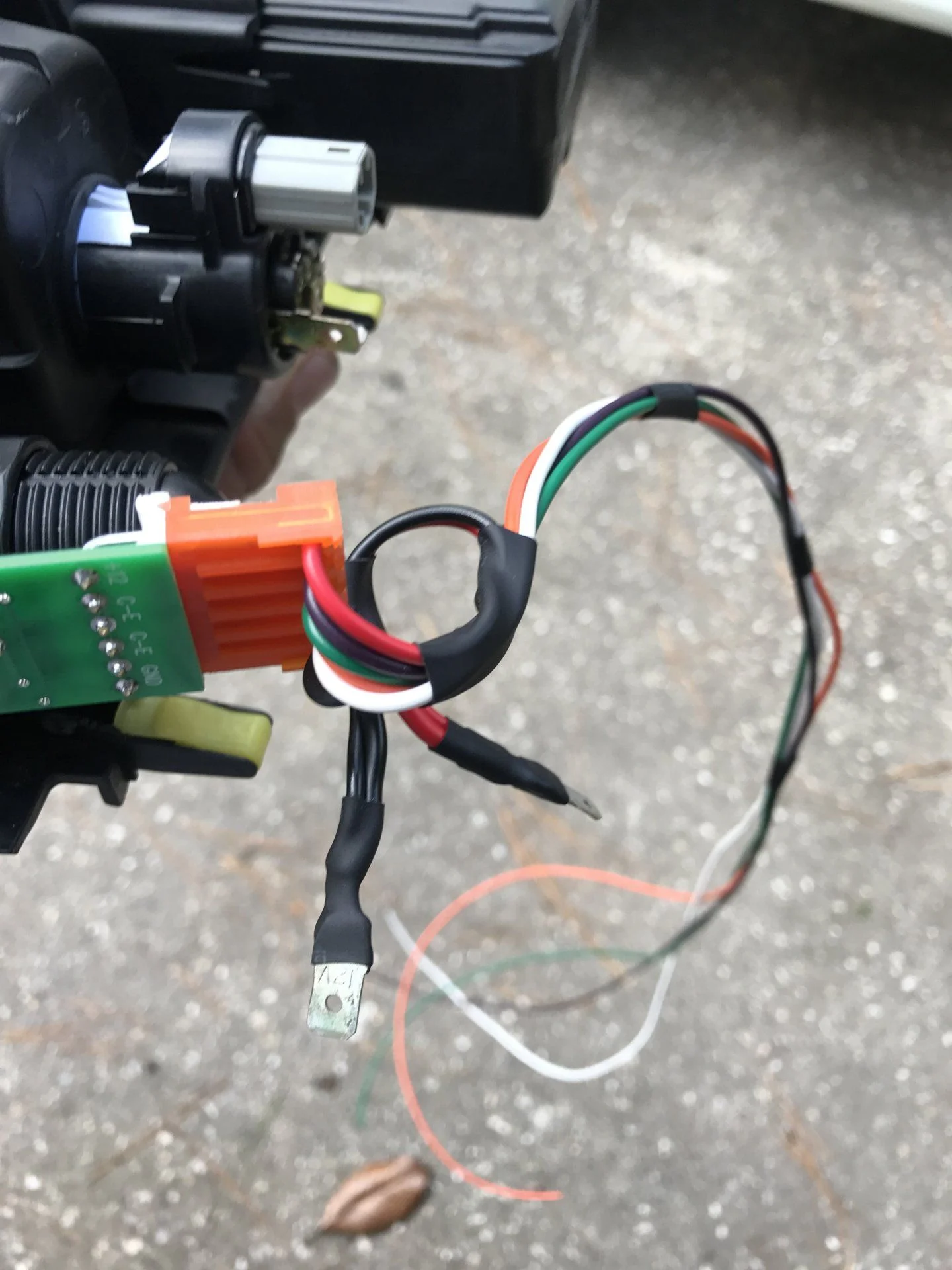

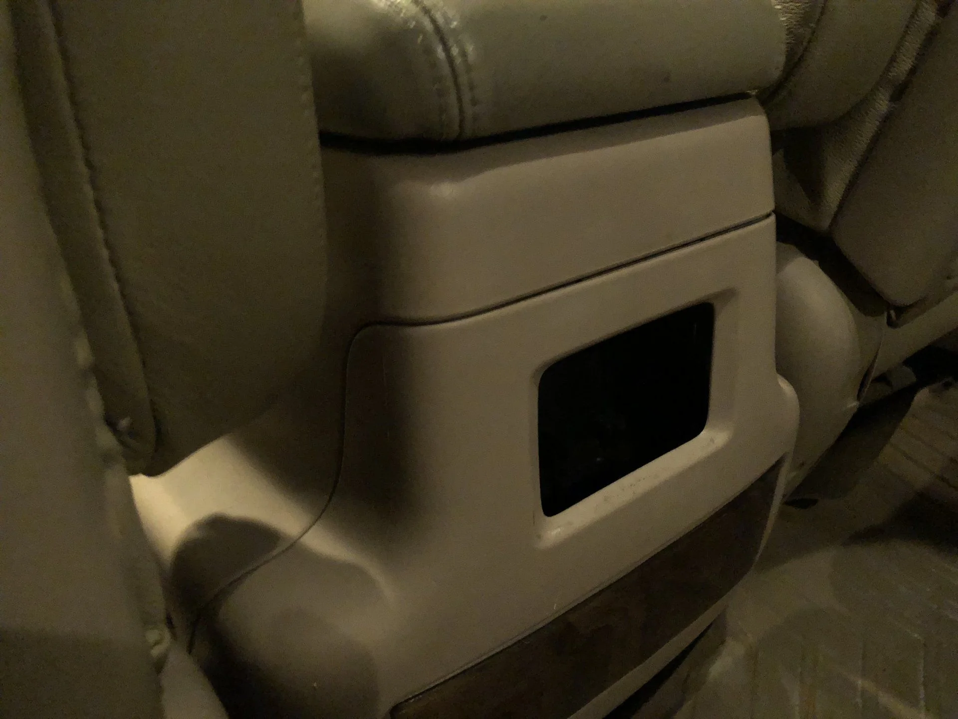

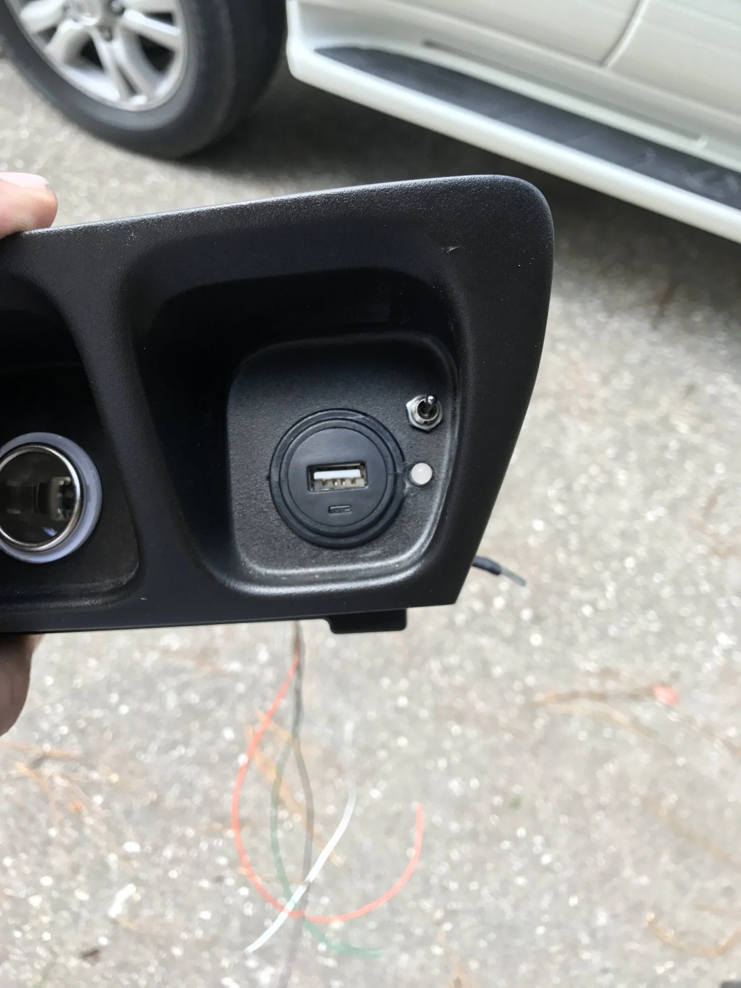

Ok so this was easier then I thought it would be. There are two screws beind the cup holder. Take them out first.
I didn’t.
See picture 1.
I used about 12inches of wire. Any less and the install would have been a pain in the ass.
Clamped it on and tucked it in.
Black to black.
White/black to red.

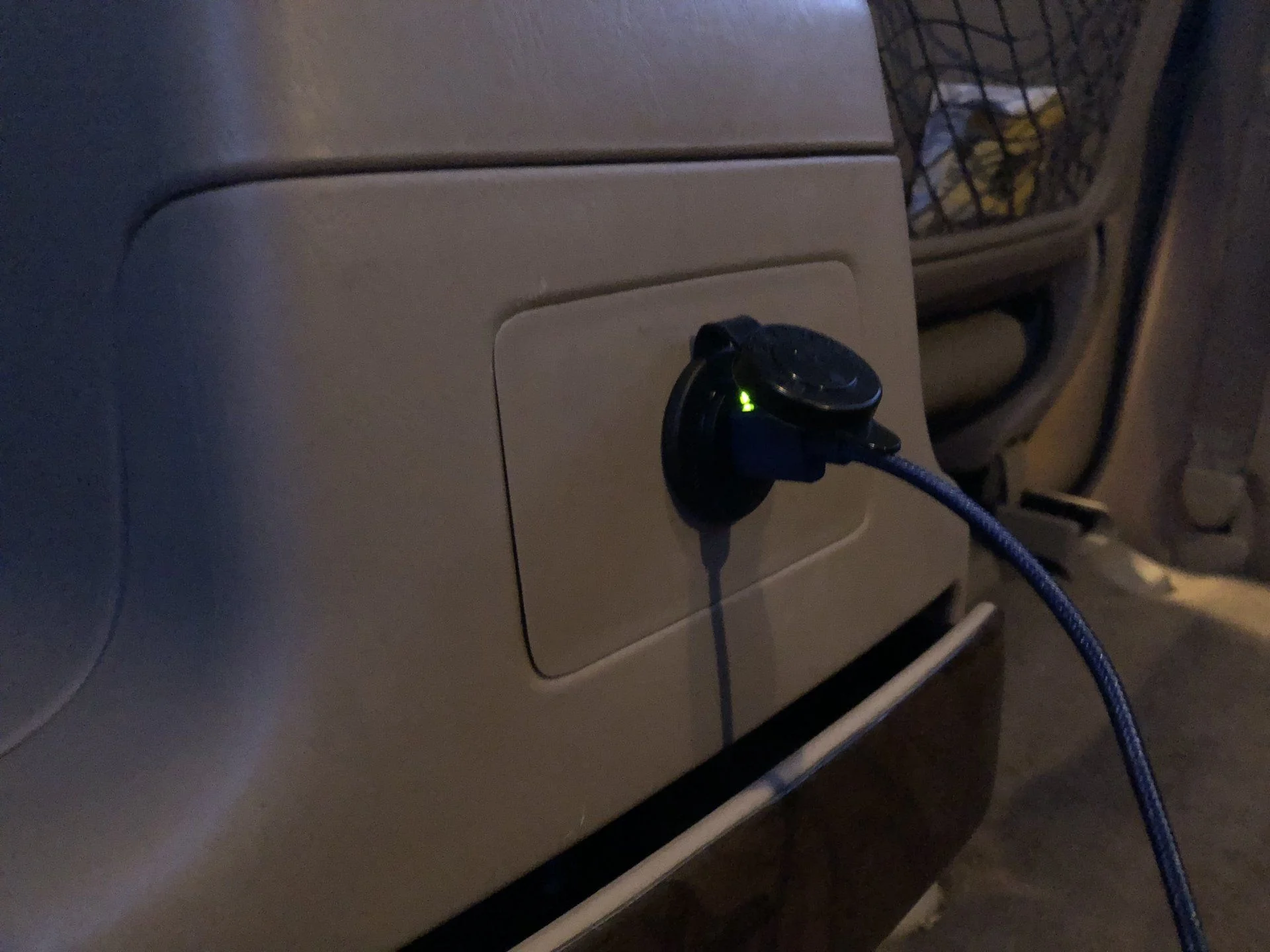

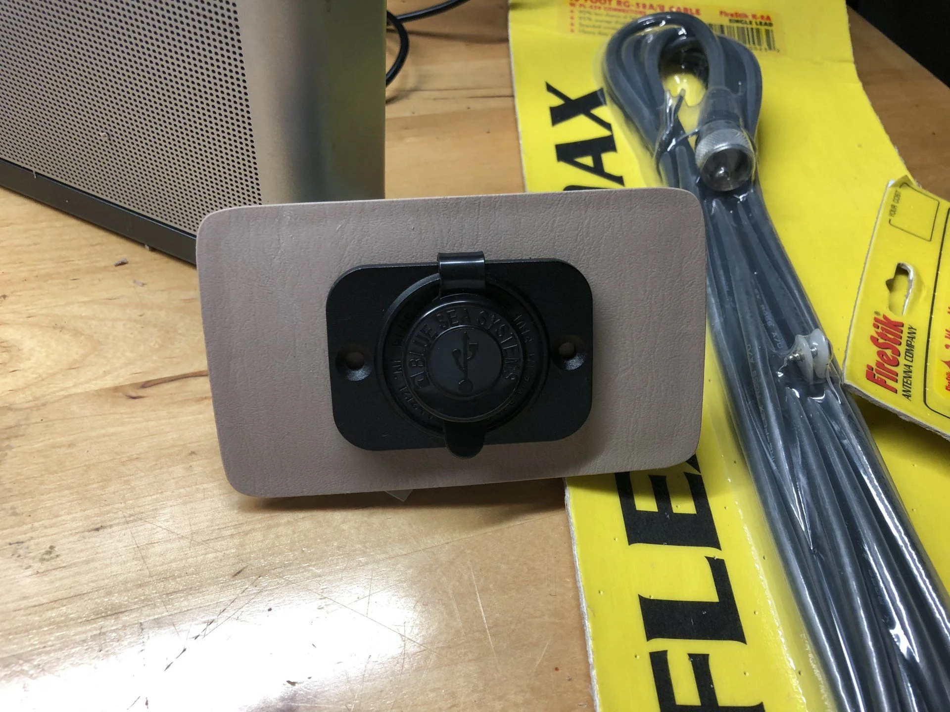

Works great. Don’t forget two small black self tapping screws for the mounting plate. Not illustrated(need screws).
Not impressive for those out there that swap out steering racks. But it’s a start.
And it works.

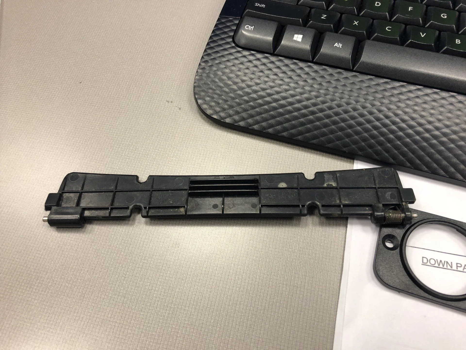

Though I may have broken my cupholder

The cup holder is probably hitting against the wiring you just added, if you can, try to tuck the wiring around the edges of the trim so it avoids the path of the cupholder.
I tucked the wiring in actually.
Just can’t figure out where this piece goes. I know it has something to do with the cup holders spring back feature. Going to look for a schematic online today.
