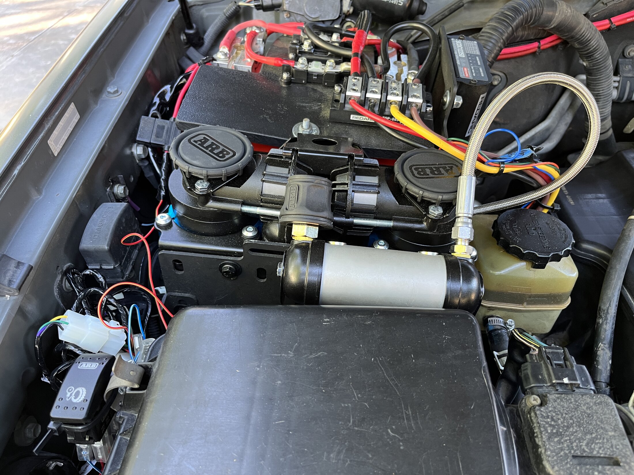

I installed a slee dual compressor/battery tray today. I’m coming with with zilch on pictures of where people are mounting the external manifold. Can people please chime in with photos or tips on where they are placing them? The picture slee has on the site isn’t even if the modern dual compressor. I currently used the side of the fender just to place it somewhere but there’s only one bolt on the top mounting leg, would like something a little sturdier.
Wasn’t fun though… very tight

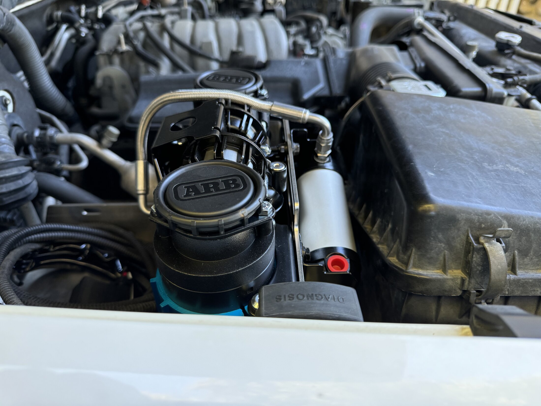

Off the top of my head I do not remember where I got that longer hose. I will do some order searching and see what I can turn up
ARB0740202
Fairly confident this is it. I did use a "90" fitting that I had in one of my old air kits

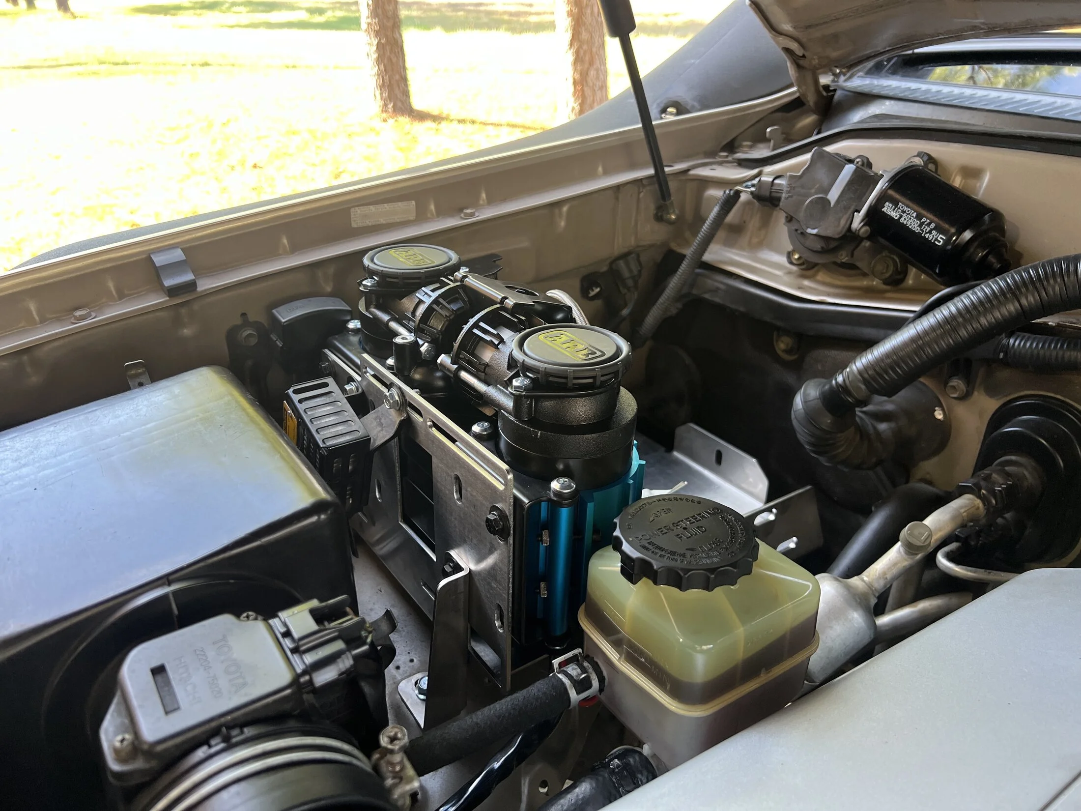

The hose was the reason I mounted it this way. Quite interesting: one of the most expensive versions of compressors and super short hose and wiring... my wires are short I can't even wiggle them around anymore as the space of the compressor and the length of the wires just allow a single position...
was a bit frustrating, but now it's installed ;-)

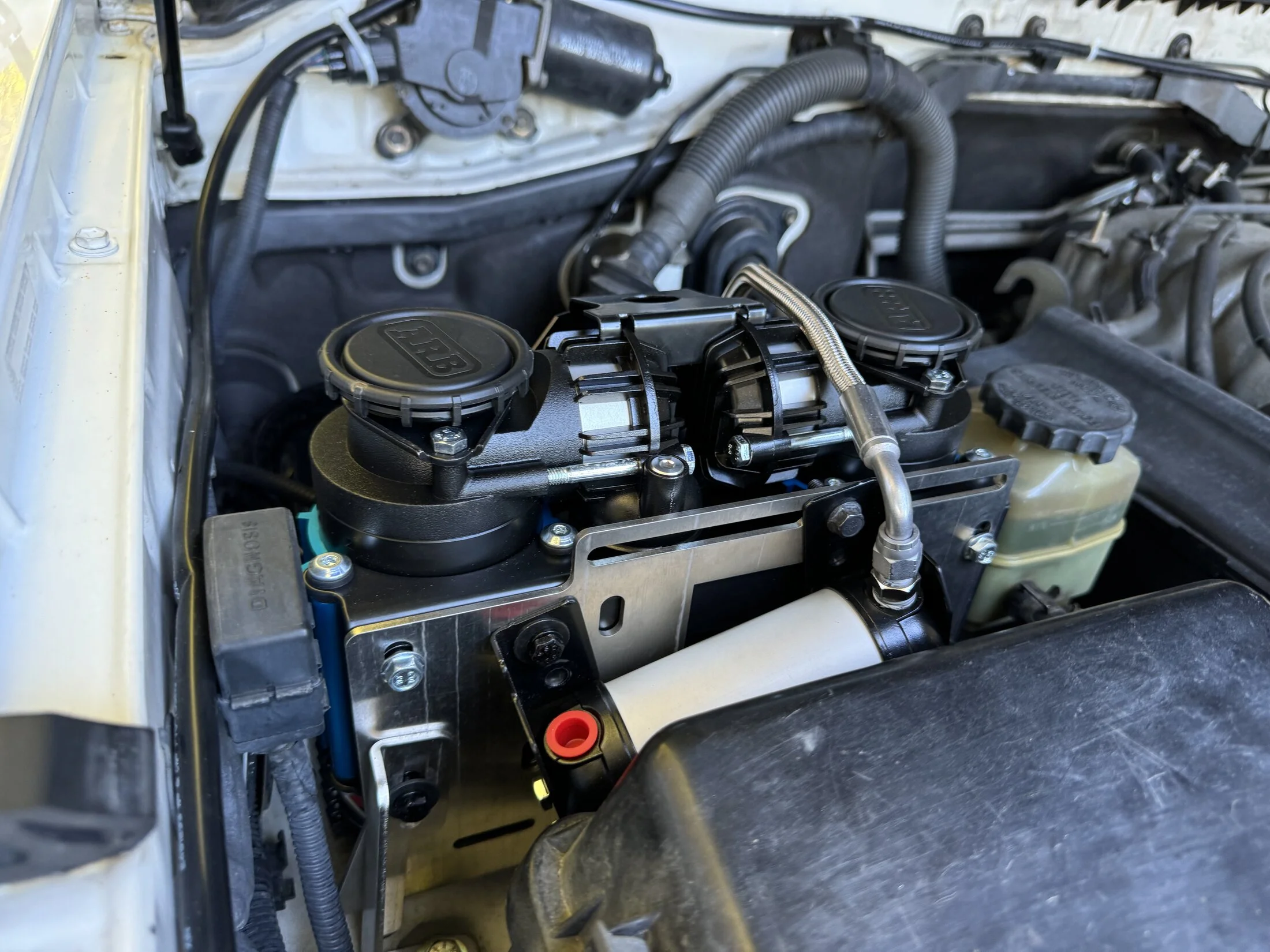

I wanted to chime in to this old thread to offer my findings with my install. I was able to get mine installed by only using the fittings from the remote reservoir kit and dual compressor. I had to slot one side of the reservoir mounting bracket and flip the brackets to face 'out' but the finished product for me was super clean, the arb branded hose wraps cleanly around the inboard compressor.
