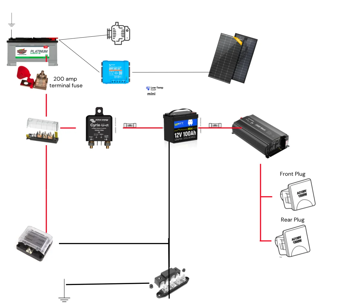

I’m approaching a similar system . I’m working to add a Lithium 100ah battery and inverter to a system that is already on a 100 series.
Currently:
AGM start battery - 200w solar and charge controller. When parked battery is always charged to float state voltage 13.8v fridge is wired in and always on to help keep drinks cold.
150amp alternator and Alt-S diode to bump charge voltage up slightly.
Adding:
Lithium house battery 100ah
2000w inverter
Victron Cytrix Li Isolator 120amp (13.3v batteries disconnected, 13.4 combined)
Basic diagram:
I get that a DC - DC charger would be a better choice but trying to maximize gains to the existing system with minimal cost (already have the solar charger controller system in place and always rolling off the system.)
I understand that with the AGM profile on the solar charge controller it wont completely charge the Lithium to 100% but I’ll be in the 90-95% easy and I don’t have an issue with that or lowering the lifespan of the battery as I’m going cheap on this test before a premium battery is purchased.
Other than the size consideration for the isolator/fuse/cable sizes.
Any other considerations while planning this out?
Thanks! 🙏
Dave
