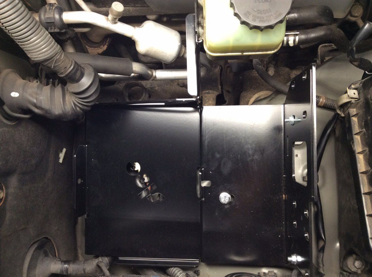

I pre ordered one a few months ago. It arrived last Friday. The wait was well worth it. I installed the battery tray on Wednesday night. It uses the space really well, looks really clean and is solid as a rock. The added value of a place to put the ARB compressor just makes this a no brainer. I can tell there was some real thinking behind it. I felt it was about a :banana: job, but I admit I don't really know the scale.
Here is an overall view of the battery tray in place before the battery is in place.
Why don't you relocate the air-compressor somewhere? I personally prefer it inside the cabin so it won't be exposed to the elements. Putting two batteries together in the space of the OEM will leave things VERY crowded and prone to something going wrong in the long run due to rubbing from vibrations on dirt roads.
I agree. Lots of utility in a dual battery system for running your "house" loads. Don't let an add-on like an ARB compressor make you make bad decisions about your "house" electrical system.
Don't overthink the obvious. Having a dual battery system, isolated from the starting battery is great. You can run fridges, camp lights, hook into solar, etc.
Get a big battery and install it under the hood. It's safer there, and generally easier to install. Your compressor can be 1-installed anywhere, 2-downsized, 3-Slee's new mount looks cool, etc.
