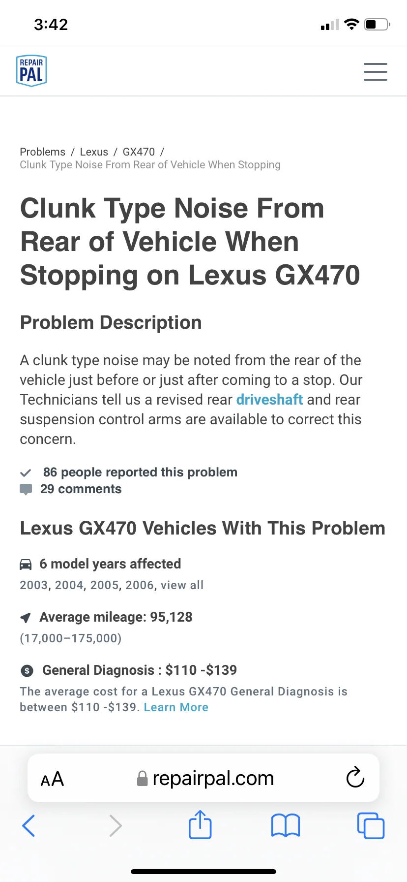

I did read an interesting repair blog like repairpal and they mentioned that the fix was both the upgraded rear DS and upgraded rear control arms. That’s the first I’ve ever heard that there were upgraded rear control arms from Lexus.
Interesting about the rear control arms. I can't tell for certain where my clunk is from but it does seem to feel like the front. I have not replaced ball joints or rear control arms. I may look at the ball joints soon. Given that I have coils in the rear, any mention of airbags don't apply in my case. I need to replace the panhard bar, but I doubt that would be the cause of the noise.
I have not had the opportunity to run the rig through tests recently as I have been working, which means I am towing a trailer. Not the best setup to figure out "acceleration from a dead stop" noises. However, I dont seem to hear it since I changed the front end diff fluid. No idea if the two are related.
Very interesting on the rear control arms as well. I had the clunk as well, and greasing muted it slightly. When I lifted my GX and did a coil conversion I also replaced all of the rear control arms (upper and lower) with Moog arms ($130 for all 4 on Rock Auto) and haven't had the clunk since! No idea if it was the lift/coil conversion or the rear arms, but the rear arms are cheap enough you might want to try it. I had not put 2 and 2 together until I read this thread.
