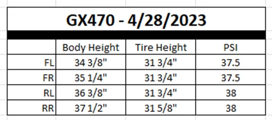

Requesting how you'd approach this. Measurements taken today are shared below - you can see the deltas for the two sides of my GX.
"Body Height" simply means measured from floor to a specific body panel seam (all measurements taken from identical points L vs R sides).
Suspension components in my signature...installed ~30,000 miles/5.5 years ago.
I'd like to get FL/FR and RL/RR evened out but don't know the smartest approach to take (hoping there's some simple "do it this way to make it fast/easy" wisdom someone can share).

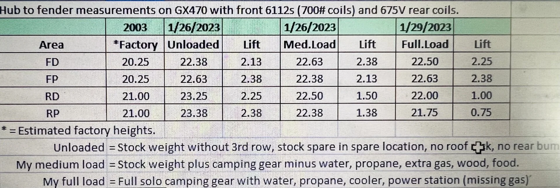

I’ve measured my hub to fender heights like 100 times over the course of 6+ years. All measured in my driveway at home.
That’s the more typical measurement to eliminate tire size when comparing lift heights.
I can tell you that my 2003 gx470 measured differently depending how I turned the wheels when I parked, which direction I parked (forward or reverse), gas tank fill level, cargo load, etc. I think if your rear diff shifts to one side it impacts ride height.
So, try reversing the direction of how you parked and measure again. See if your numbers change by 1/4” all around.
Also, there’s a well known driver side lean that should be like 1/4”. Your numbers are a little bit higher than 1/4” but 1/4” is when measuring hub to bottom of fender lip.
Here’s my recent measurements under different loads
Oh and here are ways to fix the driver side lean:
1. Load more gear on the passenger side
2. Put a 1/2” spacer on top of the rear driver coil. I’m about to add a 3/4” Cornfed spacer on driver side and a 3/8” (10mm) ARB trim packer on the passenger’s side to help reduce my lean and give me a little lift in the rear.
3. Lift the front driver coilover 1/4” if the coilover is height ajustable
By they way, I have the eimKeith panhard correction kit PCK when I measured and this is supposed to help keep the rear axle centered when you lift. Uncentered rear axle can affect ride height from side to side.
It's normal. The battery, steering column, and fuel tank are all on the same side of the vehicle. But I'm interested to see what you end up doing to correct it.

The Foam Cell Pro shocks have a threaded body to allow for ride height adjustment. If you get the Ironman adjustment tool, you should be able to adjust the ride height and get it perfectly level. Mine were set to within 1/8" or so of level out of the box.
For the rear, there is less you can do (looks like you have a Metal Tech coil conversion kit?). I also have the Ironman rear coil conversation kit, which is also threaded and pretty easy to adjust and dial in. I'm maybe 1/4" off side-to-side on the back, which I don't worry about too much.
Yup and Yup - been doing some homework....I'll need to order the spanner wrench to adjust my front(s). I'll also be ordering some spacers for the rear (you're right, I have the MT coil conversion kit, no other options than to add spacers). Thanks for chiming in, I appreciate it!
@HomersCanyonero - I wasn't aware of the PCK - thanks for mentioning that. Ordering that as well!
