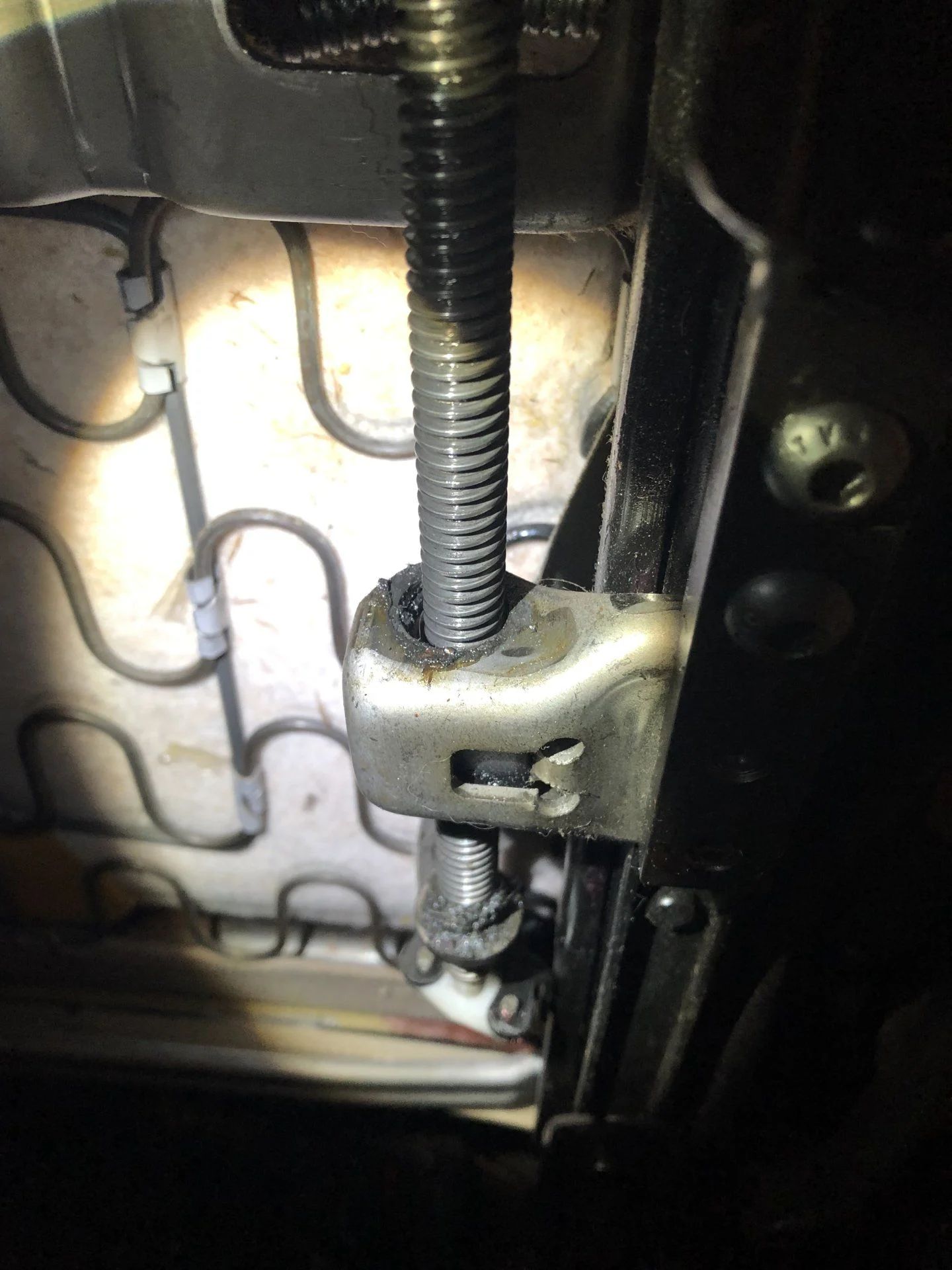

1996 LX450 - I've got a slight rock forward and back in my driver side seat. (Usually only notice it when coming to a stop and then accelerating.)
As far as I can tell this isn't the gear/cap fix. Picture is attached. Where the shaft goes through there should be a plastic bushing that holds the shaft in place and it's worn out. Anyone else seen this? Anyone know where I can find a new bushing?
Blue circle is where the bushing is worn out and you can feel the seat moving back and forth. Red are the end stops that can't be removed. Maybe it's necessary to replace the entire splined shaft?
I would be inclined to buy a used motor/track assy from a salvage place.
@arcteryx
@slow95z
Looks like I over analyzed this. Once all screws were re-tightened the seat is no longer rocking. Will be on the lookout for a salvage motor/track just in case I need it in the future. :) Thanks!
