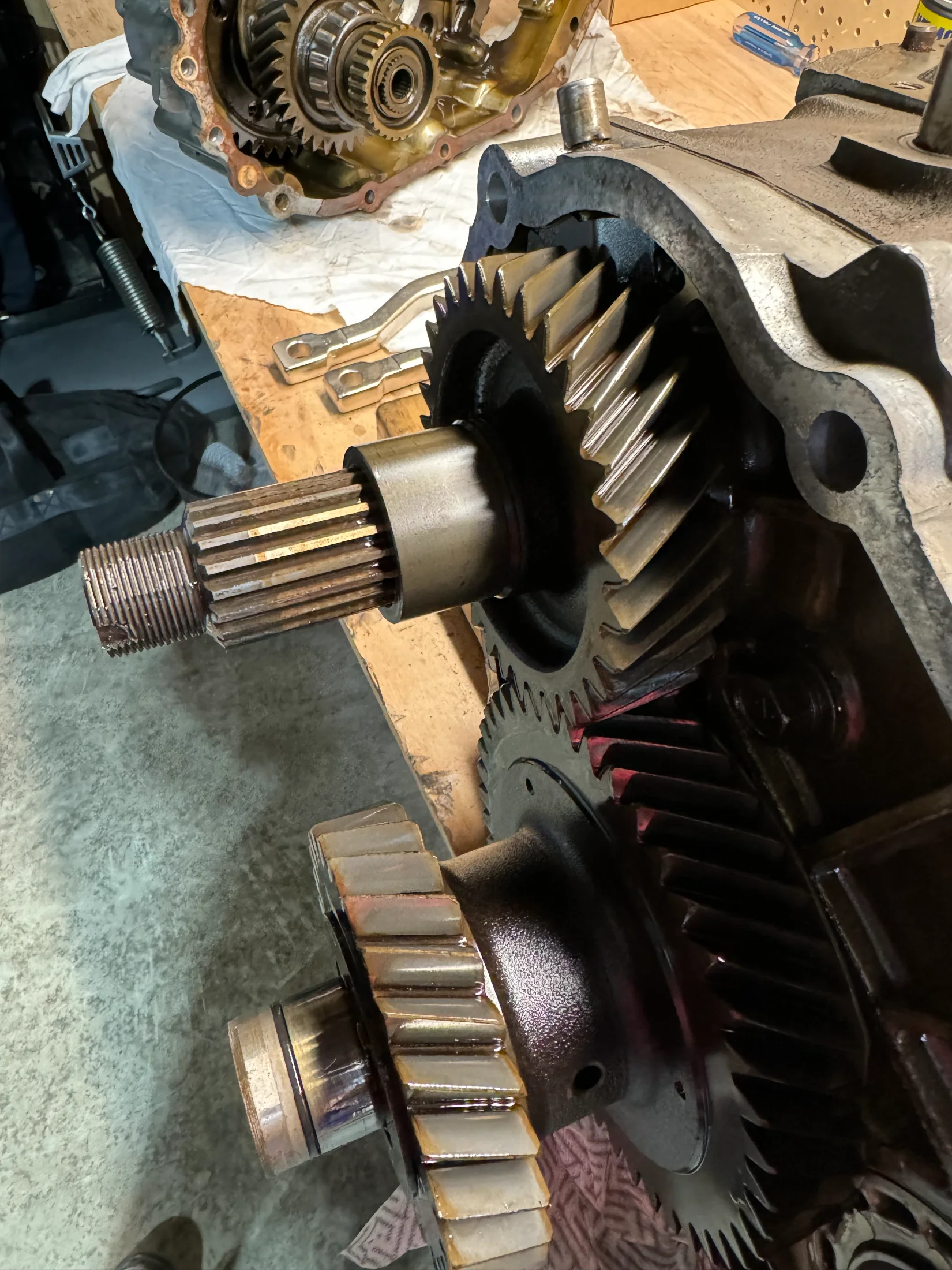

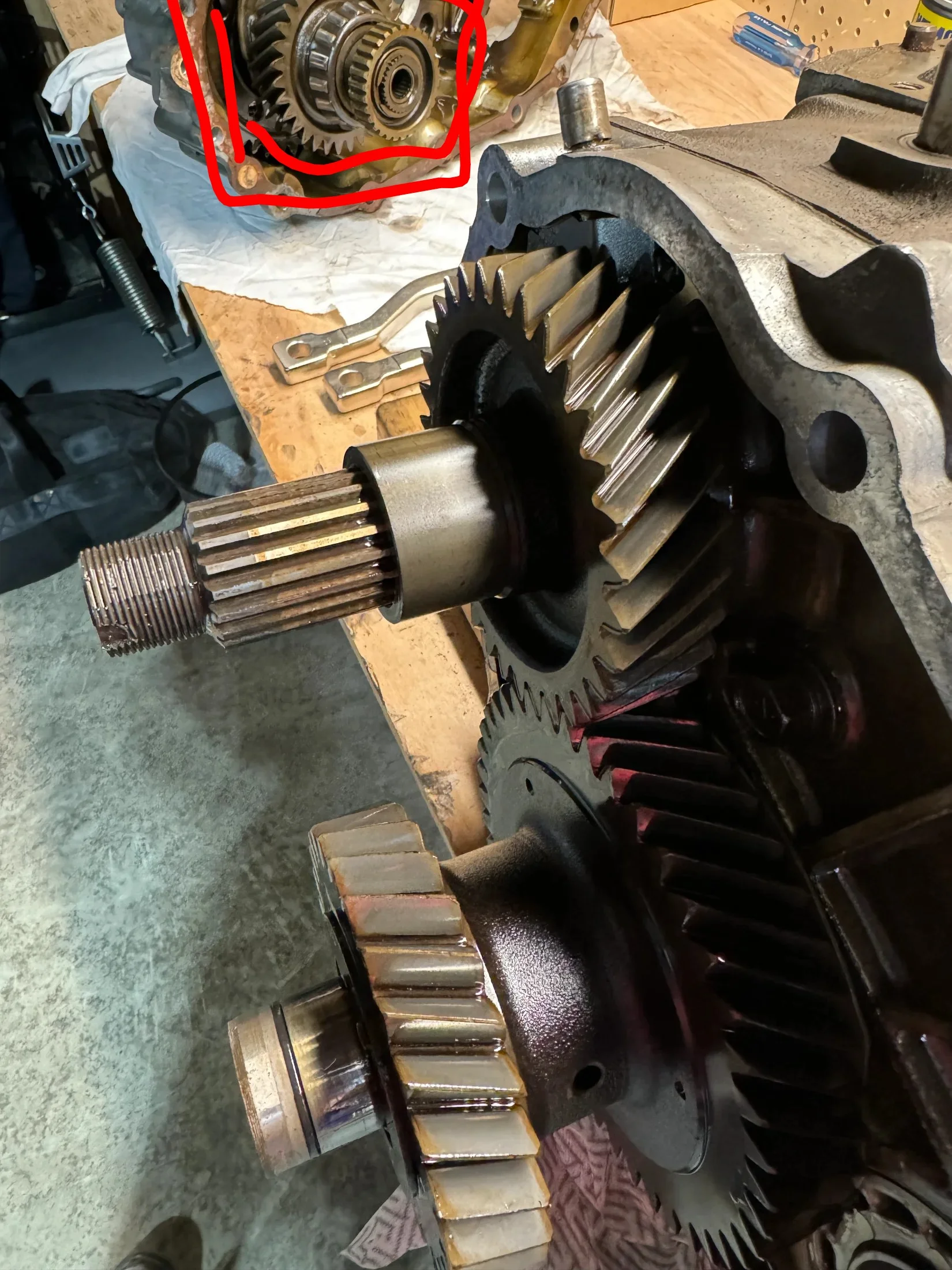

Did you rebuild your A440 transfer case onto the H55? Did you happen to take any pictures of the inner splines of the transfer case input gear?
No, I rebuilt the transfer case that was already behind the H55 from the donor truck. I took lots of pictures while taking it apart, but not going back together. What were you thinking might be the issue GLTHFJ60?
I think this is the part?
Do you have pictures of the gears when taking it appart ? Splines on the input shaft? Output gear bushings were good too?

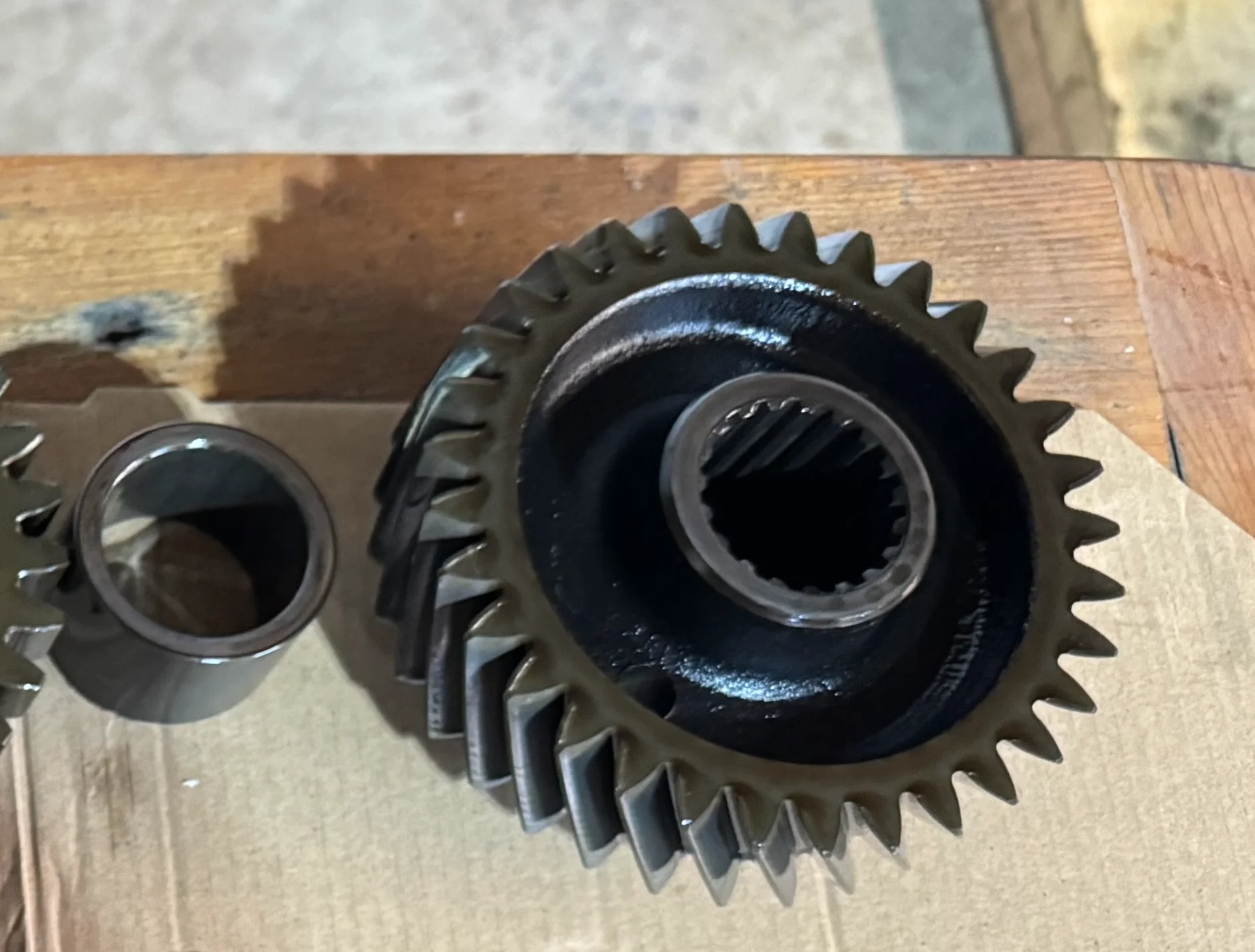

Here's what I was able to find in terms of other photos of the input shaft (I should mention I'm, at best, a shade-tree mechanic). I'm not sure about the output gear bushings. I would definitely have noticed the sort of play you mentioned you experienced ... everything seemed pretty tight when it went back together, but I can't be 100% sure. Any red flags on these pics?
Some noticeable wear but not bad IMO ... Not even close to cause a clunking noise.

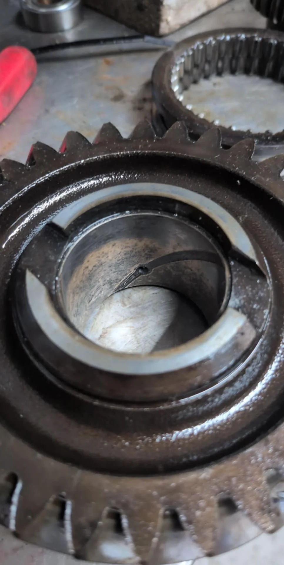

That's the gear I had (still have ) trouble with
The bushing inside was very worn .
Caused a rattle sound .. not muck of a clunk ....

The splines on the inside of the transfer case input shaft can wear out, and that will cause a clunk. From the pics you shared, that's not your problem.
