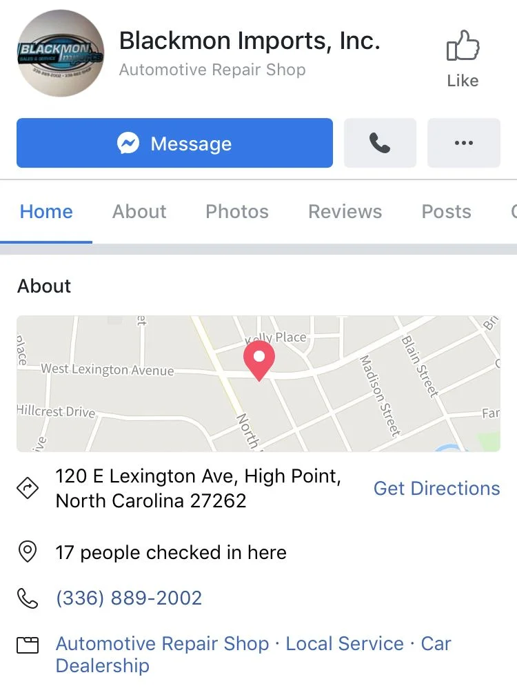

That said im in between RDU and Kville and could possibly help. But if you have the grease and gun then your pretty set to apply. Also if you have the time and wish to order the part in advance blackmons imports in High point could probably swap it out for you and separate/clean/lube the shaft at same time. He is cruiser friendly.
