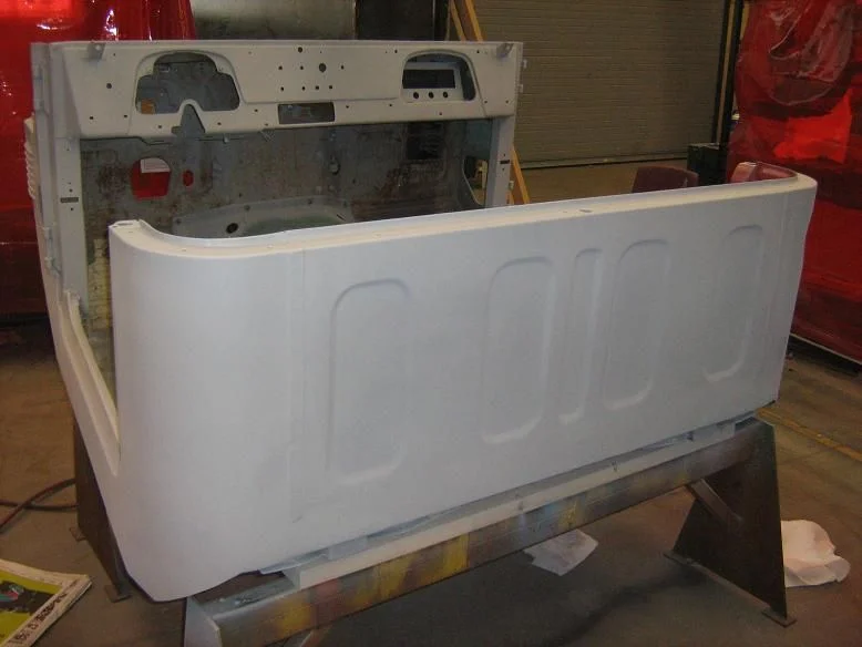

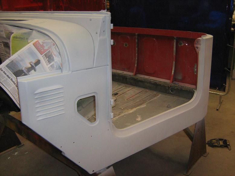

I used a two part epoxy primer to seal the body. I used a flap wheel with 120 grit to strip the paint, filler and rust off of the cab.
In the second pic you can see the hidden deck in the glove box. I am going with a dashman box so I don't need the space. That, and i have a factory blank out plate I really wanted to use.

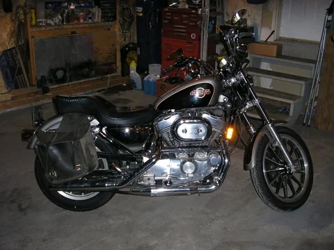

Just a bit of snow eh? My brother missed x-mas here in Calgary because the Vancouver airport closed as he was sitting on the runway. I've got 5' tall snowbanks on either side of my driveway. Hope your going to tarp that up nice - it's too pretty. I tried my first automotive type paint job this past summer and sprayed my Harley in the garage. Great learning experience. Came out so well I think I'll spray my 45 myself. Great work Dr.:clap:
Looks like we worked in reverse. :) I am building the Harley next. I have too many projects on the go.
lol - yeah great mind think alike I guess. Heres my brothers sportster and my FLH.
