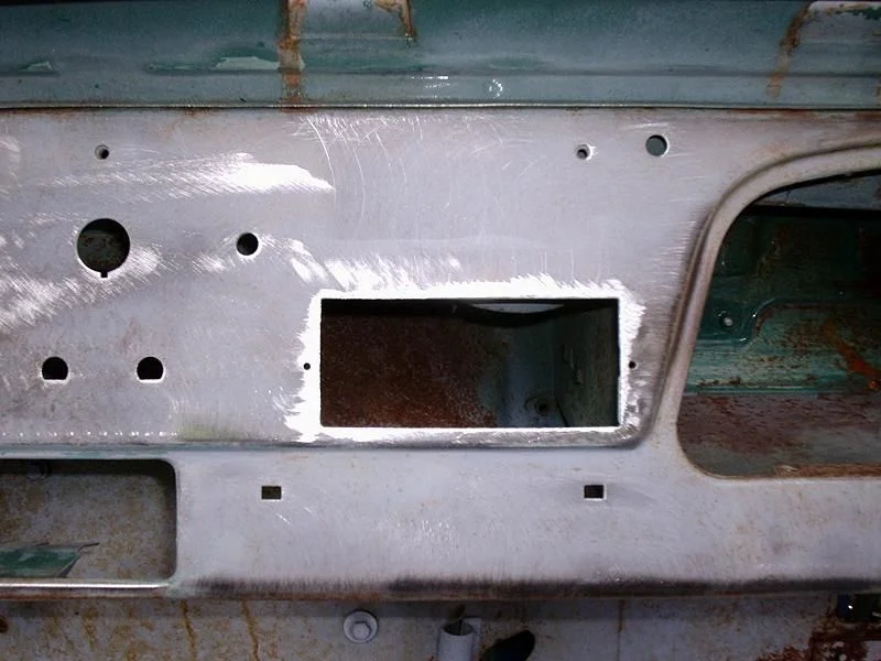

here are some more pics of stuff i have fixed, filled. There will be a deck in the glove box, maybe the amp in there too. The new plate on the dash will be for the sirius radio.
The spot beside the gauge cluster will now be for a autometer 3 5/8" tach.
