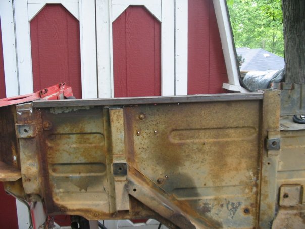

aight so here are some pics...

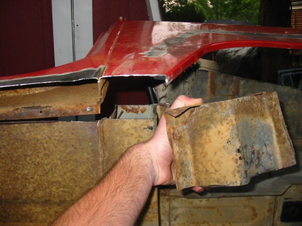

just to give you an idea of how much i'm cutting out of the tub at the b-pillar, here is the 4.25 inch chunk i removed
here's the rocker/doorframe and quarter panel after i drilled out all the spotwelds and cut it off the tub...it ended up being easy to just cut it all off rather than keeping it attached at the a-pillar
here's the tub after i cut off that stuff and some of the wheelwell. i'm hoping that i don't have to raise the wheelwells when it's all said and done b/c i am moving everything in 4+ inches and putting wider 62 axles so it'll be close with tire rub...
1" square tubing welded in to brace the floor after i cut out the wedge in floor
floor support channel clearanced and welded up
patch panel welded into a-pillar, also shows square tubing under edge of floor
tub back upright w/ bracing to keep the doorframe square while i welded it back in
shot from above, trying to show the difference in the driver/passenger sides. kind of hard to see
side shot...good look at the rocker chop as well

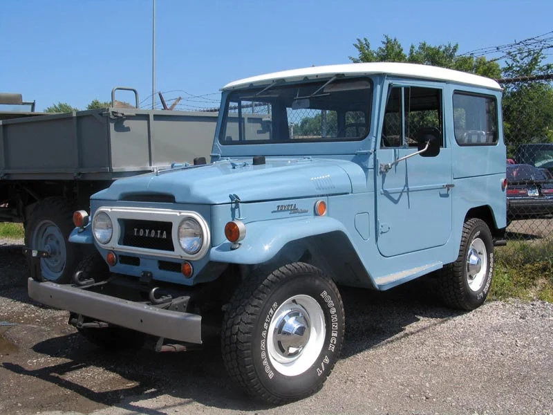

haha, i'll take a couple pics of it in its "true form"...but it'll be goin back to the original color of my old cruiser that got stolen, i think it's called horizontal blue or something like that?
(not my old cruiser, just one that's the same color, ha ha)

Thats a nice pic of the color blue mine should be also! Currently its a darker blue.
