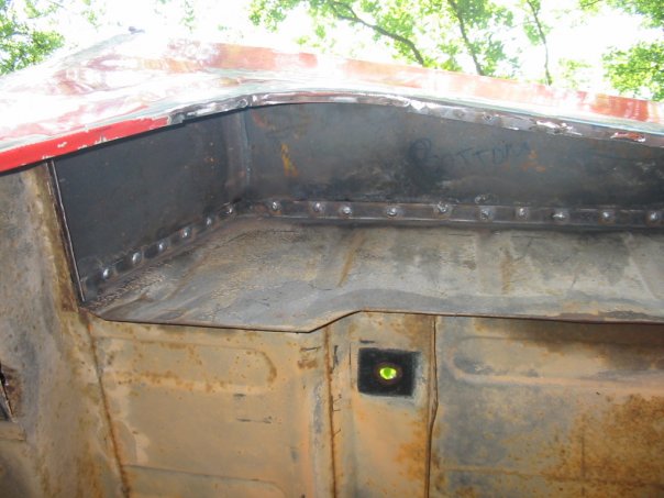

got some more work done this morning, so i figured i'd post it up while i'm eatin lunch
started the comp cut on the fender:
i decided to use the old lip of the fender to keep the flow of the original lines and also let me keep a clean lip on the fenders so i don't chotch up my tires if they rub.
for the straight parts of the fender i just cut an 3/4" overhang, drilled out holes for spot welds, then beat it flush with the bottom of the wheelwell, and then welded it up.
here are some finished shots of the cut and lip
a couple good shots of the lip and of the spot welds
here's a side shot of the finished product:

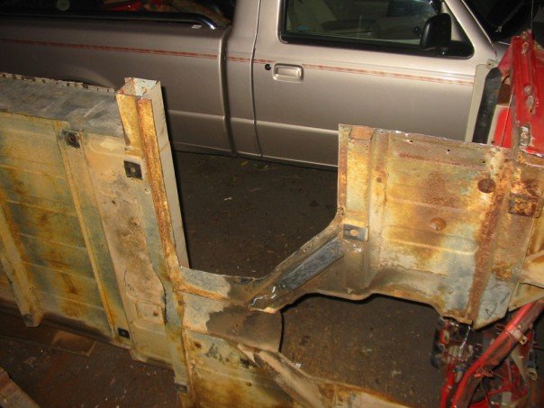

got the passenger side all cut off. hopefully i can get the passenger side done a bit more efficiently since i know what all the tricky parts of the process will be.
here's the passenger rocker and quarter
what's left of the tub after i cut out the rocker, quarter, wheelwell, and tank depression:
i cut out the tank depression for a guy here on the board for some rust repair...i had to get rid of it anyway b/c when i pull the door frame in at the b-pillar on this side i need a flat floorboard to attach the inside rocker to...
