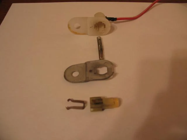

I installed George's LED's some time ago and was dissapointed in the fact that neither of my rear door switches worked thus not allowing the light to come on. I decided to get some used ones from a salvage yard and just my luck after replacing both of them one still did not work. So since I had some back up switches I decided to disassemble one of them and try to fix it. Turns out this is a very easy fix.
The pic below is an "exploded" view of the switch. First remove the bolt that attaches to the door jamb. Unplug the wire. Remove the rubber boot, my boots did not tear but I can see where they might if the rubber is brittle. You will notice that the white plastic housing has some plastic "rivets". These will have to be drilled out to get you to the point of my pic. Once I had the switch apart I noticed that everything metal in the switch was corroded. I have a bench top sandblaster so I just put every metal part from the switch in there, but some time spent with some sandpaper will do. Then just put everything back together.
You could go through the trouble of "soldering" some plastic back in the rivet holes that were drilled out but the rubber boot and the bolt that holds the switch to the door jamb will keep everything together. I have not had any problems since.

Brad, thanks for the inspriation. I've been meaning to do something about this for a few years. It worked like a charm, except I wasn't sure how to disconnect the red wire. I just left it attached and worked with it pulled out a couple of inches. On the second switch, I took care to drill off only the heads on the plastic rivets, leaving the little posts to keep things closely aligned during reassembly.

I just did this on two of my doors, but instead of drilling the plastic rivets I just took some wire cutters and essentially put an "X" on the face of each rivet. This allowed me to get them off, but they still "snapped" back together after I'd filed the contacts.

I just tried this and it worked fairly well, despite my having cracked the plastic. Hopefully it will stay working for a while, since the wife has put the foot down on further work for a while. However, I too couldn't get the red wire to release. Also, on the PS rear, the release bolt just kept spinning. I suspect the nut in the rear isn't secure anymore. Any ideas on how to access that?
To fix mine I gor really luck. I sprayed some wd-40 or Kriol in mine, wiggled it around a little and it hase been working for over a year. I'm sure now that I wrote this it will stop working and I'll have tobuy replacements.
