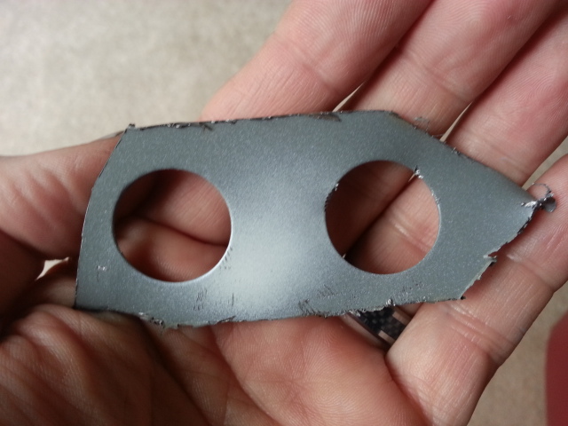

An interior web section that already had a couple of holes in it. The alternative was total destruction of some other valuable interior or exterior part(s). Yeah, pretty trivial.

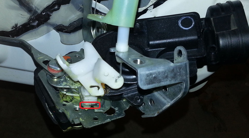

Thanks for reminding me. I have a shot of it incorrectly assembled. The circled white plastic piece is the offending part. It's sitting on top of a metal arm. The plastic piece has a slot through its center and it should be inserted onto the metal arm that's circled in the second pic. Finally, the plastic piece has a top and bottom. The square plastic post is on the bottom as shown in the picture. The round plastic post is on the top as shown in the picture. Sorry, I don't have a final "correctly assembled" picture.

Since I was in a door the other day, I took some photos to show how this piece should look so no one else has to cut their door apart.
