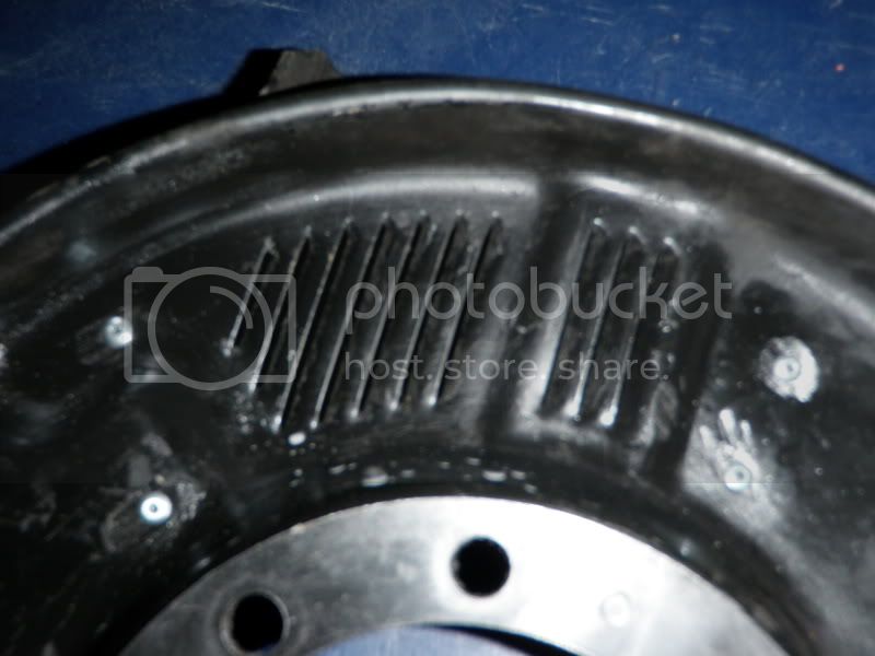

And yes, that is a dust shield. Only FJ62's got them; gives us superior braking :rolleyes:

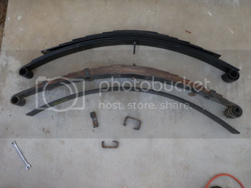

Those springs need to be broken in. Flex it out so the driver front spring is flat, leave sitting there overnight. Next day flex it out so the passenger front spring is flat, leave sitting overnight. It'll flex much better after that.
That said, I took out my long AALs up front to gain more flex and lower the truck a bit. Now while sitting, my springs are a hair over flat. I like it.
I'm using stock springs in the front and they are a good height. The rears have the AAL's. Good idea on the flex overnight thought. I'll have to try that.

SnT shake down run went well. Broke my upper driver’s side ford shock mount. The reason it broke is because I put a horrible weld on it. Was able to find a ready welder and put it back on with no trouble. I bent my passenger side front leaf spring. I assume this happened when I would hill climb and nail the bottom of the dune too hard if it wasn’t a smooth transition. The rear spring packs with long MAF AAL’s sit too high although it did settle slightly so I won’t touch those for awhile and see if those break in. Driving without sway bars on the road is interesting and different. I will definitely want to put those on for road driving. I installed and wheeled with the stock front driveshaft. I had no issues with it falling out or being too short. I don’t see an excess of splines sticking out when it sits so I’m going to stick with it as is for now. Articulation was minimal and I was not impressed. I will have to tune the suspension somehow to get more droop so that this will actually work in the rocks and not be a tippy pain in the butt.
New list of things to do:
Extend sway bar links
Beef up front leaf spring packs with long AAL’s or long leafs from spare stock packs.
