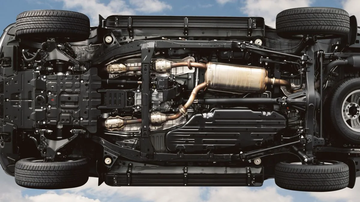

Was laying today under my new LC200 (US purchased) to have a look at the KDSS components, (limited) factory skid plates (engine, AT, fuel tank) and the rest of the frame/items. It looks pretty much per the picture I found online a couple months ago, maybe even on this forum.
One thing I did not expect per a thread on towing travel trailers, Automatic Transmission temperatures, OBD2 monitoring of the same and driving one or two gears lower, was what looked like two oil lines from the AT running to the front. I could not easily trace them all the way to the front and spot the oil cooler itself, nor took time yet to identify peeking through the grill.

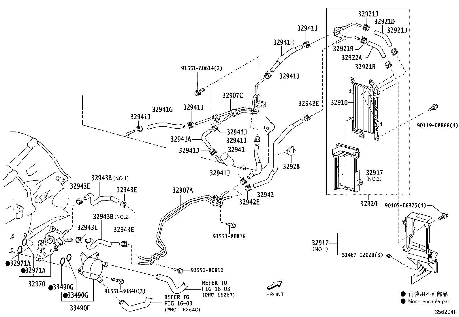

In any case; Does anybody know whether the 16+ LC200 sold in the US have an AT oil cooler? Is it per the parts drawing below? And the location of the cooler? Or is this only in certain countries and/or an off road or towing package option, which is not an option in the US as I understand.

While I haven't looked at a 21 yet, every US 200-series LC and LX I've ever seen has both the in-radiator cooler and an auxiliary cooler in front of the AC condenser on the passenger side with a large plastic duct controlling airflow through it. To my knowledge it isn't even an option, it is standard equipment.

Yes, but I’ll admit I started to take it for granted and may not have paid close attention to the later model 19 & 20/21 trucks. If the parts system shows it, it should be there.
And really, if you look through the grille it should be obvious, even without removing that panel.

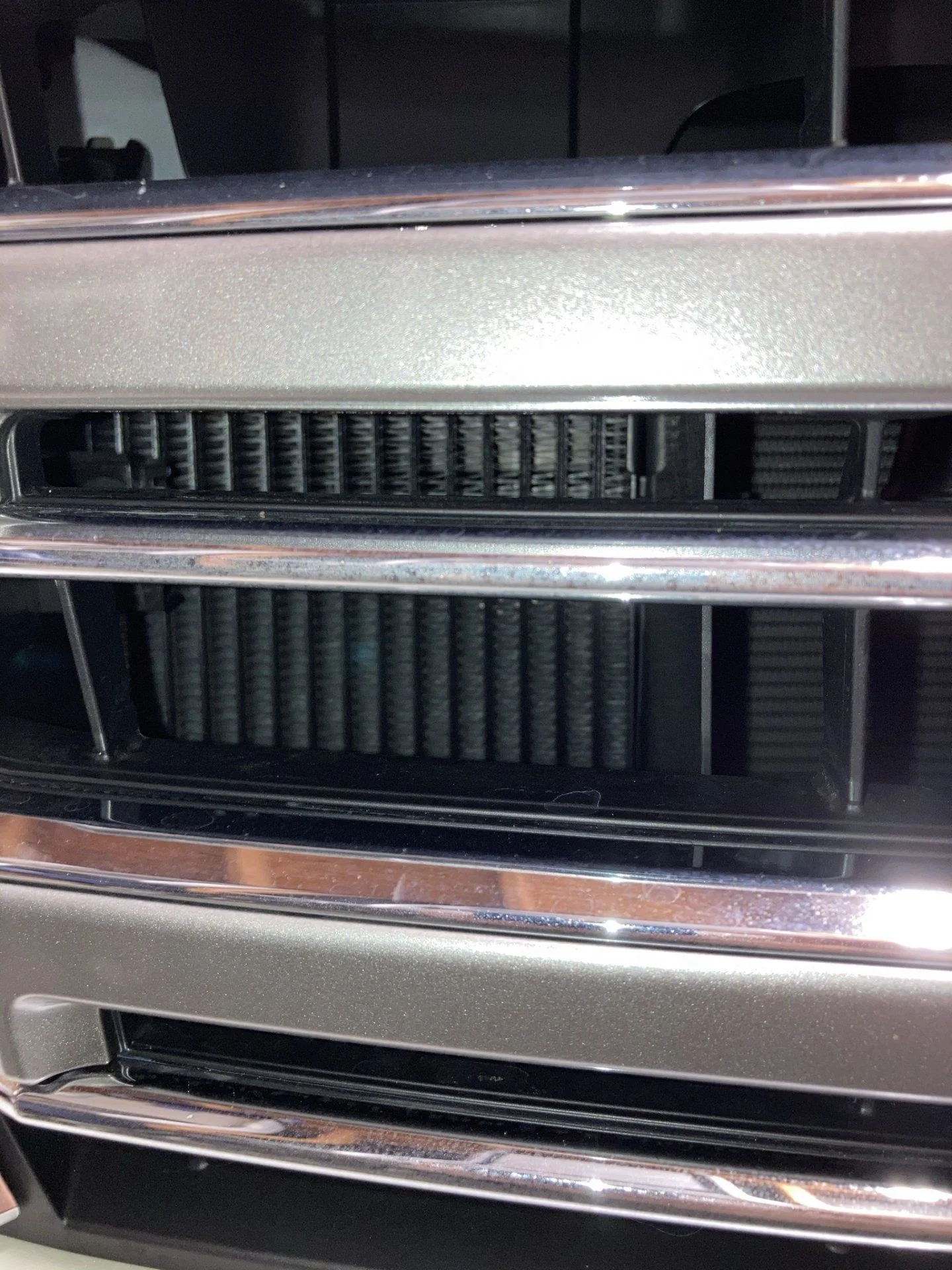

Just checked. As expected per comments above and seeing the lines from the gearbox yesterday, my 2021 LC200 has the AT oil cooler in front of the radiator & AC condensor passenger side with the plastic duct per bloc’s reply and parts drawing posted above. Happy to see they kept this setup and promising for any towing or long duration off road driving.
