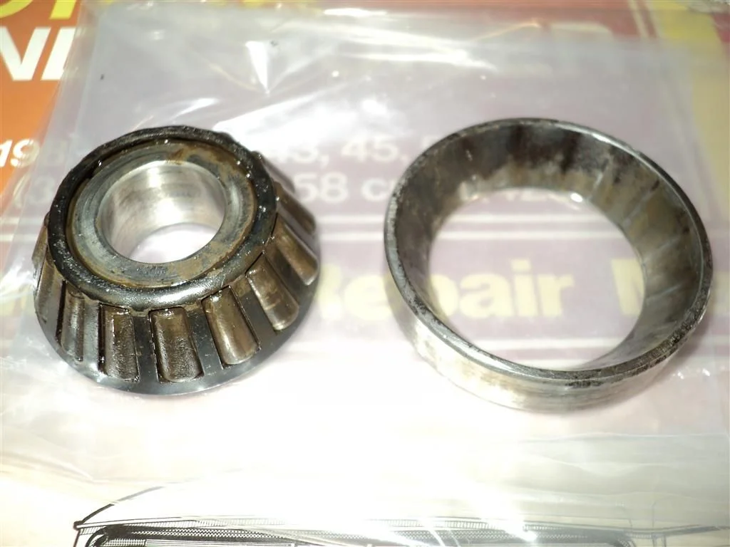

Anyway - inside the first knuckle, everything looks good except the upper knuckle bearing is shot. New bearings are on order. It seems like water got in there somehow...
It's just a messy project - not hard. I'm painting things up and reassembling now.

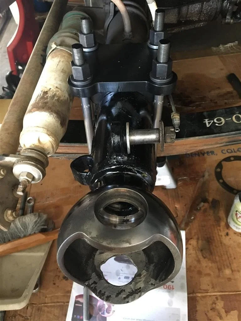

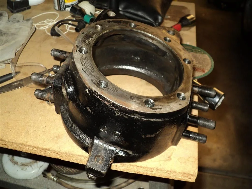

Here's a couple of pictures of things. The pictures didn't come out as well as I'd like (the knuckle really cleaned up well), but you can see how bad that upper knuckle bearing is.
Everything is cleaning up well, and all my parts have arrived... Just lots of "stuff" to clean up!
Rocky

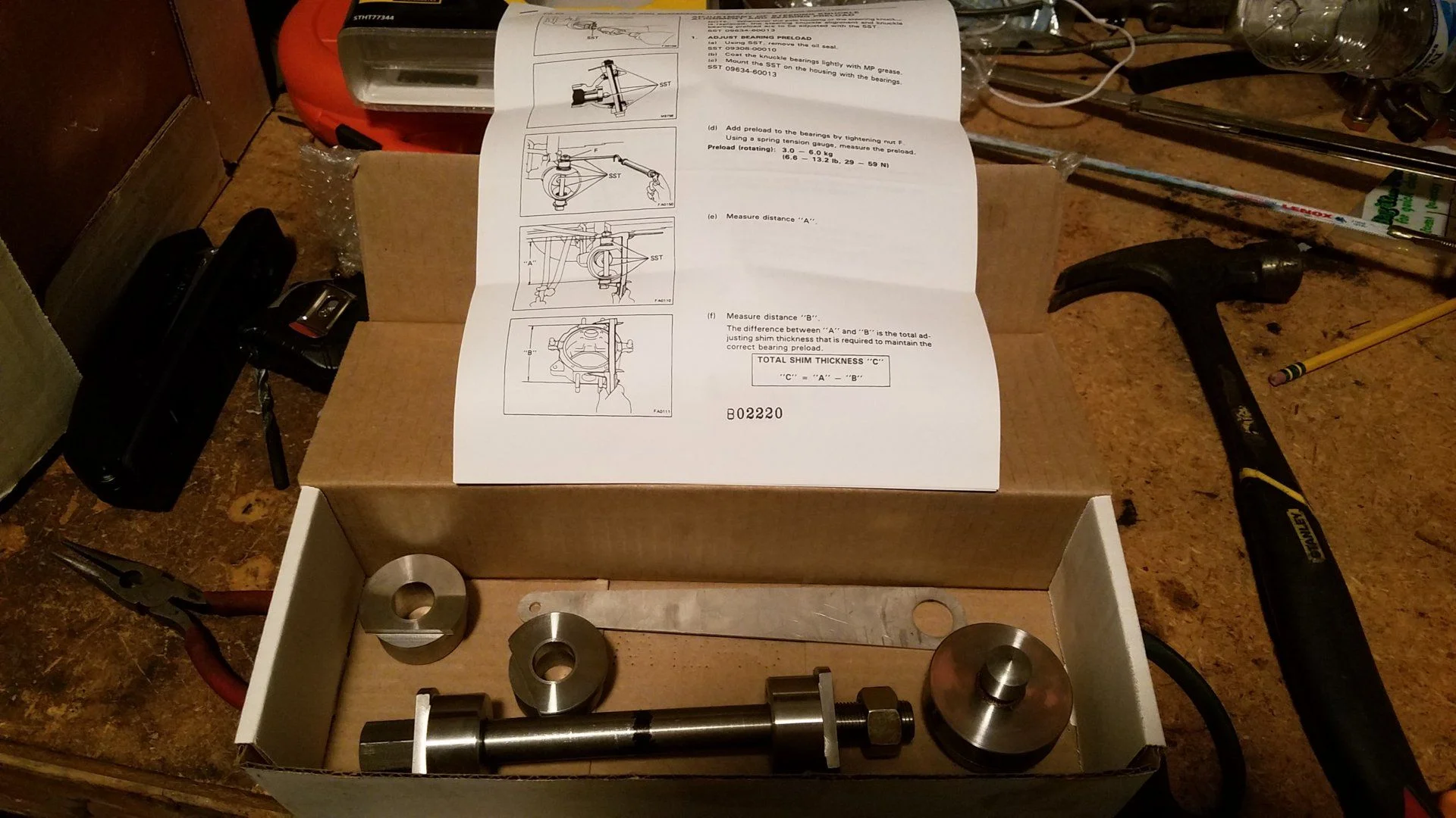

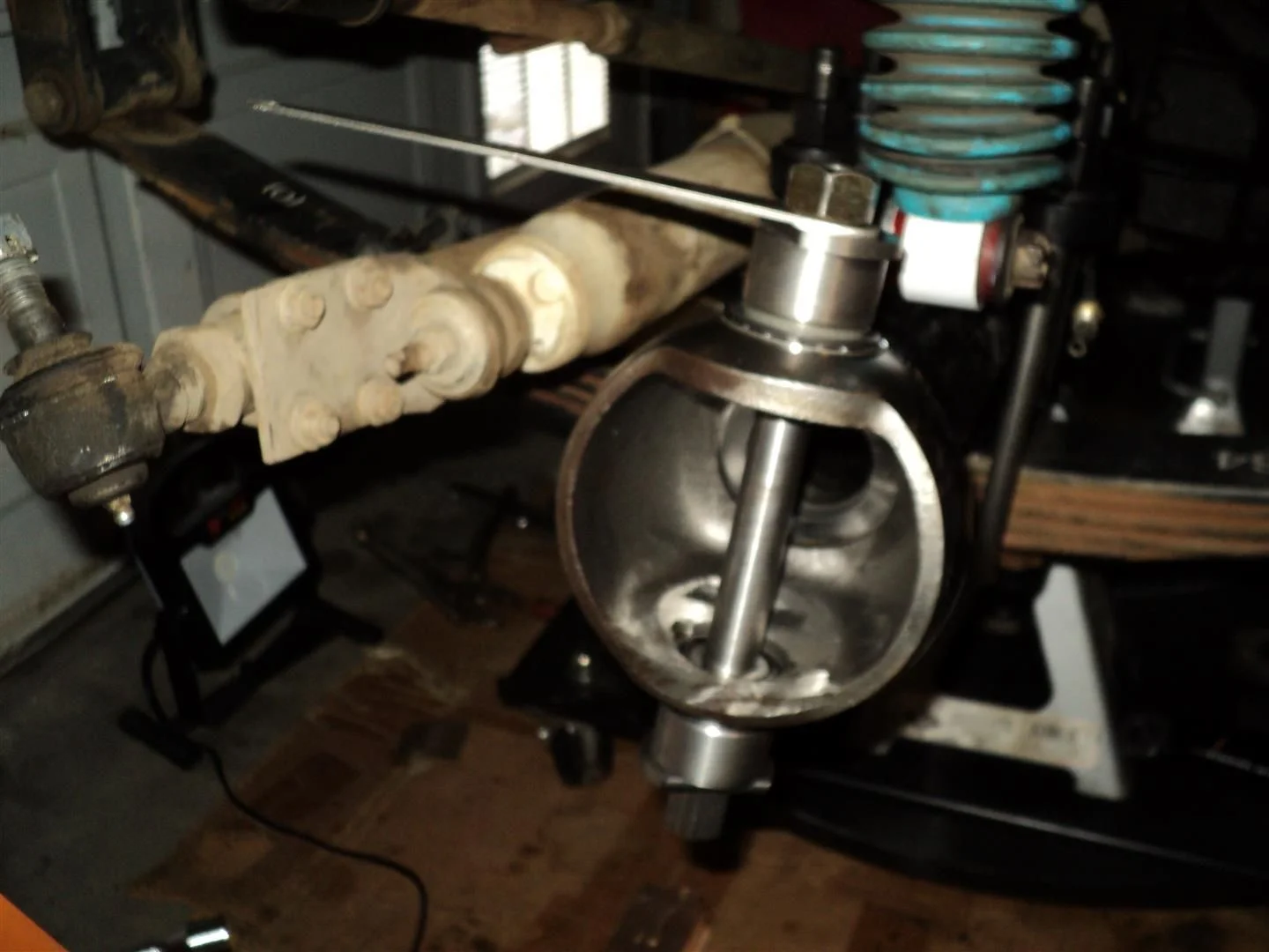

Happy to report that the axle centering tool that was sitting in a box on my work bench is being put to more good use in Tucson.
Thanks to medtro and others for making the connection.

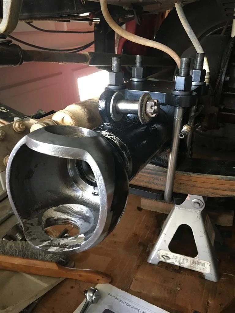

Got 'er dun! I'll be packing and shipping your stuff back in a few days. Thanks for helping me out. A couple of shots...
