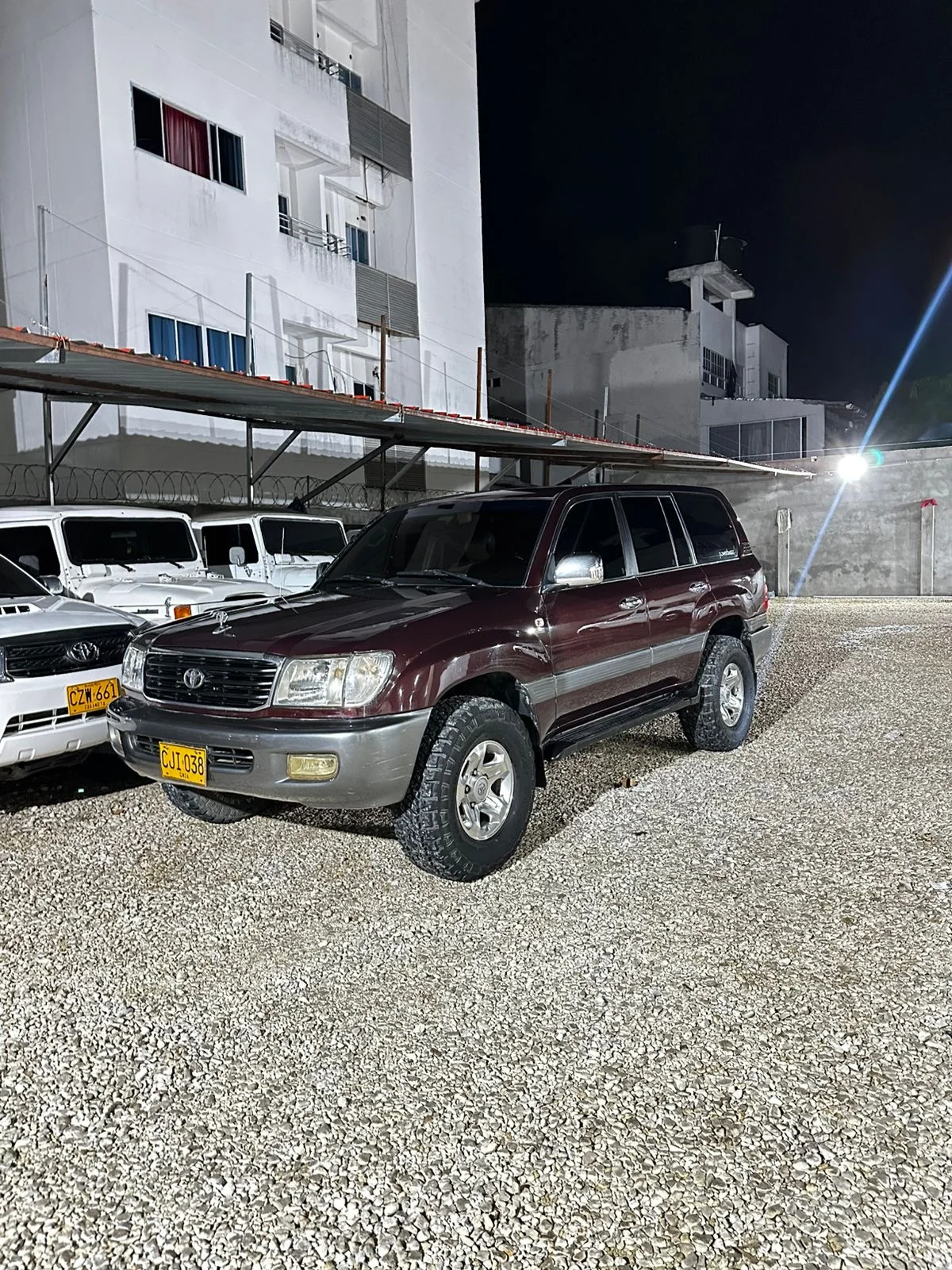

My LC100 is so hash from 30km/h. Maybe the cause is the torsion bar setting and old shocks. Now I´m considering about an IMS Dobinsons kit, or maybe get some caster correction bushings and a well torsion bar setting. (Mine has the 1HD-T)
What would be the best option, looking for comfort?
OEM shocks and maybe new sway bar links?
