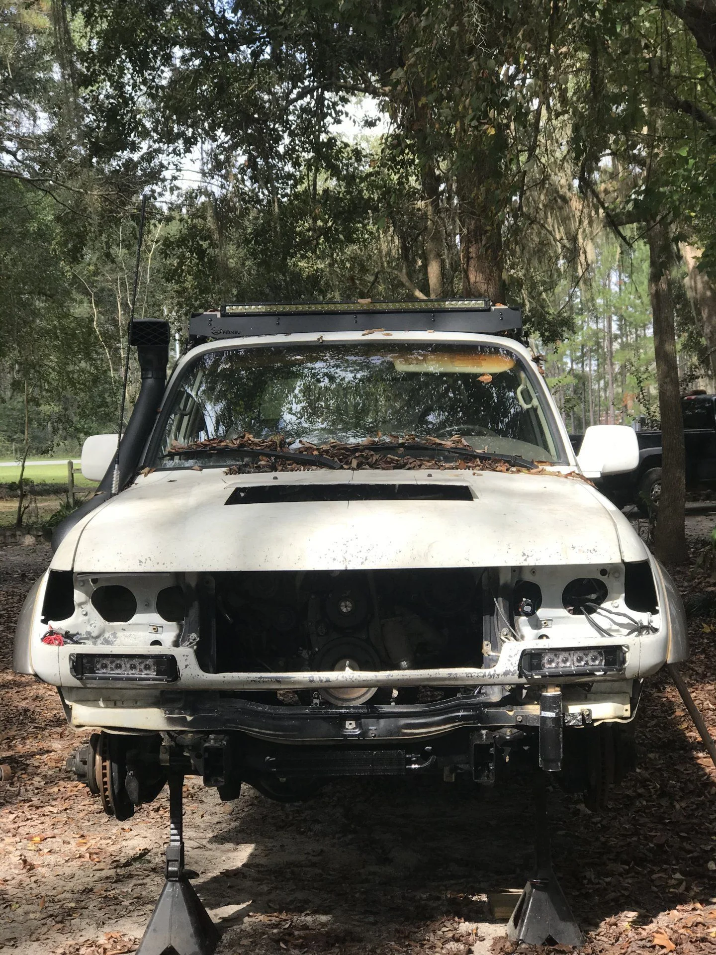

Actually it looks like it’s all going to fit. I have the engine push pretty far foward atm. I left adjustment in the mounts in case I need to come foward a inch or so.

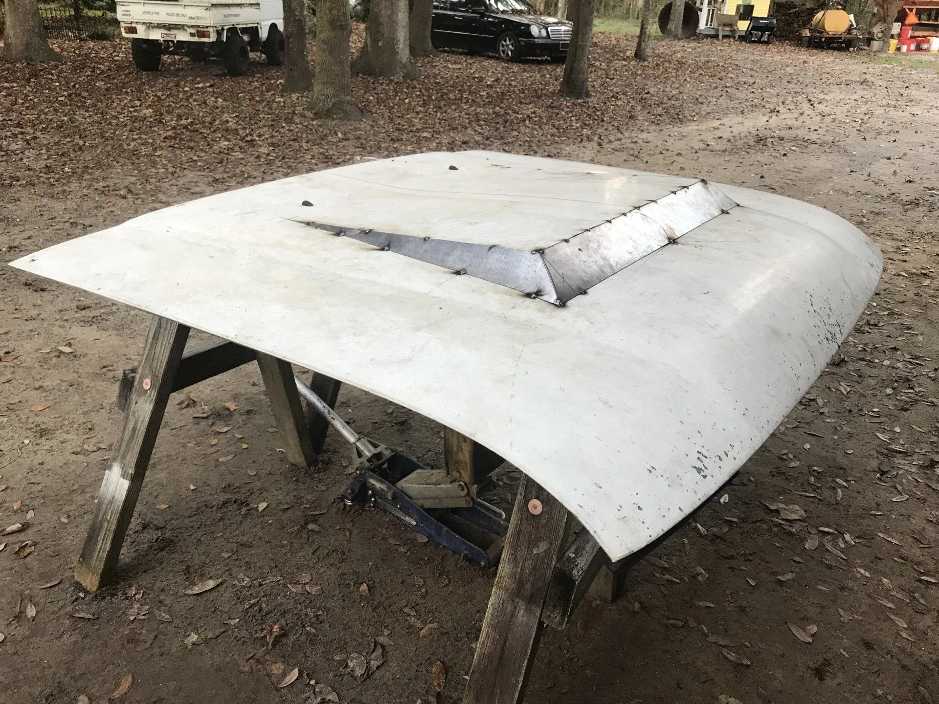

So quick update. I went ahead and cut the hood this morning. My paint ain’t great on the hood anyways so it didn’t bother me much. Now that its cut...I’m kinda excited! I really like the way it looks. Naturally I have to build patch panels for the side and front. I feel like the hood scoop kinda gives it that extra little bit I was looking for. The stock 80 series hood is huge and just looks kinda plain. I’m going to spice it up some! :)

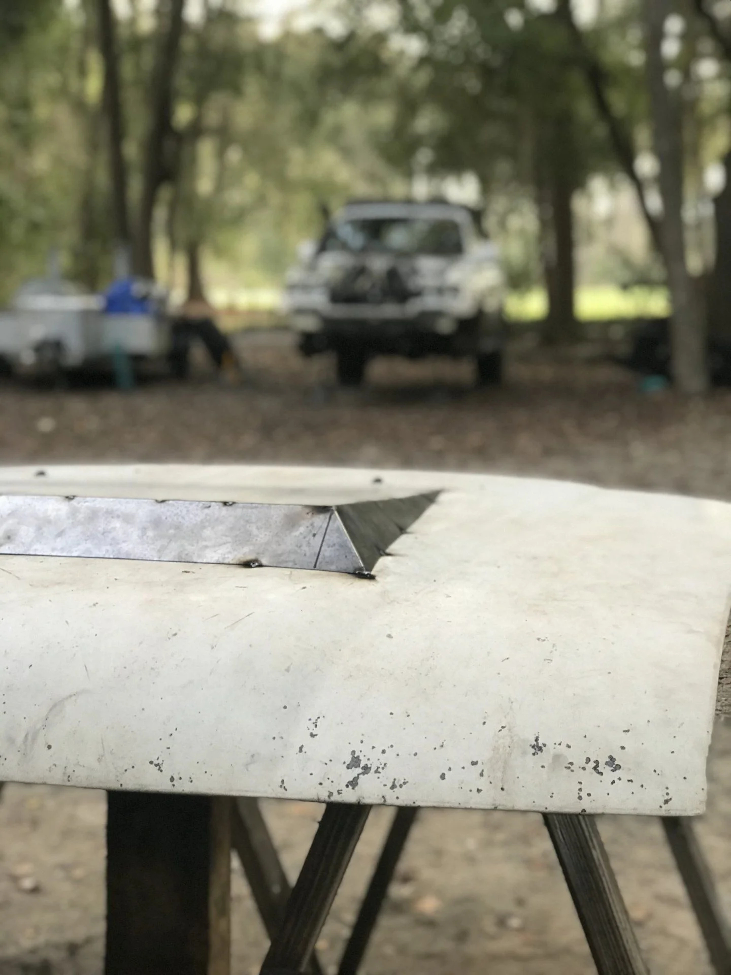

Update from today. Fabbed up a simple hood scoop. I know it’s not beautiful but it will get me on the road. Some may love it, some may hate it. Plan on finish welding it up tomorrow and maybe do some body work and paint.

Meh, hoods are overrated. Just drive the thing without the hood for a while - kinda of a nice contrast for a Lexus doncha think?
Shame you weren't able to take advantage of the negative pressure zone toward the rear of the hood and suck the hot air out of the engine bay.
Yeah hoods are overrated haha. I didn’t want to get too crazy with the hood design. If heat becomes an issue I can add some rear facing vents to pull that hot air out.
main concern for me was just getting the hood to close lol.

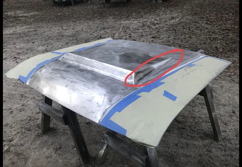

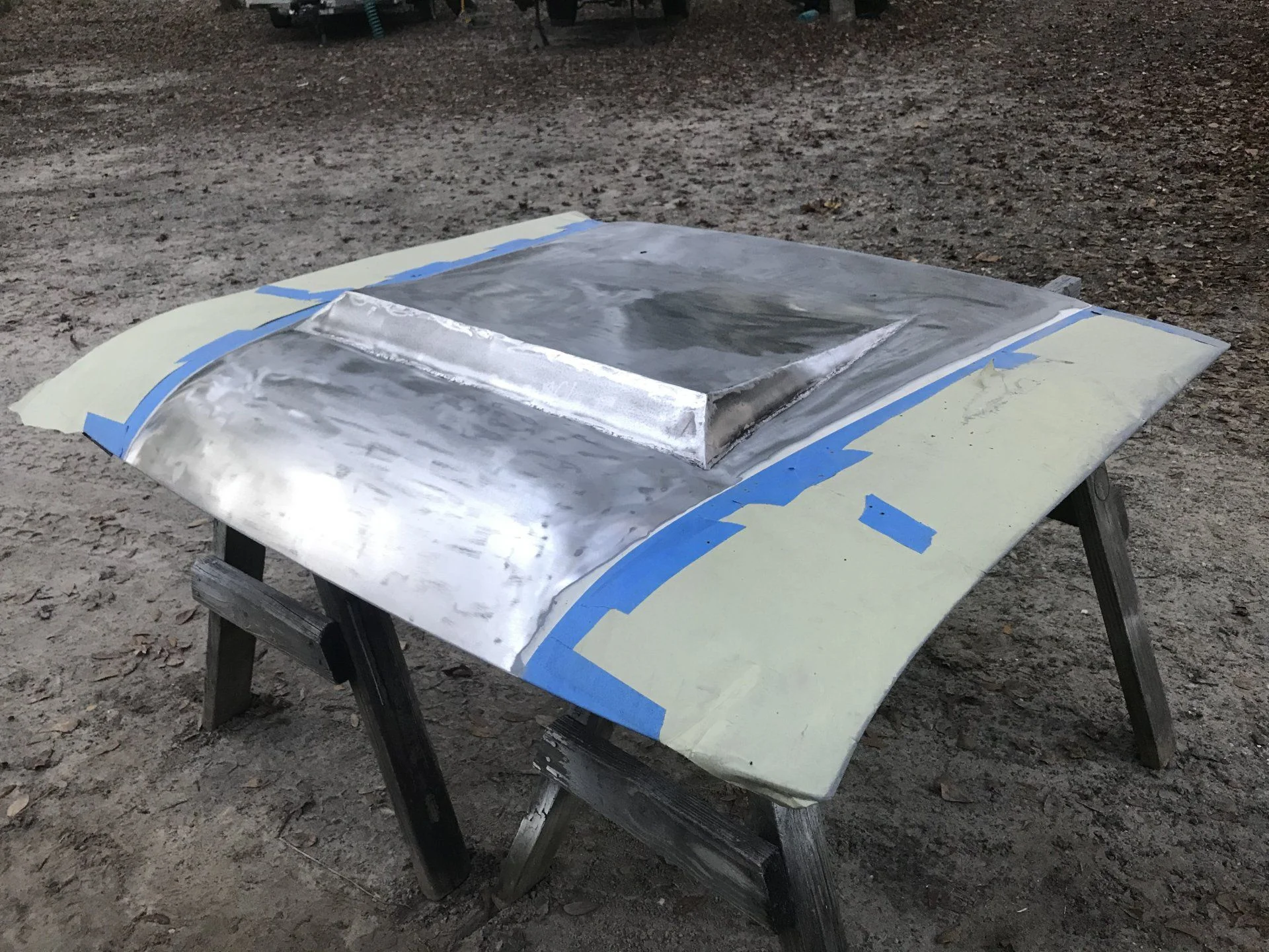

Another update...didn’t get much done today. Was able to get the hood scoop welded in completely and the paint removed. That paint is really on there!!
naturally welding this thin sheet metal..the hood warped a good bit, even with moving around. So looks like I’ll have a lot body filler and sanding ahead of me tomorrow haha!
