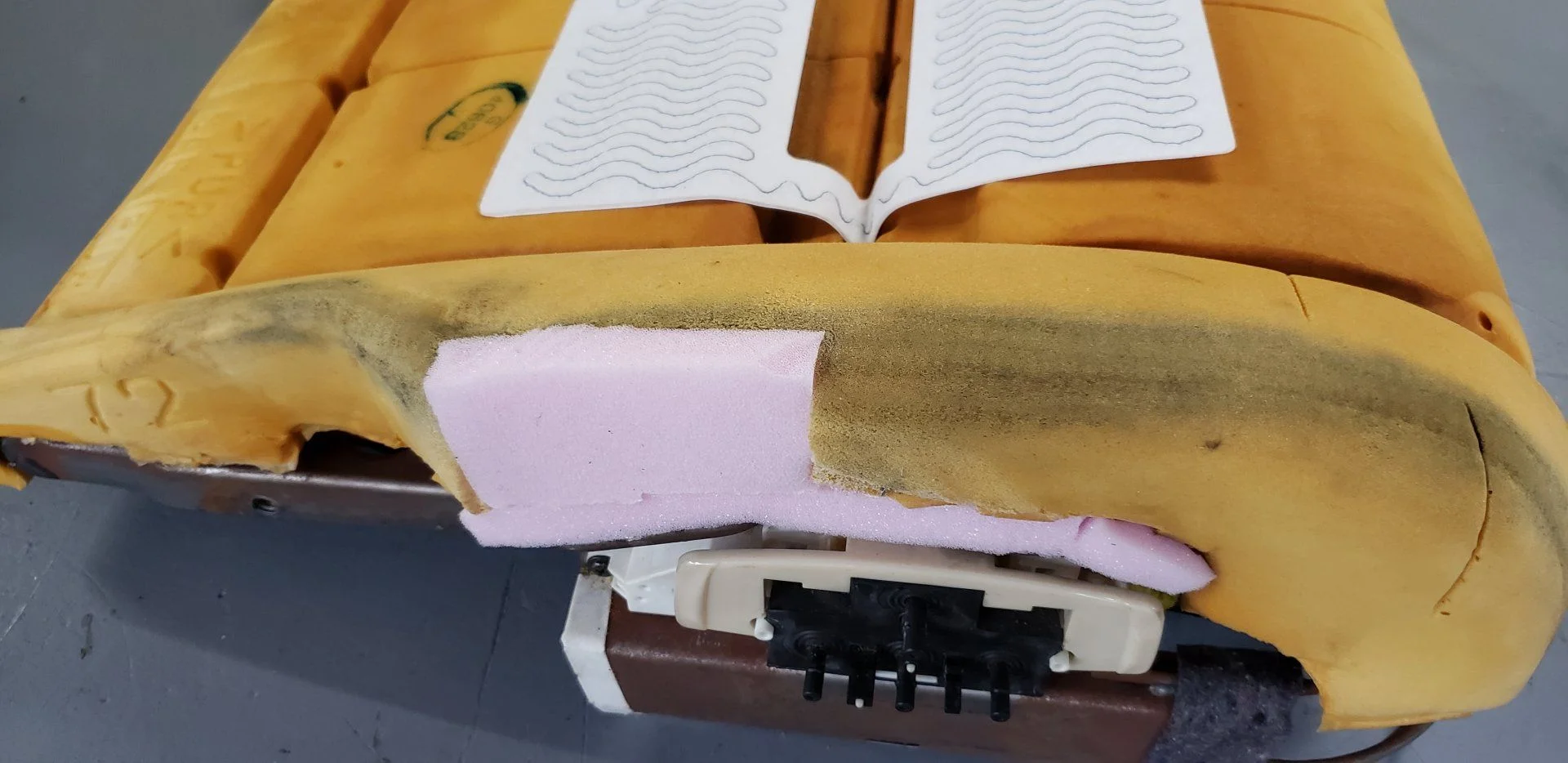

I just used a piece to repair the seat padding on the passenger side. Not even close to an expert repair but it did the job 😆.

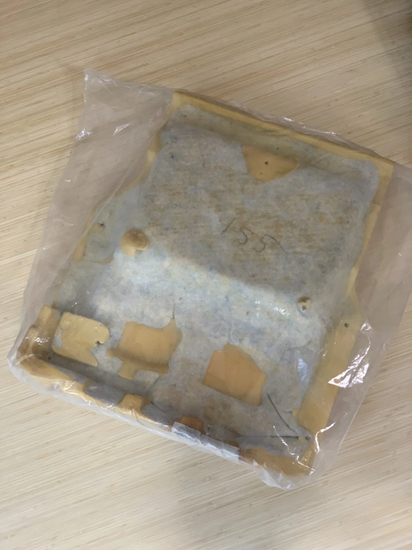

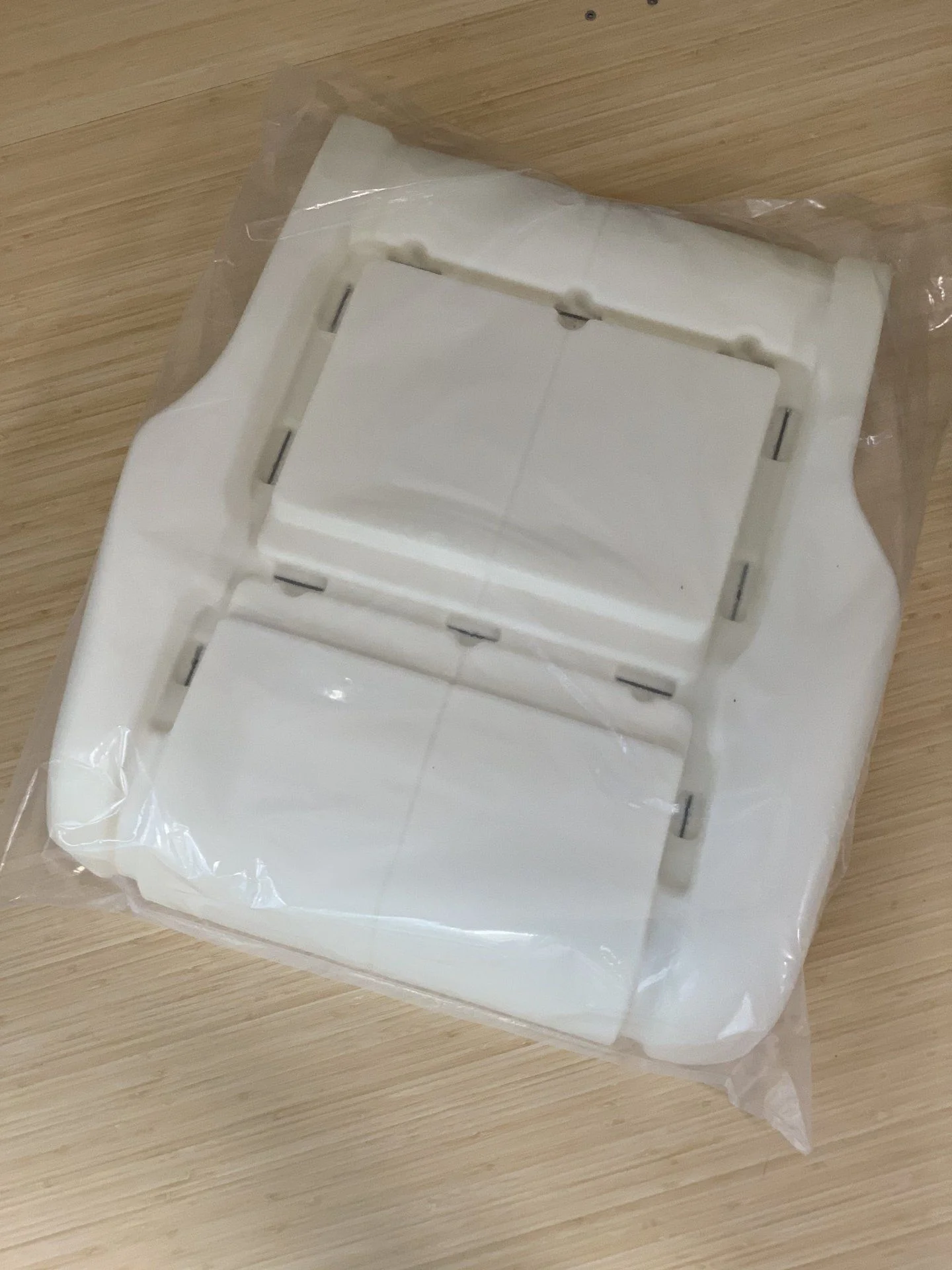

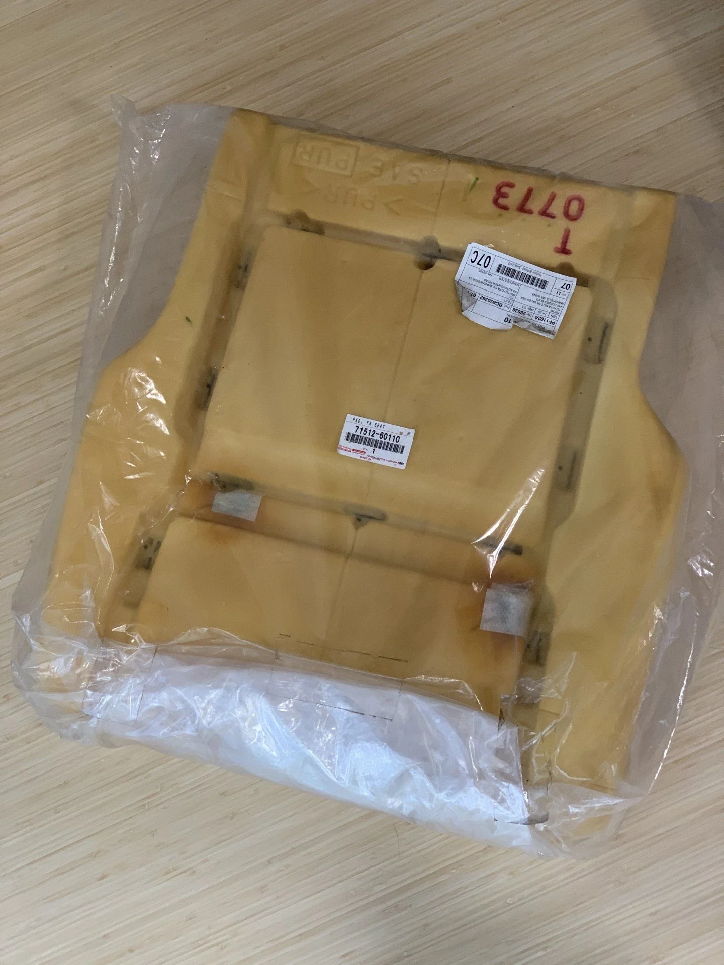

LCH is using more modern manufacturing and looks like a more precisely built product. The support on the bottom side feels more rigid, and I would assume, more durable over time. See attached pics.

Interesting..wonder if the LCH foam is equally durable.
did you put LCH foam bottoms in both your seats?
Is the LCH more firm? Thanks for the pics
Polyurethane foam durability is largely dependent on the density. The chemicals used to create the foam and more density are the primary cost driver. It’s why that cheap sofa or mattress failed so quickly. An easy way to gauge the durability of the aftermarket cushion would be to weigh it and compare versus oem.
