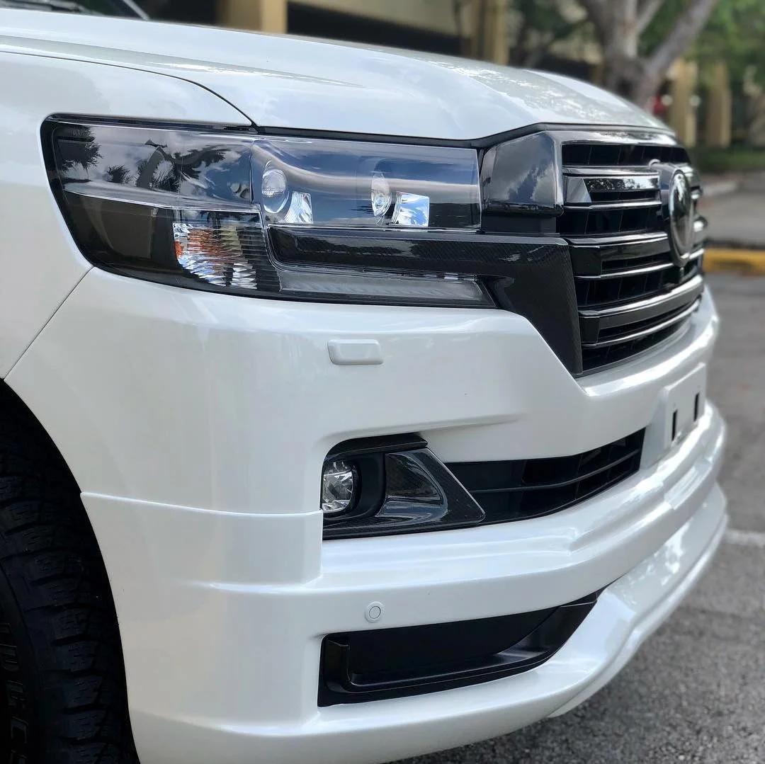

Anyone tried this?
I do like the less chrome look at the front.
Found a company Light werkz that does it for 500 bucks….

I haven't done this myself, but I've dealt with lightwerkz before and they're reputable. I did my own headlights as I was younger with a tight budget and occasionally experienced fogging. That said, I'd highly recommend sending them off to be professionally done. If you have an older year, consider a proper LED/HID dual projector retrofit while they have them.
A lightwerkz job posted here previously

I have one lightwerkz headlight and one heritage headlight (I crashed and broke the drivers side). The right side LW has functioned without incident since new 12/19.
