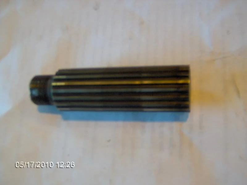

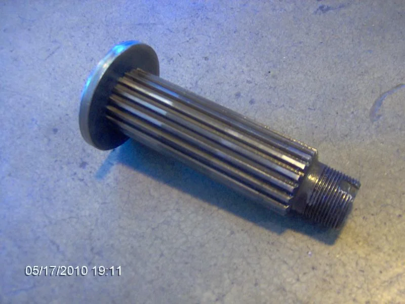

for starters, i decided to make a jig to be used to weld the DIY gear. i had an aA440f core sitting on the shelf. the 3rd and 4th gear clutches were wasted, but the output shaft was in amazingly good condition. so i grabbed the trusty dewalt grinder with a cut-off wheel and got busy. a couple of minutes later i had the beginnings of my jig in hand.
sorry about the crappy pics....
next i figured out how long my jig need to be, chucked the stug shaft up in the lathe and faced it off.

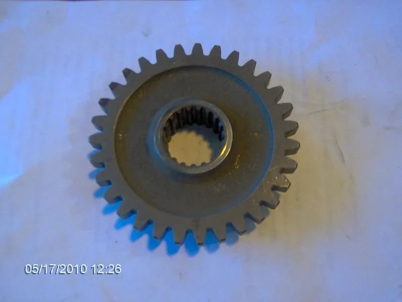

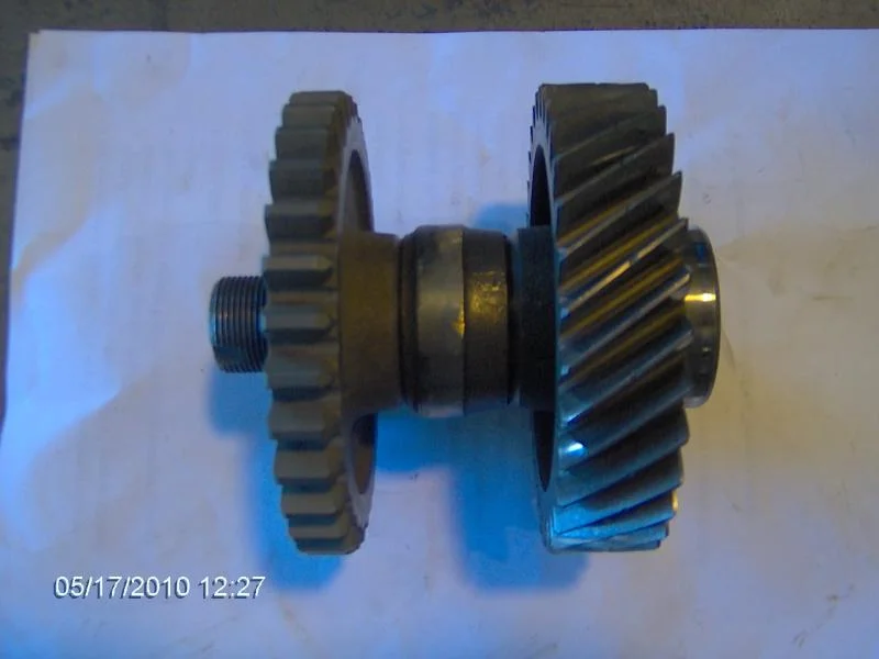

i had seen a few of the home-made McNamara style gears before and figured i'd take it one step further. instead of welding the input gear/spacer/pto gear together, i'd use another pto gear instead of the spacer and just use the splined hub portion of it to increase the spline length by another 40% ( roughly ). luckily i had a couple extra pto gears on hand so i did'nt have to buy anything.
pic of the stock pto gear.

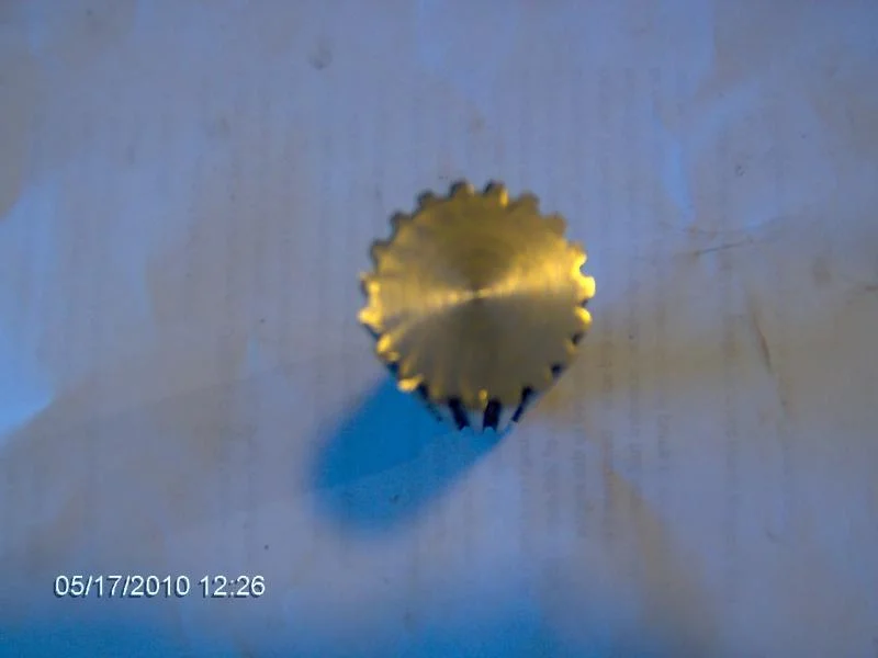

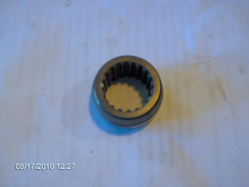

first we cut the gear up with the plasma cutter, then used a grinder to smooth out the cut surface as much as possible.

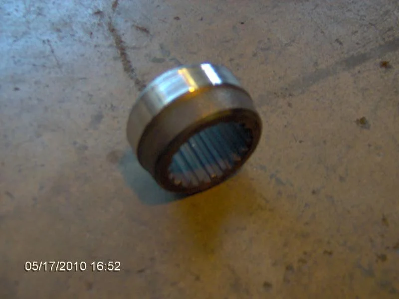

next i chucked the cut gear, now a splined hub, up in the lathe and cleaned it up. this is not essential for balance purposes ( as long as you get the outer diameter fairly consistent ) but it sure looks a lot better.

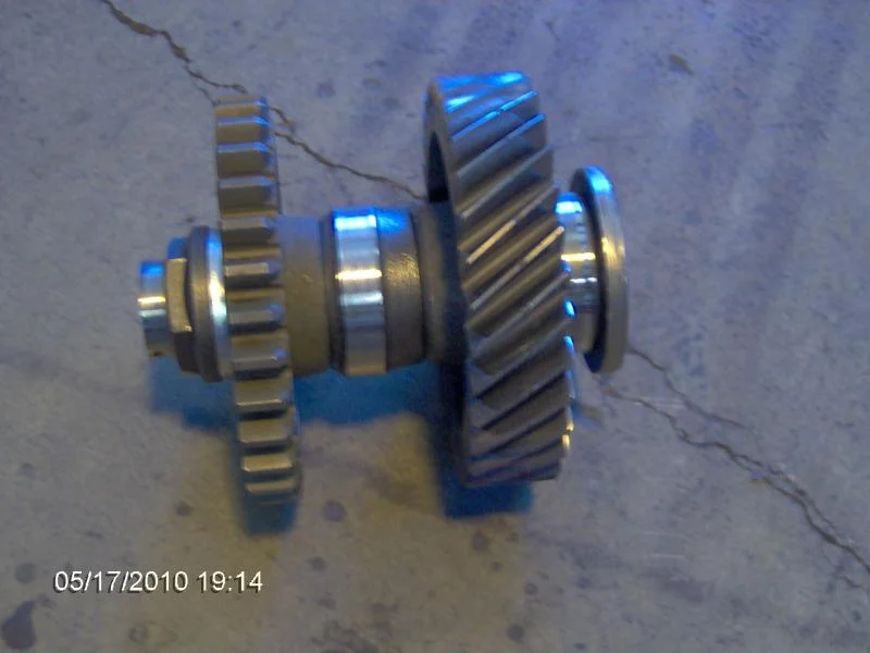

now it was time to slip all the parts in position and snug up the nut at the end of the stub shaft to get proper alignment. so far, so good.

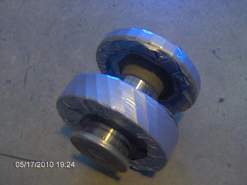

last but not least, don suggested we'd use duct-tape to mask off the gears. doing so would ensure no welding damage to the tooth and seal surfaces on the gears. sure, the tape would become a sticky mess once the heat of the welding process had it's way with it. but on the other hand, it would protect the essentials and clean-up would'nt be that difficult.
so after 5 minutes of "masking", the setup was ready to be welded. don took care of the honors, then he wrapped the entire assy in a pair of welding gloves followed by a welding blanket. we un-wrapped it an hour later to check it out. still way hot to the touch but looked great. so we wrapped it back up and let it sit. i'll get back to it tomorrow morning to finish the gear and have it ready for install. with any luck, the t-case should be done tomorrow.
