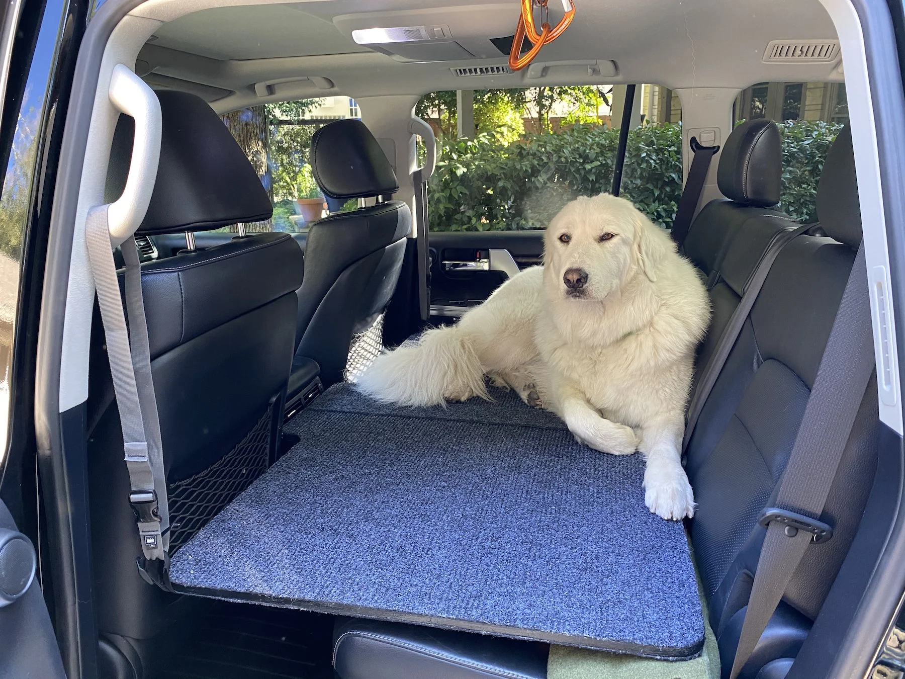

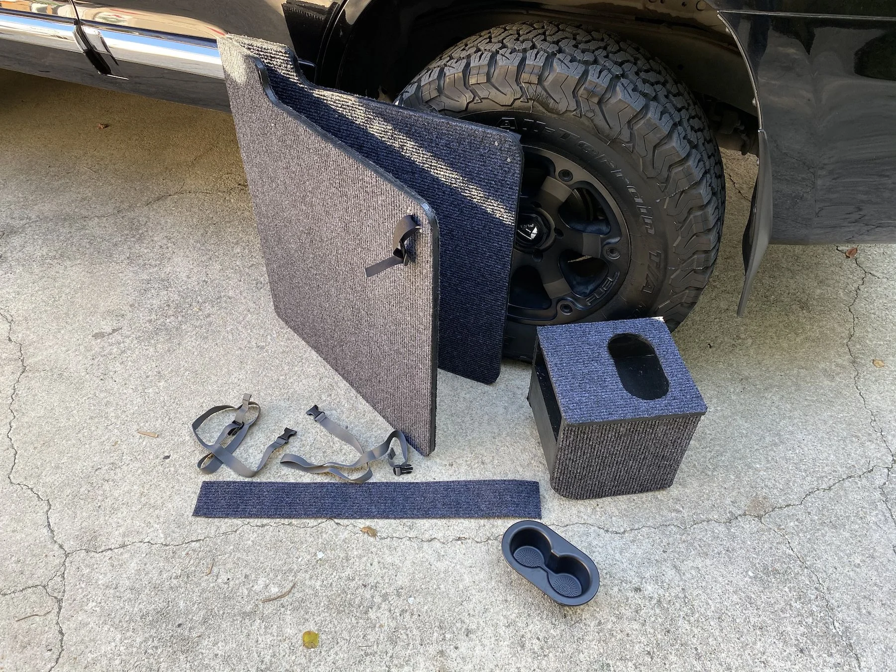

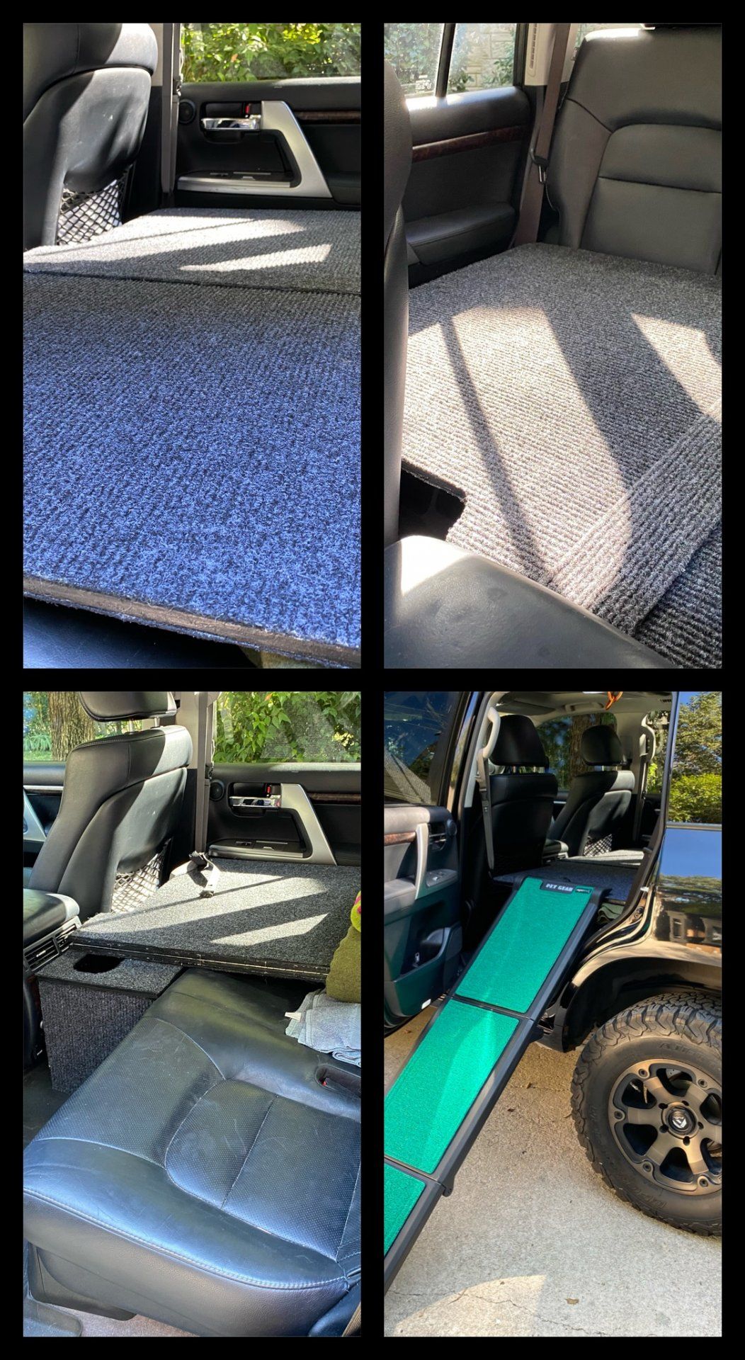

We recently adopted a Great Pyrenees who is a phenomenal dog and a great traveling companion. She goes everywhere with us, and with ski season here I’ve been looking for a commercially available back seat extender/platform so our huge dog could be more comfortable in the 2nd row. Unsatisfied with what’s available, I decided to tackle it myself.
I ended up fabricating a foldable, carpet covered platform that can be assembled quickly, stored easily, and folded over in case you need to transport a third passenger without fully removing the platform.
It’s constructed out of ½ inch plywood. A small center console supports the front of the platform and can be left in place when the platform is removed (always wanting for another cup holder anyway). The small console does cover the 2nd-row climate controls, but I have never used them. The lateral suspending straps add stability, especially for dog ingress and egress. They also prevent the need for lateral legs so you can take maximum advantage of behind-the-seat floor storage. The platform slightly overrides the bottom of the 2nd-row vents in the center console, but if you direct them upward, it looks like that won’t be much of an issue. To level-off the back of the platform, there is a large rolled-up towel in each seat, and one rolled up army blanket. Although it would seem like having the hinge of the platform on the bottom would be better for stability, it’s actually very stable with the hinge up, and it's much easier to install that way.
The dog has no problem leaping up onto the platform (these dogs are more athletic than they look), and she is able to make her way down (or I can lift her off). However, I purchased a ramp to prevent injury and for her long-term joint health. Right now, she’s sleeping on the platform and doesn’t want to get out of the truck!
It took me 2 min 41 sec to install.

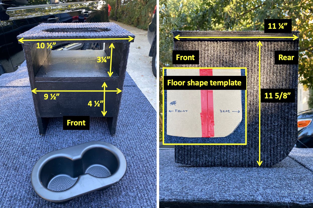

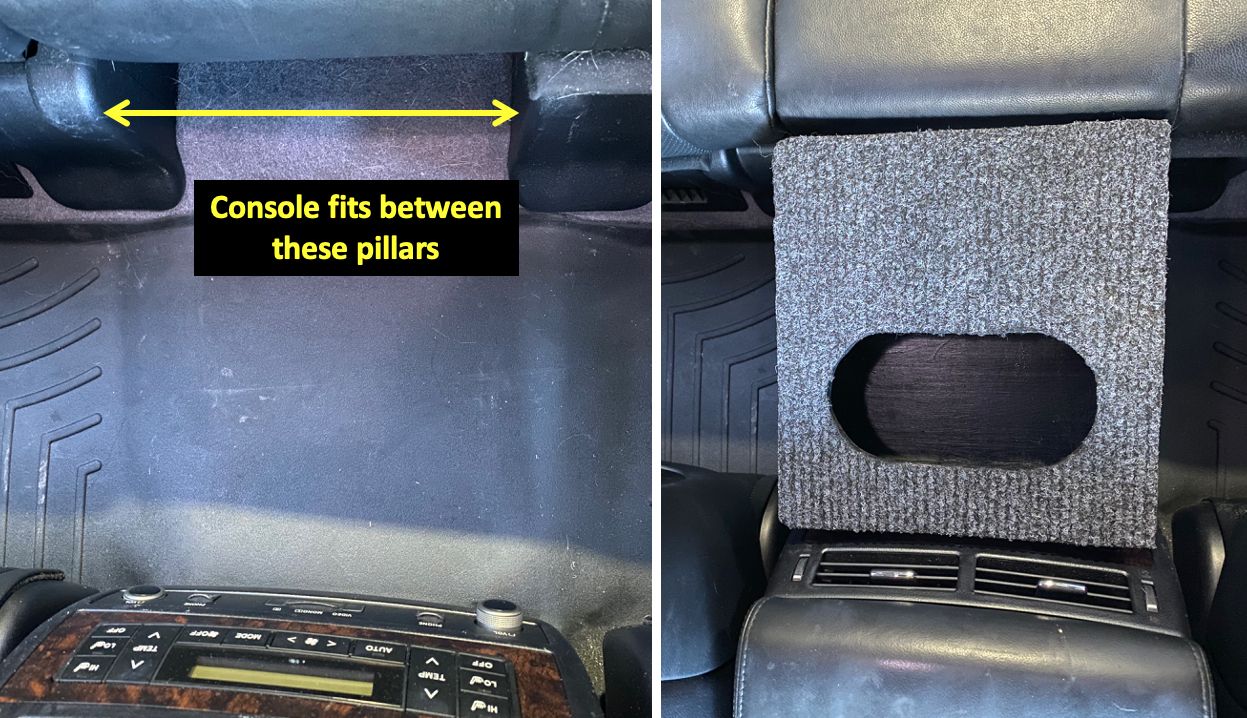

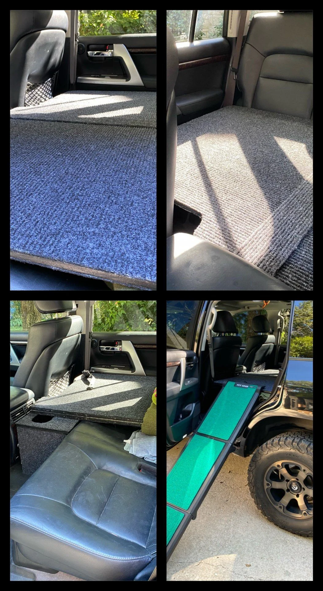

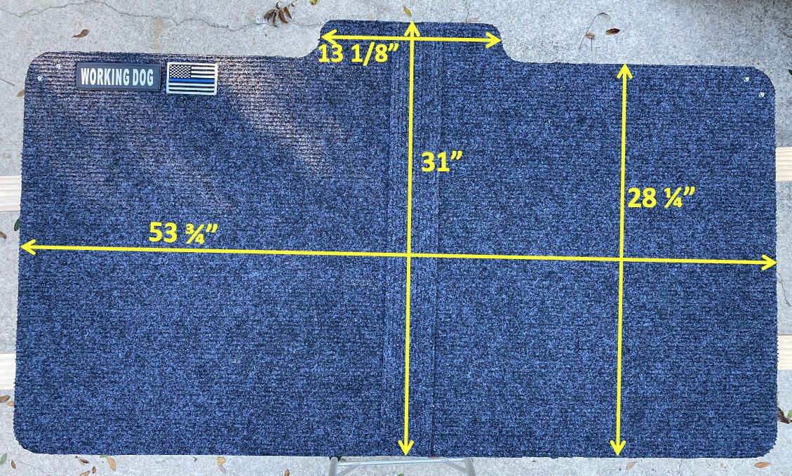

Per request, here are the dimensions.
Everything except the adjustable straps (REI) and the cupholder (Amazon) were purchased at Lowes.
Beware that my center console support box sits on a WeatherTech mat, so the box may have to be slightly taller if it isn't. In either case, you'll have to cut a template to get the center console support box to sit level on the floor. Note that the box nests between the seat bracket covers.
If you have any thoughts on making it better, let me know. Will be making another one for the other LC!
Remember to measure once, cut twice ;)
View attachment 2523871View attachment 2523872View attachment 2523873
THANK YOU! awesome details.

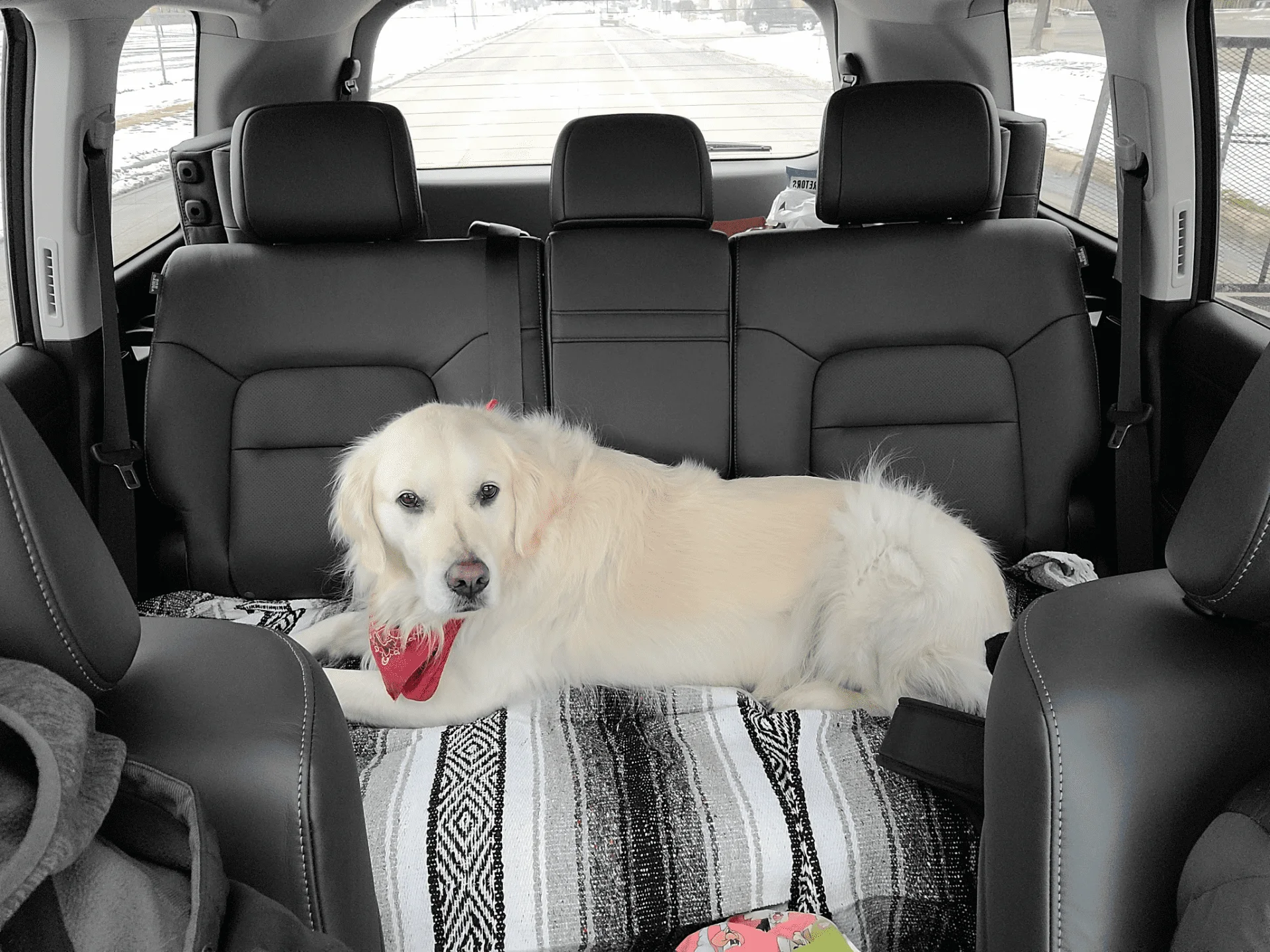

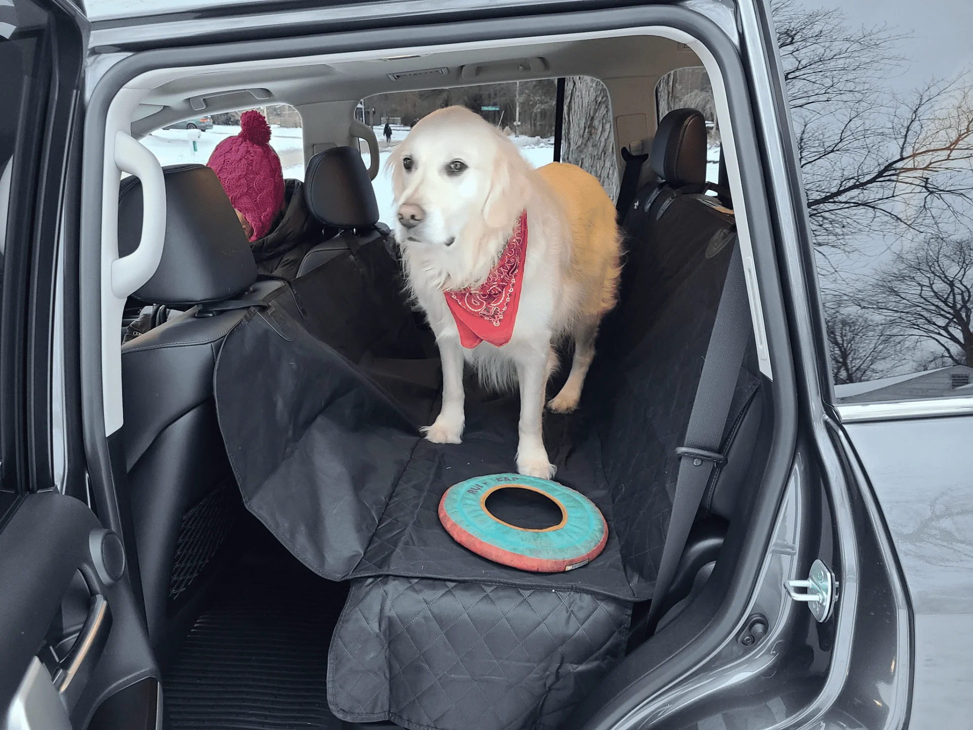

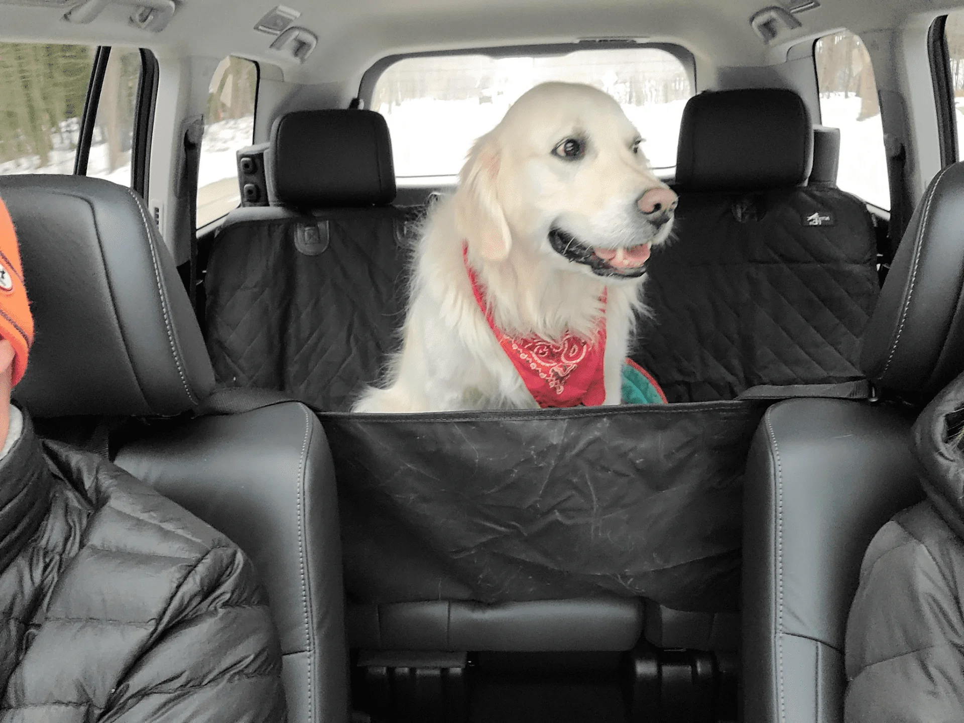

Trying different things...
It is a climb up for him, the 200 seems to have better access to and larger floor space for him to climb up to, without jumping all the way to the seat. The hammock unclips easily so he can use the floor space for getting in.
Right now I think hammock wins, with sheepskin for longer trips. Yesterday he decided to swim in Lake Michigan and roll in the sand on our walk, the hammock contained all the mess.

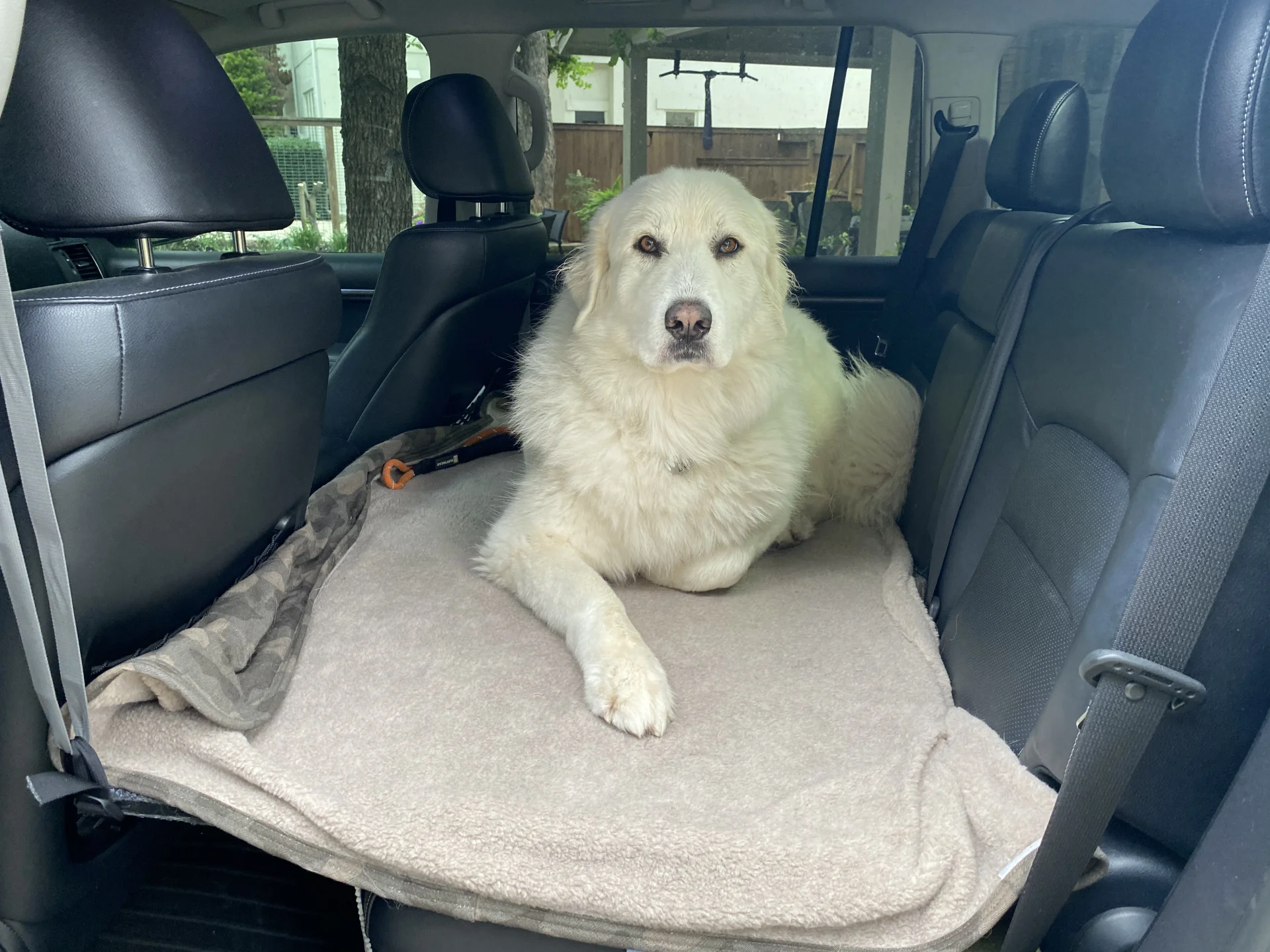

Follow-up report: After about 8K of travel miles with the dog, the platform has performed great. Totally worth the effort. I made one for each LC. It's also an excellent utility platform and provides a good cover to hide things behind the front seats. They stay in the trucks 100% of the time. The only challenge is getting the center console component in and out, as the console/rest is probably a little too big front to back. The Carhartt pet blanket fits well on the platform.
